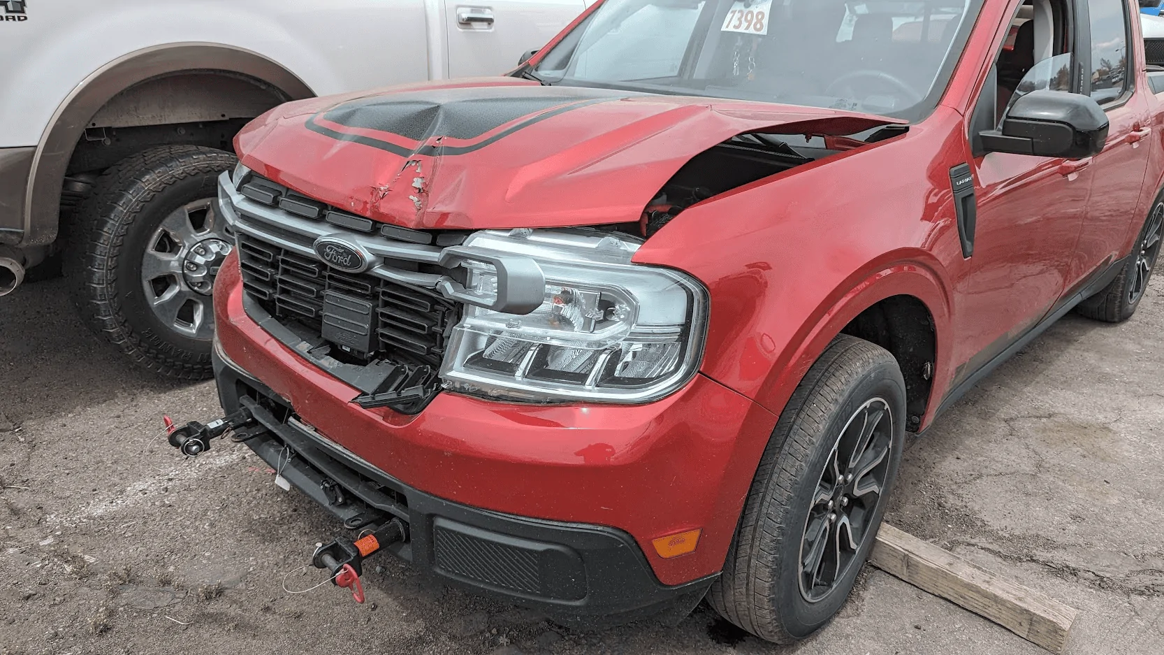

After adding brake issues to the mix, and drooping it off at yet another dealership, Larry was crashed by one of the techs.They think it might be totaled. We should know more in the first week of June. We are moving on to a 4x4 Ranger.
A FE too! I know accidents happen but I would be beyond enraged. The damage doesn't look all that bad so hopefully not totalled. Considering they should be footing the bills I'd insist on a full repir not matter what the insurance companies think.
Sorry, I am done with the Maverick.
The dealer is hoping that they don't total it. They are willing to give us 35k for it. And that's precisely what a new Ranger would cost us.
Plus! We are traveling and have to be in South Dacota for 4th of July. They will never have that repaired on time. New truck, done and over with it.
