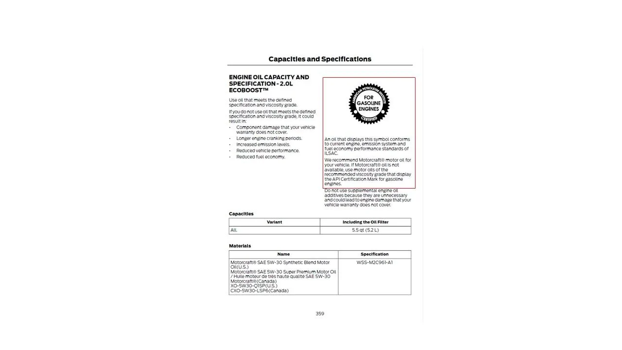

Just be careful with the oil you choose to use, Ford has specific oil spec requirements for the Ecoboost that many oils including Pennzoil Platinum, Ultra Platinum and standard Mobil 1 don't meet (yet). The oil spec they require is formulated to be less vulnerable to low speed preignition and to promote better wear of timing chain guides, both of which have been problems for ecoboost motors. Using non spec oil could present a problem in the event of a warranty claim.

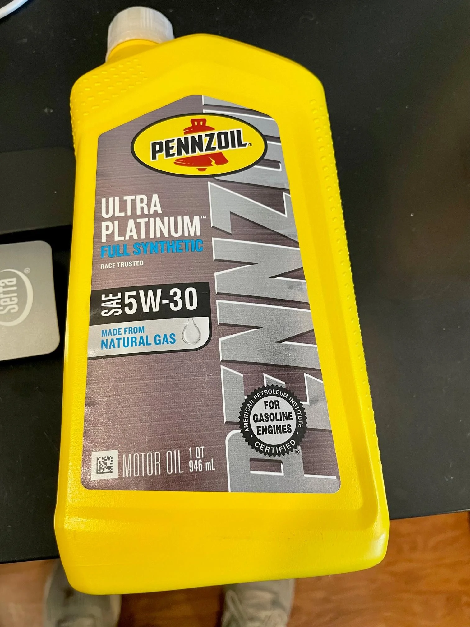

Maybe I'm missing something, the Pennzoil Ultra Platinum 5W-30 oil says it meets or exceeds the requirements of ILSAC GF-6A, API SP and all previous categories and has the API Certified label which appears to meet the owners manual and appears to me to meet/exceed the FORD WSS-M2C961-A1 specification of GF-6. What oil do you recommend using?

Maybe I'm missing something, the Pennzoil Ultra Platinum 5W-30 oil ....FORD WSS-M2C961-A1 What oil do you recommend using?
I agree it is strange the Ultra Platinum doesn't have the latest WSS spec printed in . Being an SP oil means it has the latest Timing Chain Wear Tests & also is LSPI-resistant (low calcium recipe), all good. Practically, Ultra Platinum is good for your engine.
Warranty Legal? No. If that ever is something Ford pursues in a warranty claim.
I recommend an oil that does have the RIGHT WSS spec printed on the label, at Walmart or wherever you get your oil. That is Pennzoil Platinum (not Ultra, the Platinum one), Mobil 1, Castrol syns, Valvoline syns, etc., whatever you read off the back label, finding OUR CORRECT WSS spec is the right choice, any brand.
Pennzoil Platinum 5w30 does have the latest WSS spec we need, just not the Ultra Platinum, oddly.
I have a theory as to why the Ultra does not have it, while the Platinum does: Pennzoil Platinum is also dexos1 Gen3. Could be, hidden somewhere in the list of things the FORD WSS-M2C961-A1 spec requires, is a need to be dexos1 Gen3. Controversial theory, yes, but every oil I see that is dexos1 Gen3 also gets the latest, correct-for-us, WSS spec !

looking directly at their data sheet off of their website for Pennzoil Platinum 5W-30 and it does not specify that it meets the A1 standard, just A.
Also, I hate oil discussions because they always turn into a pissing match but I'm personally not willing to risk tensioner guide failure or carbon buildup issues being denied a warranty repair. I used Pennzoil Ultra Platinum religiously in my Focus ST and Escape 2.0 and had amazing results and reliability but I've since moved to Castrol Edge since it does meet the new A1 spec.
