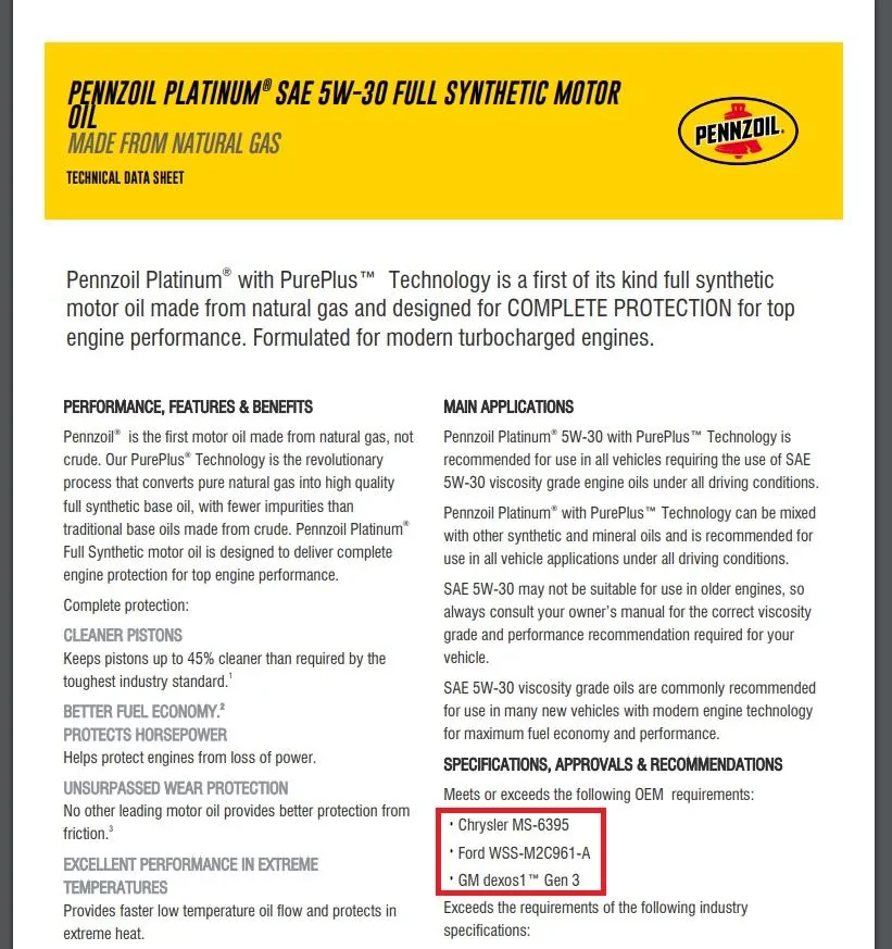

looking directly at their data sheet off of their website for Pennzoil Platinum 5W-30 and it does not specify that it meets the A1 standard, just A.
Also, I hate oil discussions because they always turn into a pissing match but I'm personally not willing to risk tensioner guide failure or carbon buildup issues being denied a warranty repair. I used Pennzoil Ultra Platinum religiously in my Focus ST and Escape 2.0 and had amazing results and reliability but I've since moved to Castrol Edge since it does meet the new A1 spec.
I'd assumed the missing "1" on the end of the WSS spec was a typo on the data sheet. Those do happen. You might be right though. One needs to check the back of the Platinum bottle before buying it.
Anyway, just use Motorcraft, that's always warranty-safe, as the easy way out of this spec mystery.
Or, whatever oil you buy, read the back of the bottle, and make sure you see the right Ford WSS-M2C961-A1. Since all 4 types of 5w30 Castrol have that, it shouldn't be that hard to find. Other brands too.

Not a typo. That's the old certification
