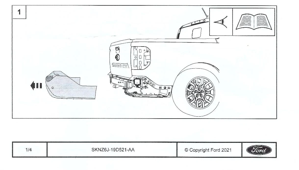

Ok, my receiver arrived with a bag of 8 bolts and "Instructions". Step 1: an eyeball, a book, and a bumper magically being removed. WTH does that mean? So much for an easy install.

No wiring harness or plugs included. For those considering DIY installation, attached are the instructions included with the Maverick 2022 Receiver, Ford Part #NZ6Z17D826C:
Ford Maverick Hitch receiver, come on already Ford Maverick Trailer Hitch Installation Instructions p1-50
Ford Maverick Hitch receiver, come on already Ford Maverick Trailer Hitch Installation Instructions p2-50
Ford Maverick Hitch receiver, come on already Ford Maverick Trailer Hitch Installation Instructions p3-50
Ford Maverick Hitch receiver, come on already Ford Maverick Trailer Hitch Installation Instructions p4-50

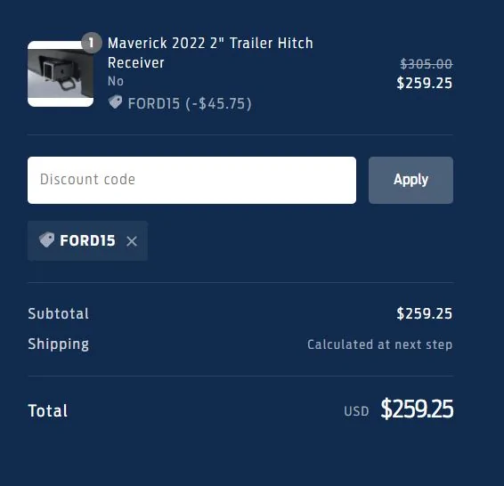

According to ford accessories website they have part# NZ6Z17D826C for the maverick hitch $305 and currently has 15% discounts on everything they offer
You can also use your salesmen employee discount for 23% and make it a little less painful check with him or her

Yes, but it appears that you will need a Ford Factory Repair Manual for instructions on how to remove and reinstall the bumper. That may cost an additional $295! I am hoping that someone will install a hitch and let us know how it goes.

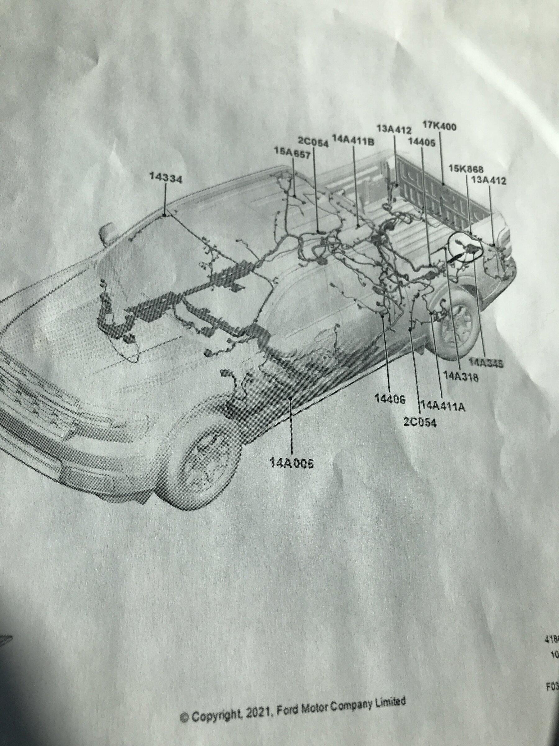

Went to dealer today. They can’t figure out the OEM harness parts. Gave me a print out with a poor pic and part numbers. But on Ford site you can’t expand the image when looking at parts.
Ford Maverick Hitch receiver, come on already image
Deleted member 5597
Guest
I think we might be S.O.L for a wirIng harness unless there’s an after market one available somewhere.
