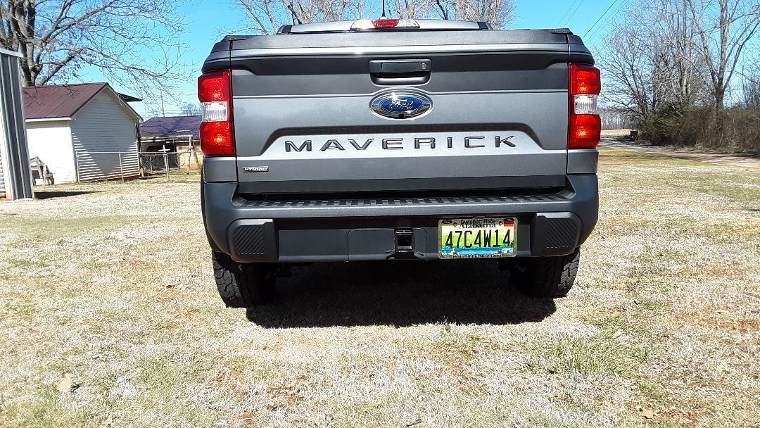

Ok, Was able to do the measurement. The rectangular tube measures 3-5/16" X 2". Reality is the crash bar is the exact size of the hitch without the dropdown receiver. It would be super easy for a welder to just add a receiver to the crash bar!
I did just that. Went to Tractor Supply and bought a receiver and with a couple plates cut and some welding had a hitch. Cost about $50 in supplies.

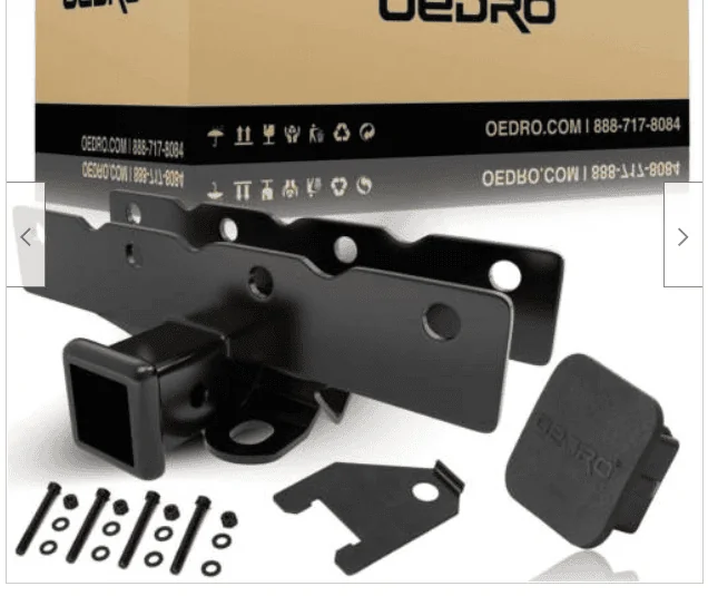

Thanks for the measurements. You are on track to where I am headed. My plan is to weld on the receiver like one you can buy for a Jeep JK/JU for 50.00. I may have to modify the width but I am sure there are some applications that are already 2.00'' wide. Need to do some more research to find a direct fit.
