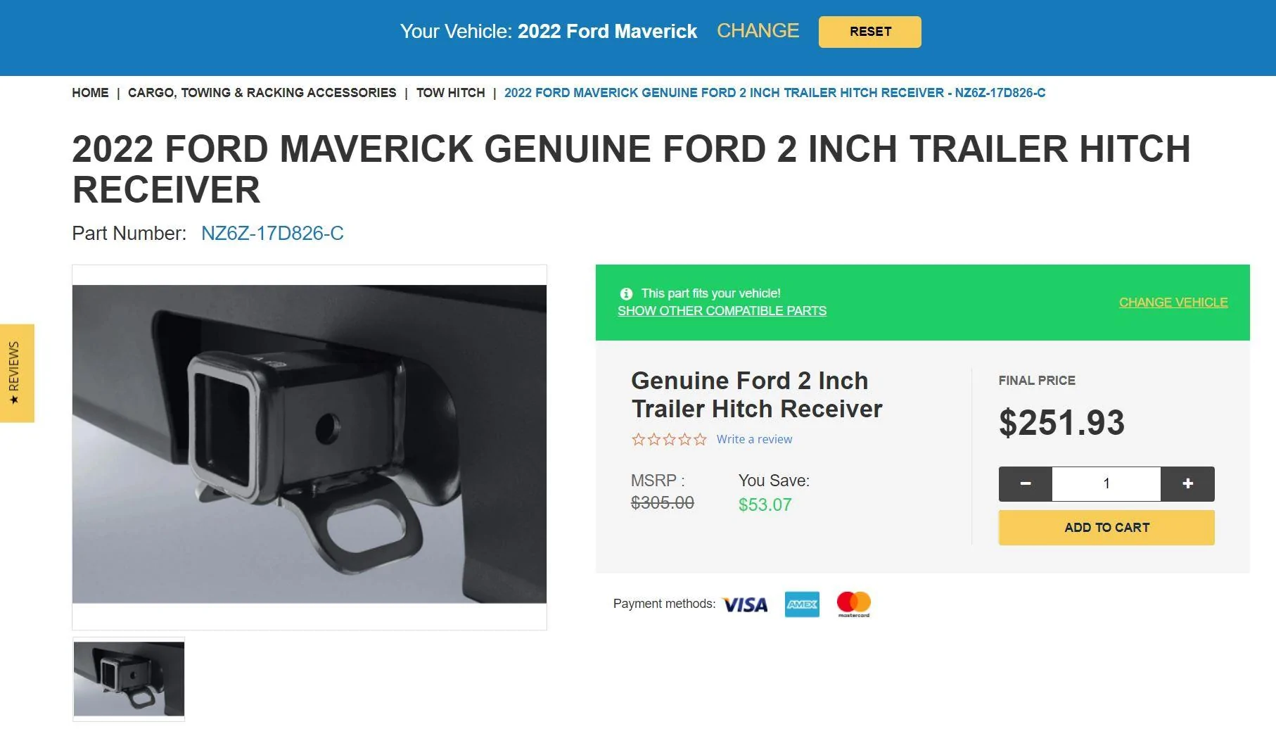

There is a Ford OEM Receiver Hitch that bolts on. I have one on backorder at a Ford dealership.
EDIT: I should have read to the end of the thread before responding to this early post. I see that this input was corrected by later posts. Anyway, it may be helpful to someone to see what it looks like. The screen capture below was from https://www.levittownfordparts.com/sku/nz6z-17d826-c.html. I hope the one I ordered arrives before I need it in June (for a bike carrier).

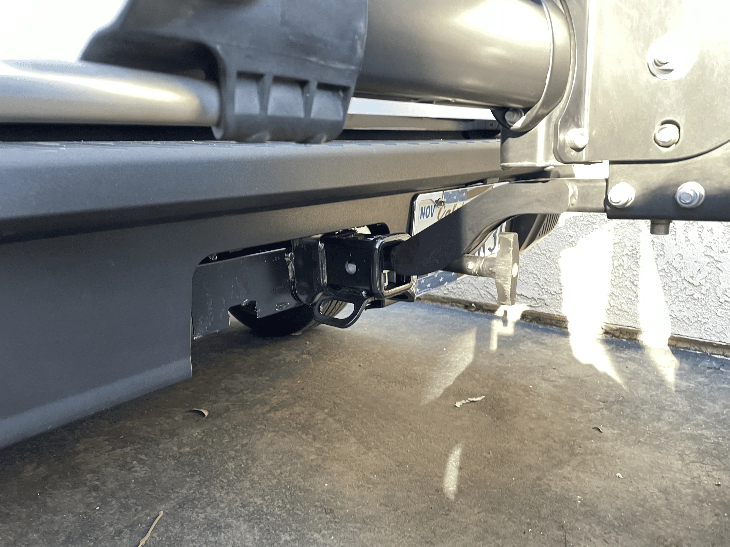

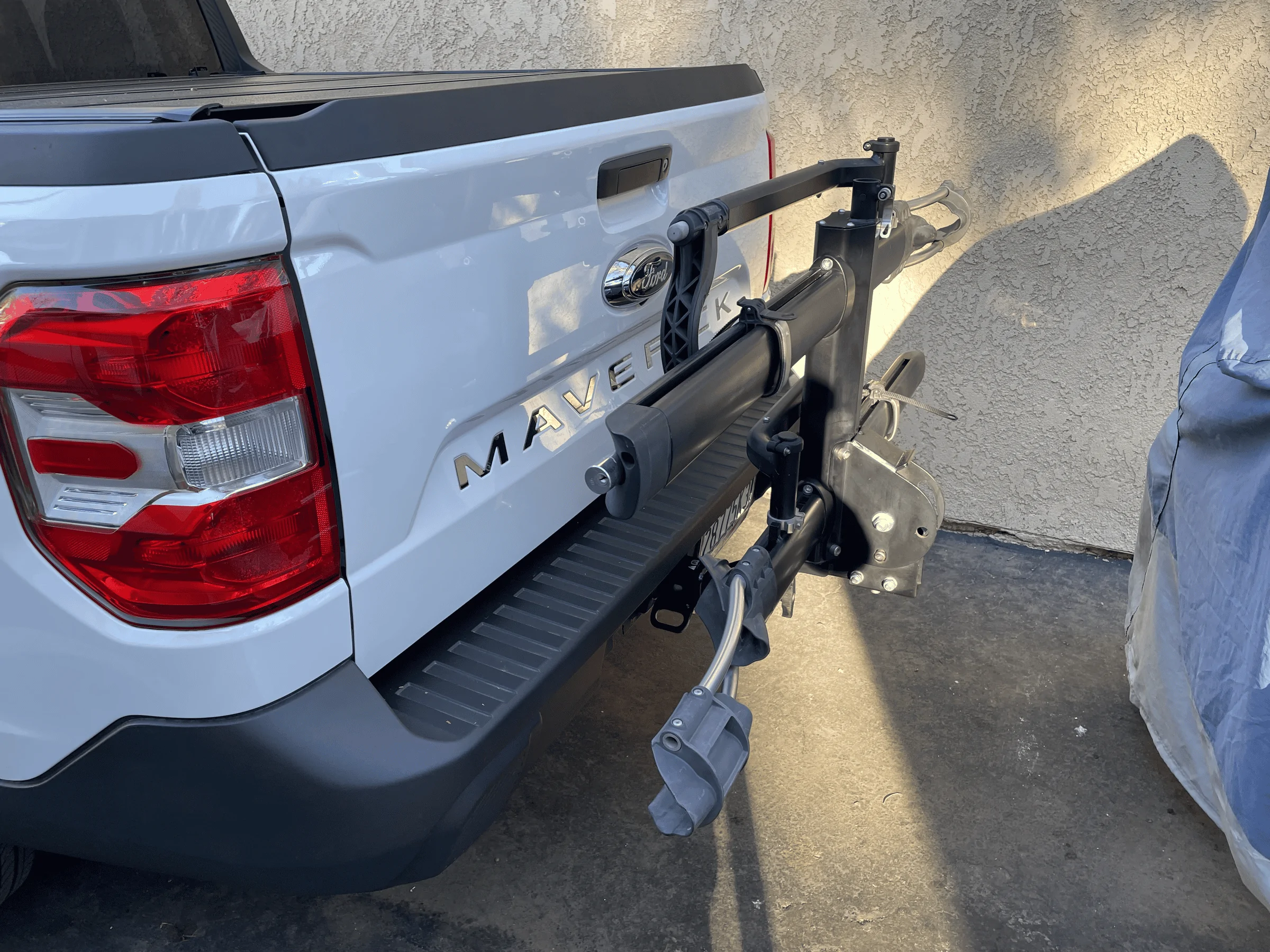

I finally installed my hitch receiver purchased from Ford.com/accessories. The install was relatively easy but required removing many bumper screws. The tough part was getting the nerve to pop the side bumper snaps without breaking anything. I found after removing all screws just pry with a pry bar from behind. There are 8 large bolts holding the frame bracket in place. Once removed your hitch will slide in place, I reused the same bracket bolts to secure the new hitch. The entire job took me about two hours, but if I did it again it would be less than an hour. If anyone has figured out the wiring please chime in as several of us are in the same boat?

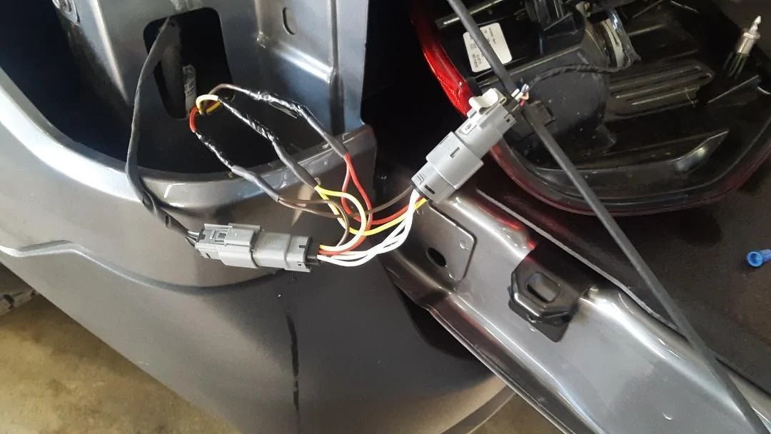

I ordered the E- Trailor kit for the Bronco Sport. Easy install but you have to change the wires going to the new module. You also have to run a wire to the + post on the battery. The splitters pug right up to the taillights. You have to cut the red and brown wires going to the new module. Then tie the red to brown and the brown to the red. This worked for me, but I am not liable for your install. You do not have to splice into the truck wiring harness. Here you can see the splitter plugged into the taillights and the red and brown wires going to the new module redone. Hope this works for you. It did for me.
