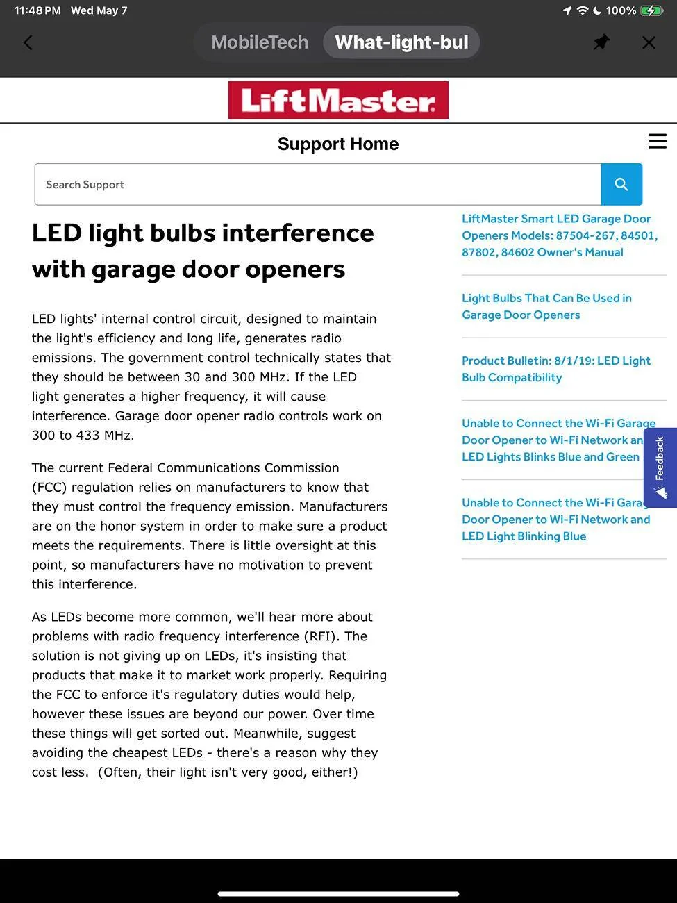

For your configuration issue, are you connecting it to a guest network? If the guest network does client isolation you won't be able to connect to the opener to finish setup. Your network has to allow peer discovery in order to complete this kind of setup

We install several in a week, never have issues at all. We do use them on alarm.com tho. Maybe the wifi. Only issue we had was if you mounted the gateway too close to the opener, it would work intermittently , so I just put the gateway on the wall by a electrical plug and where the strobe will be seen. You may have interference from cheap LED bulbs in your opener. Here is a sheet from chamberlain
