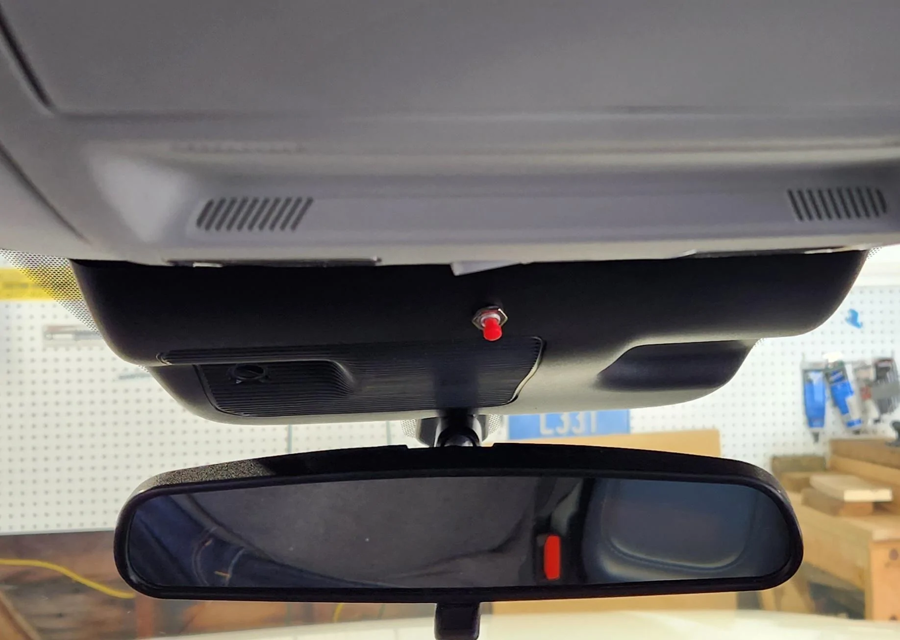

Your post inspired me, great idea!! I had a monetary switch laying around so thought I'd give it a try. The RED button! I may switch it out to one that matches interior eventually 😉
I love it! Maybe should have made it an eject switch instead! 😂

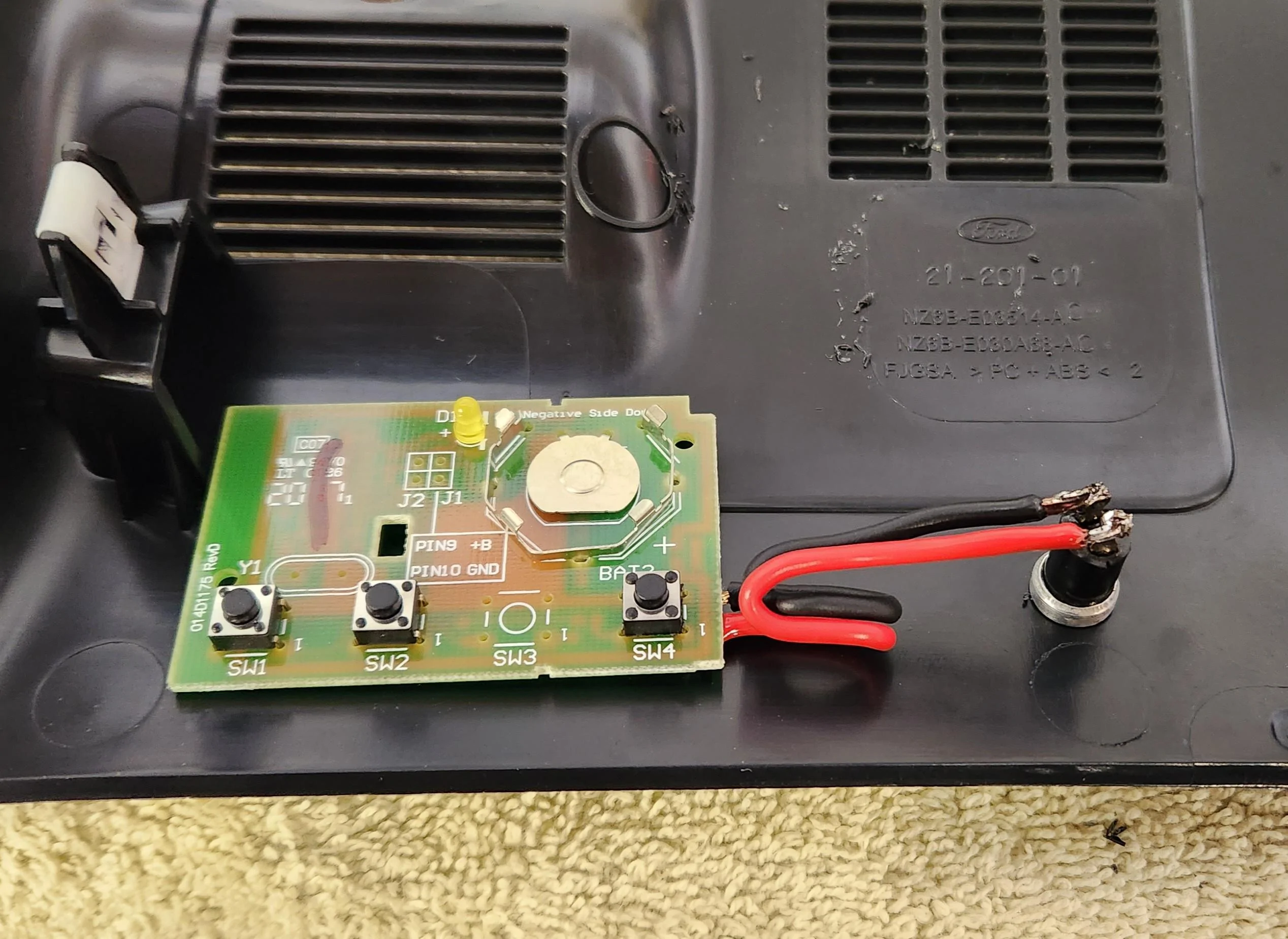

Hi all. Sorry for yet another cubby post, but I like it and hope it can maybe encourage someone else to do something functional with their cubby.
I was tired of not having a simple garage door opener. I originally had one of those ugly and generic 3-button openers with a clip but generally don’t like those on my visor since they happen to stain and dent the visor over time.
I made my own solution- a momentary switch soldered to my garage door opener’s board and houses that in a custom 3D printed box. I think it came out pretty simple and clean!
The screwheads don't match the rest in the cabin :)
