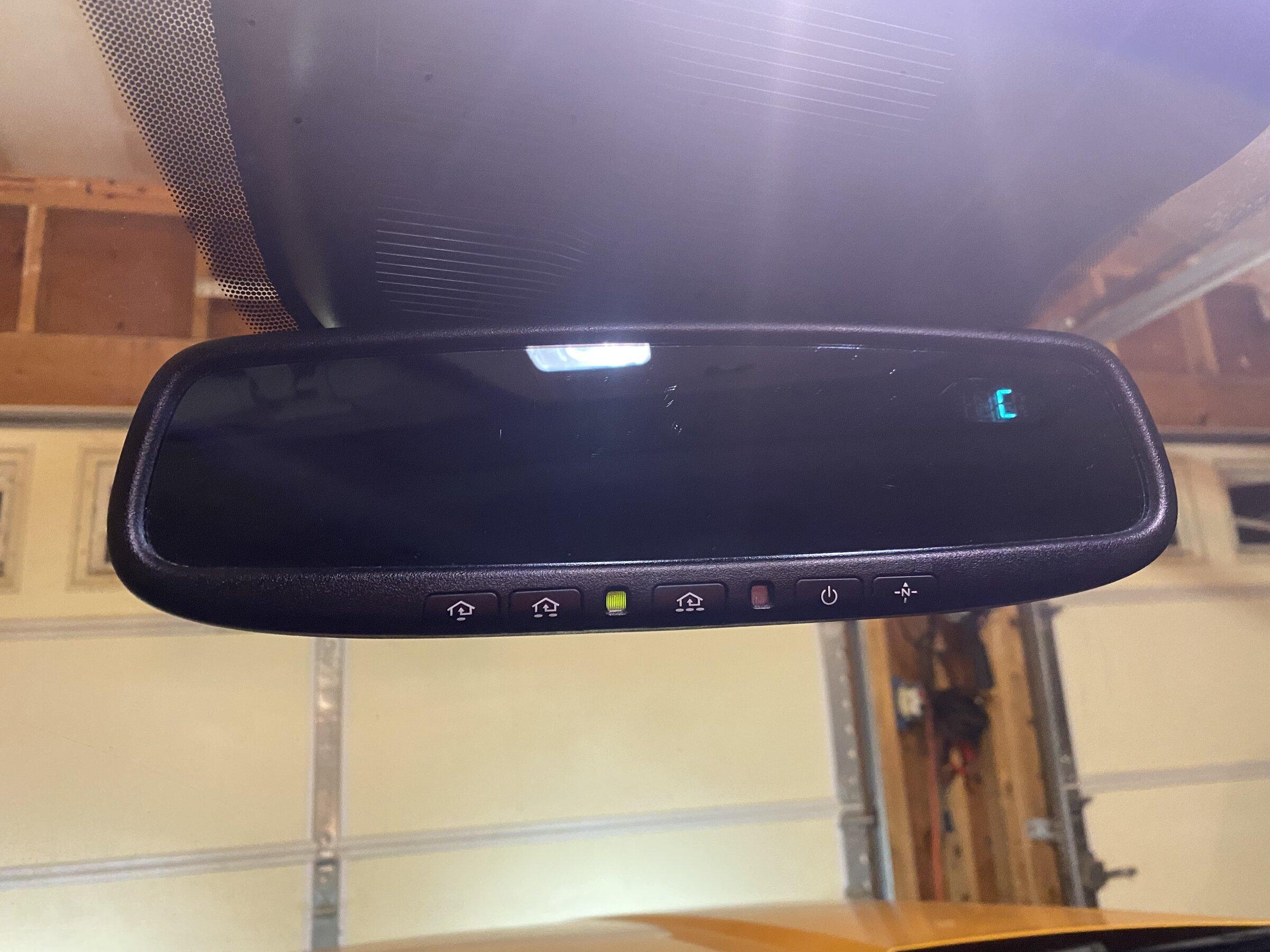

Unfortunately the escape visor is NOT the same and will not work in the Maverick. Ask me how I know… I wanted the oem garage door opener as well but with this option not feasible I went with an auto dimming mirror with homelink. Just as factory looking as the visor would be.
I didn't figure they would but I'm fairly savvy at modding stuff/retrofitting. If not I'll just wait for a wrecked lariat to show up in one of the local salvage yards and grab one out of a wrecked Maverick. That mirror you got does look nice though!
