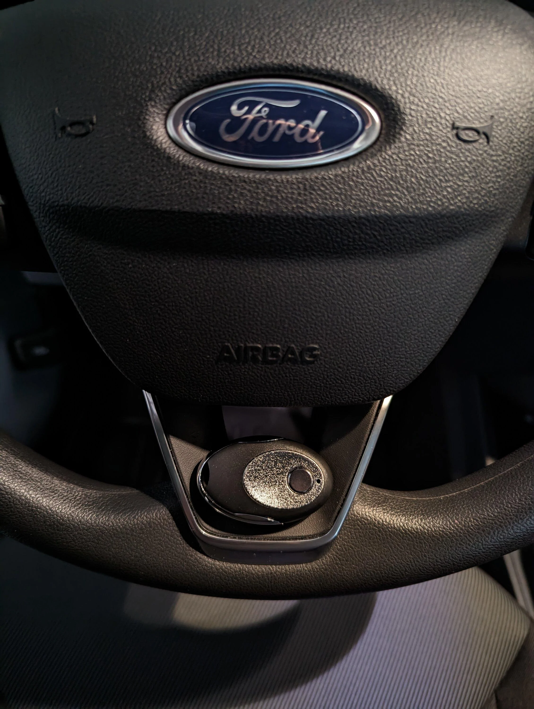

If you want easy, just double side tape a remote someplace convenient to use. Or put one on your visor like normal people. But where's the fun in that. I stuck one one my steering wheel. The OPs modification is a cool use of the cubby. love the creativity.
