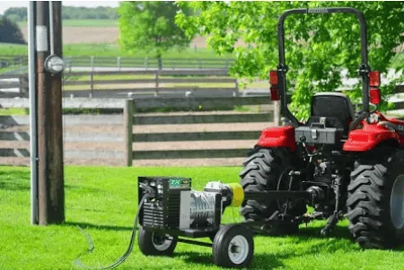

Valid points for the city. My generator experience is rural. Tractor & PTO driven for enough KW to run milking machines.
I wish I had that setup (and space). Jealous.
