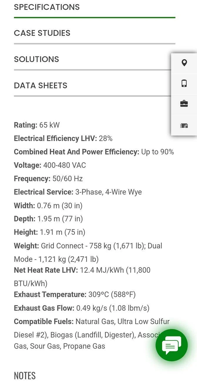

HRG
If you wanted to get serious capstone green energy smallest 65kw Genset will burn pretty much anything around farm after prepping it. They have an "air bearing" which is corrugated and uses air molecules to keep metal surfaces apart!
