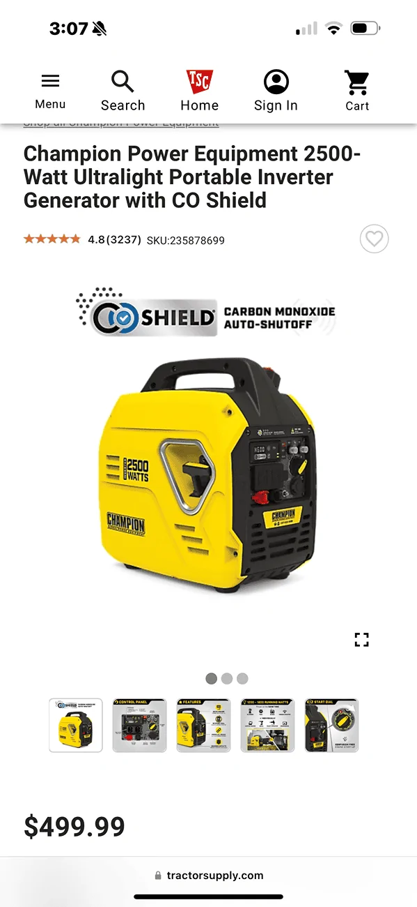

About 5 years ago, I pondered this “emergency power outage” scenario and this is what I came up with:
Ford Maverick 2000 watt Hybrid inverter as generator IMG_1387
I picked it up around 5 years ago for $429 and is sitting in the closet of a spare bedroom, box never opened, oil and gas never put in it. My gas furnace and gas hot water use 120v and are supplied by typical wall sockets. My furnace uses 250 w continuous, 500w on startup. Nearly identical to my fridge. 55” tv uses 220 W, LED lights about 7w each. Natural gas stove can be started with a butane lighter rather than plugging it in. With just a few 100 ft indoor/outdoor extension cords and a really small generator that makes 1,850 W continuous, I can run everything in my house that I need and keep the generator safely in my back yard. Yeah, I want AC, but in SoCal I don’t need it because the low humidity is survivable when it is hot. I keep 2 Jerry cans of gas in my garage and once a year I empty them into a car and refresh the cans with new gas. Super simple system, low cost, super low effort and I haven’t experienced any power outages since 2017, so even the small generator feels like overkill.

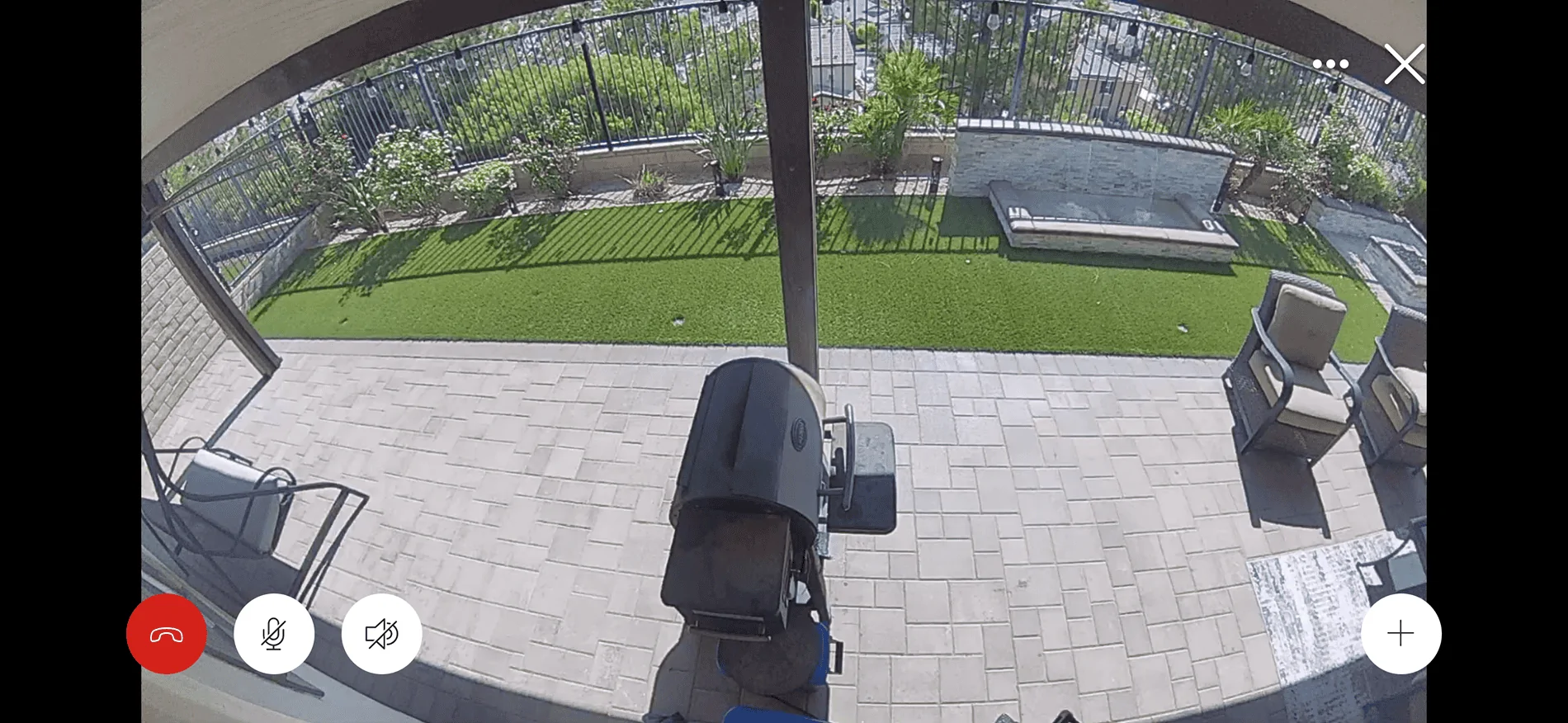

however, I have a fenced yard with a locking gate. no one is likely to get into the backyard without me seeing them on a battery-powered camera, I've never had an intruder in the backyard at all, and yes it would be rather easy to devise some means of securely locking a generator in place. if you shop around a little, it is not hard to find generators that are under 70db when loaded: https://generatorbible.com/blog/quietest-portable-generators/
Exactly this!
I have a 6 foot wrought iron fence around my yard and a gate that locks on the inside with a 5/16” lock on it. My Ring camera in my back yard alerts me in seconds, every time I step out on the back patio. I have zero worries about my generator getting stolen.
Sounds like a good plan. What do you consider is the shelf life of a small gas motor? I.e. how long the rubbers and plastics will stay good? Maybe sometime soon sell it on craigslist/marketplace and buy it's replacement for the next X years. Just like keeping fresh gas.
Not sure on the answer to that, but I also have a 2012 harbor freight predator 4,000 watt open frame generator. I fire it up once a year or so and it still works just fine. And I have a 2010 Honda pressure washer that I use 3-4 times a year and it is still working just fine as well. I don’t see any cracking of fuel lines or anything like that and these have continuously had fuel and oil in them for 12 and 14 years, sitting in a garage that gets up to 130 degrees in the summer. I bought the inverter generator because it has a closed frame with sound deadening and they rev up depending on load, instead of sitting at 3,600 rpm loaded or unloaded. The inverter generator is just much quieter and more serene, which is good in your backyard. The open frame generators are better suited to construction sites.
