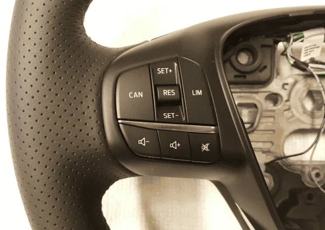

Nice video. Does anyone know if the switch that is for speed limiting and not cruise control would work the same for cruise control? I would guess a switch is a switch regardless of the marking?Just got my video for this process complete!
From personal experience I can confirm it will not, sadly. I've got one of those switches from the same style wheel - you'll have to replace the left button cluster should you order one of those euro wheels, but it -will- come with the right cluster you need.Nice video. Does anyone know if the switch that is for speed limiting and not cruise control would work the same for cruise control? I would guess a switch is a switch regardless of the marking?
Thanks for saving me the time and expense in testing this myself. I appreciate your help and knowledge.From personal experience I can confirm it will not, sadly. I've got one of those switches from the same style wheel - you'll have to replace the left button cluster should you order one of those euro wheels, but it -will- come with the right cluster you need.
