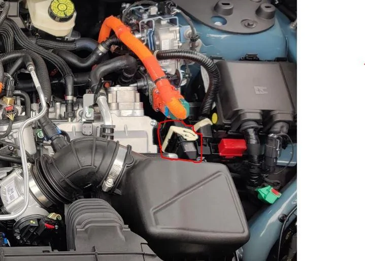

You can add me to the Dead Hybrid list. Yesterday when I turned the key off, all power was gone. No Trip Summary, no interior lights, no power locks, and it wouldn't start. I was trying stuff like disconnecting/reconnecting the battery. I looked at the fuses there on the right of this picture. The battery under the seat was reading 12v but when I check the voltage on the jump start port under the red cover next to the fuses, it read around 2v. I found that when I messed with the plug that I circled in this picture then it sometimes would come back to life. It went dead 3 times yesterday and I think it has to do with where the wires go into the plug on the back side. There are pieces of white plastic there by the wires and pushing on the white plastic seemed to help.
Needless to say it's at the dealership right now. It's frustrating the Service dept is super busy and they might look at it in about a week and at that point the waiting for parts phase would start.
Interesting, so far all the hybrid battery issues I've seen have been with the connection I circled in purple, mine included.
I've had no issues since putting a clamp there as described in the Hybrid Battery Clamp thread.
