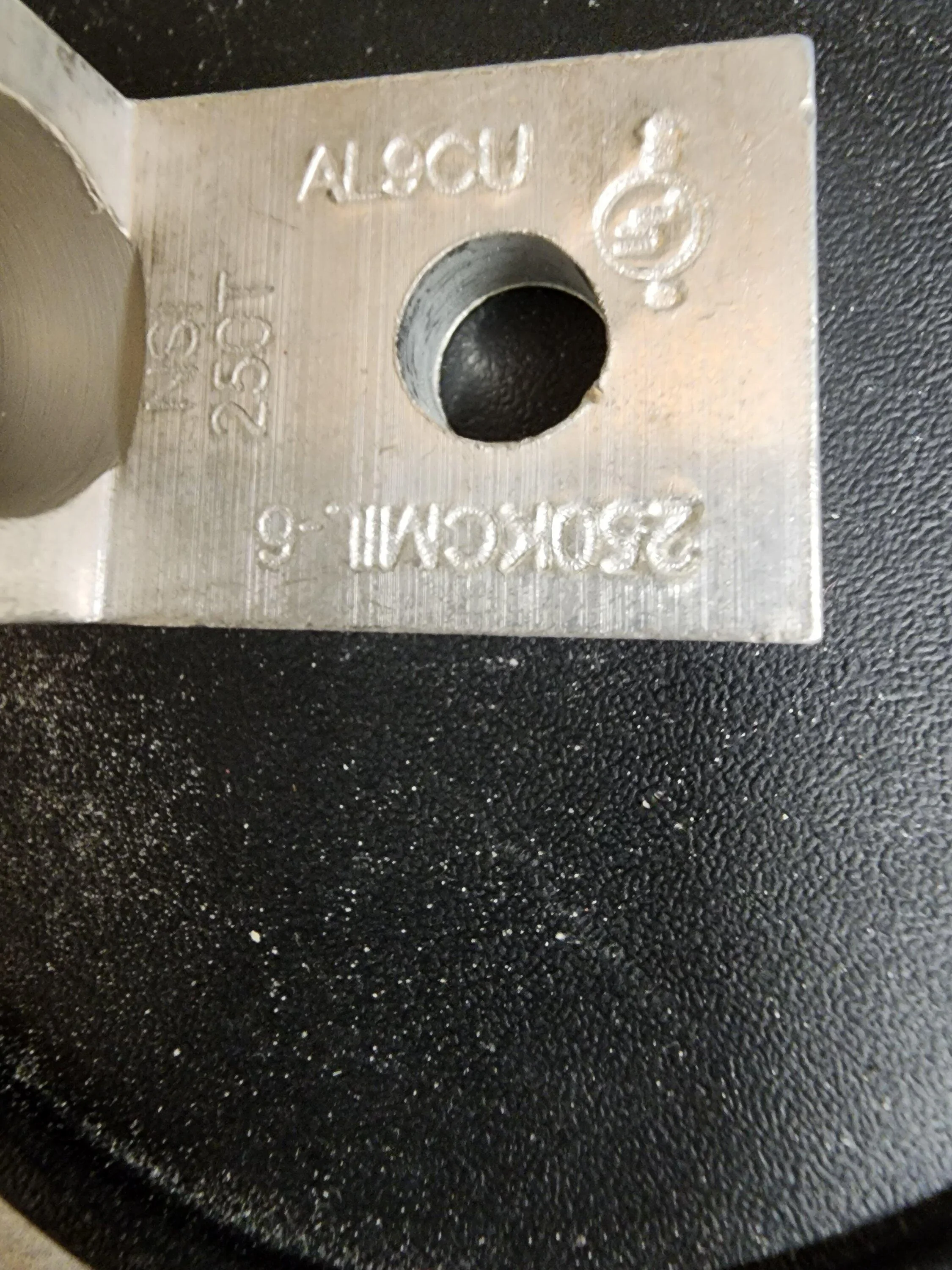

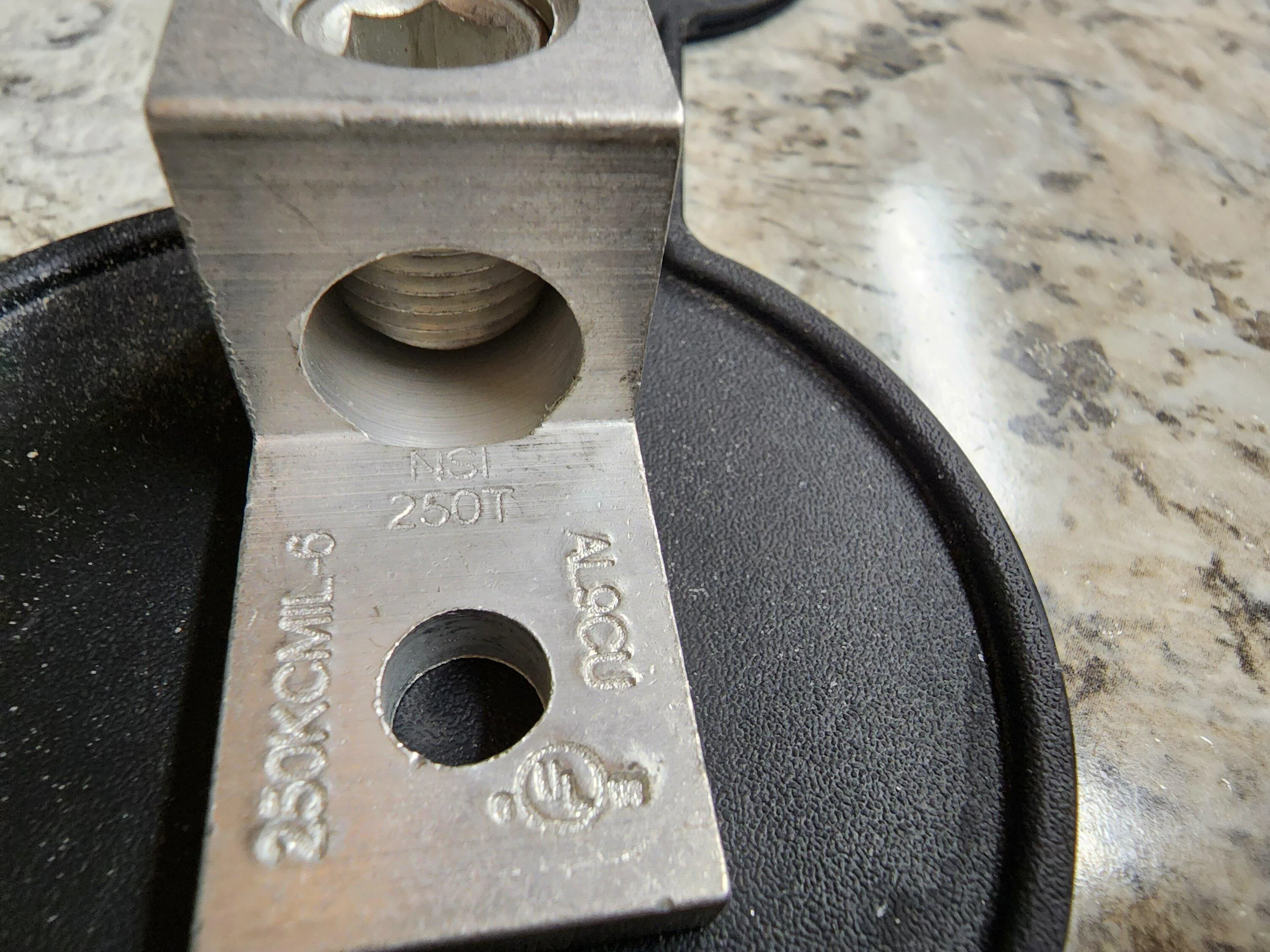

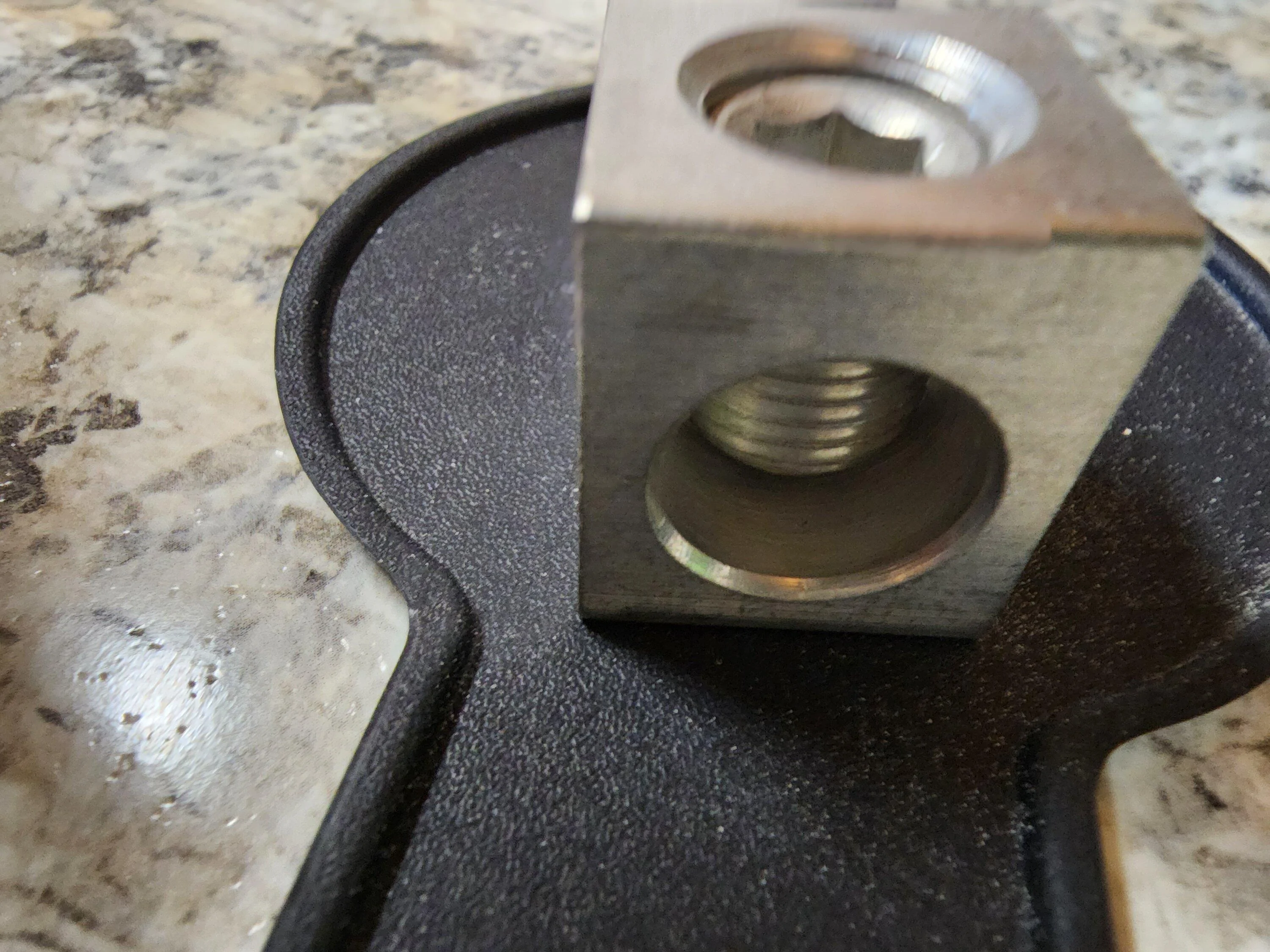

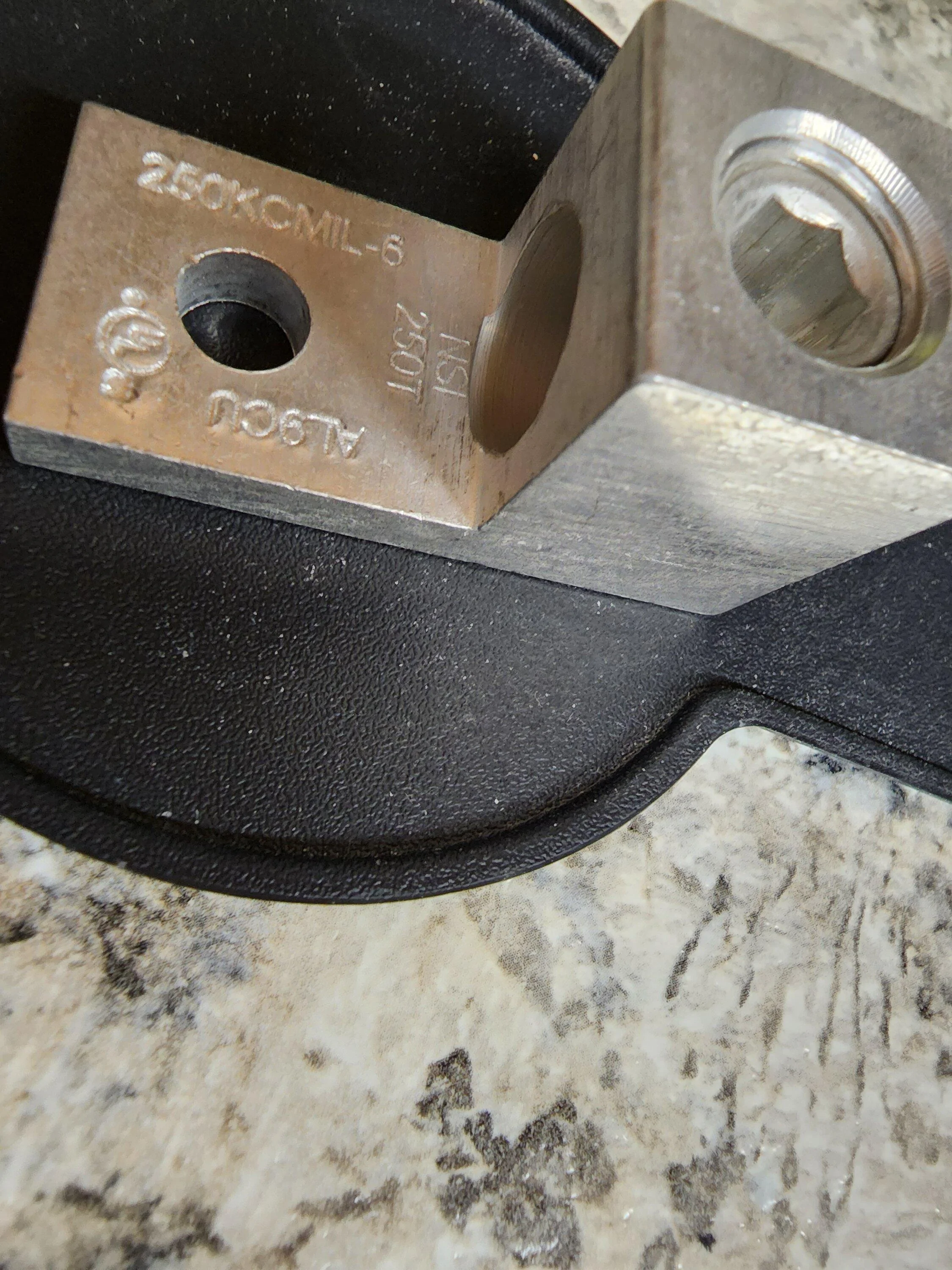

Heres the majic guy...no crimpers needed, just a torque wrench.
These are aluminum, with an Aluminum clad rating and can be used with copper, of wait i am not using copper!
I was going to use this on my truck, but now if you are in central tx. I wont use copper in this application cause i dont want to endangered someones Mav.

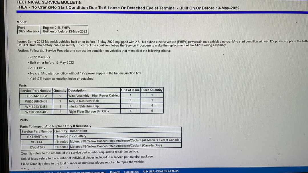

Credit goes to @Last Truck Ever
Hybrid Harness TSB, with impacted dates
This answers the questions from forum members who are wondering if the current builds or even if MY23 builds for the Hybrid could still have the problem.
Looks like if your build was after May 13th then the problem will not happen.
This exact date in the TSB seems like Ford narrowed it down to faulty build of batch(s) of the cables and after the date new batches were used that did not have the issue.

I don't think that's the case. The Technical Service Bulletin on the issue 22-2340 says that it only impacts Maverick Hybrids produced on or before 13 May 2022 -- so presumably after that point they started making better wire terminations, and that's what they're shipping out for warranty replacements.
As the problem is just the wire termination isn't staying on the wire properly, even if they repaired the existing wire termination, if properly repaired, they should be just fine to drive on forever. Preferably with a mechanical crimped connection instead of just soldering it on though.
My Mav Hybrid caught the issue, I'm just jumping it when I need to drive somewhere for now, but my dealer ordered the right "LX6Z 14290 PA" part everyone else is getting. Only issue I had was that supposedly they described the diagnostic as an issue with the high-voltage wire, when it's actually the 12v wire. But when I checked they had identified the right wire, it was just described badly.
