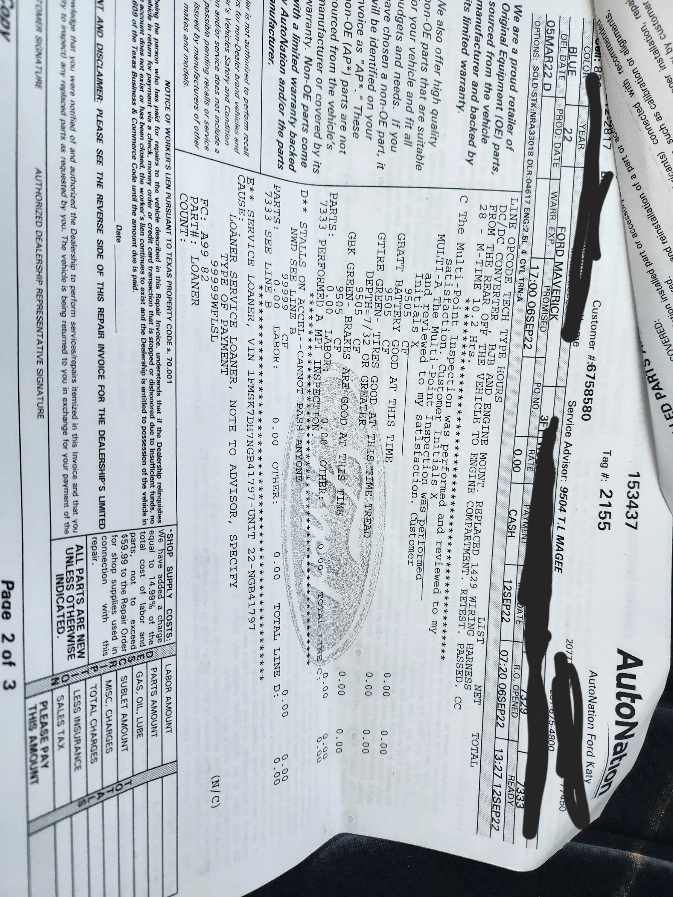

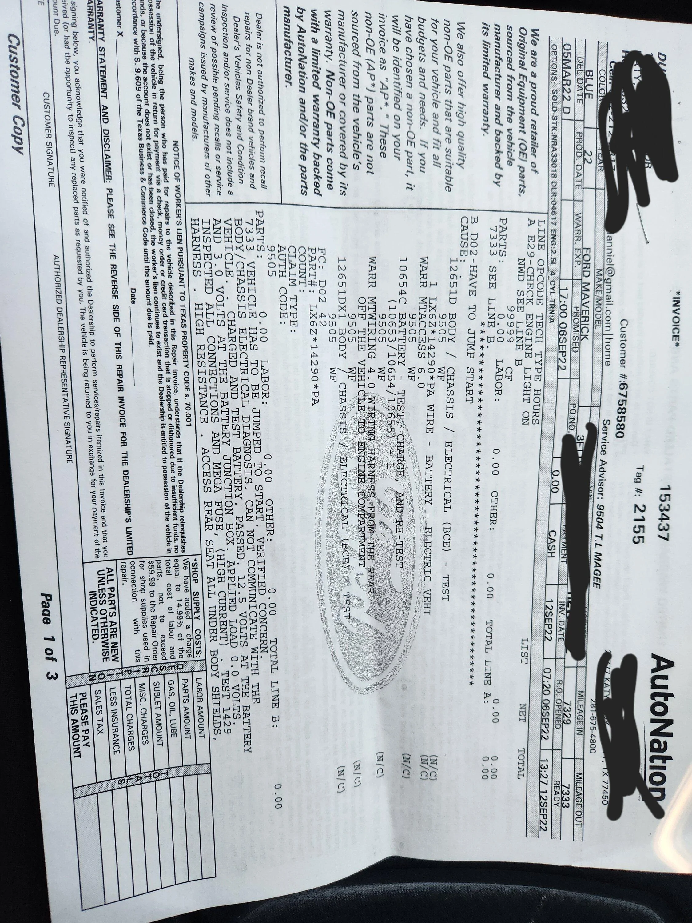

Please ask the dealer for the technician service report and post a copy ... thanks
Just picked up today 9/12 and they replaced wiring harness. Here is the photo of service that was completed. Surprisingly the parts came in quick. 6 day wait time
Ford Maverick Tracking DEAD HYBRID Mavericks Reported Dealer Solutions / Fixes ... 20220912_174552
Ford Maverick Tracking DEAD HYBRID Mavericks Reported Dealer Solutions / Fixes ... 20220912_174648
