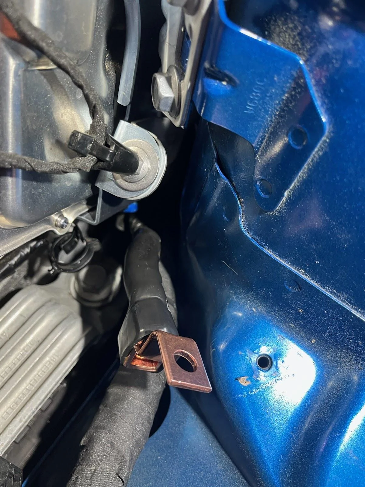

The repair is a very critical connection point. The battery cable is Aluminum, the only type of lug to be used is Copper Clad(DO NOT use straight copper, remember all the houses in the 70/80s that were using aluminum wiring). Using CU on AL will cause all types of errors down the road. The connection can get very hot if CU is used on an Al wire.
Then theres good old galvanic corrosion, when dissimilar metal are connected and the environment comes attacking, not good again.
Soldering to aluminum is almost impossible, specialized flux, solder, and controlled conditions are required.
Then theres battery cable replacement, a good portion of the truck has to be dismantled for replacement, then theres the parts shortage to contend with.
So probably the best solution is to PROPERLY crimp a copper/clad eyelet, in a very tight space, dont forget the heat shrink. Absolutely do not add any bolts, connection points, metals beside coper clad, or you have worsened the problem.
This needs to be fixed correctlly the first time. Over time is when you will see incorrect repairs that were improperly repaired fail. The 12v battery powers the processors, that will only work correctly with clean, STABLE voltage.
Your LONGTERM RELIABILITY depends on the correct repair procedure and materials.

That pic looks like good old Copper..

If your in the Atlanta, Georgia area, I have great news!
Here is the dealer that you want to go to:
https://www.howellford.com/
They fixed the faulty connector in approx. 3 to 4 hours while we waited. While other dealers made excuses, did not return phone calls, were generally rude and simply did not care, Billy Howell Ford was impressive and got the job done.
Their service department and service director are first class, 5 star, all the way!
Please see the attached pic showing repair. Unfortunately, I have not had a chance to see exactly where this connection is in the engine compartment. I Will try and update later where the exact location is.
This fix makes the most sense since it has not been confirmed if harnesses are still being manufactured the same way with the same problem.
Is that a grounding wire? I thought the problem child was the positive lug.
