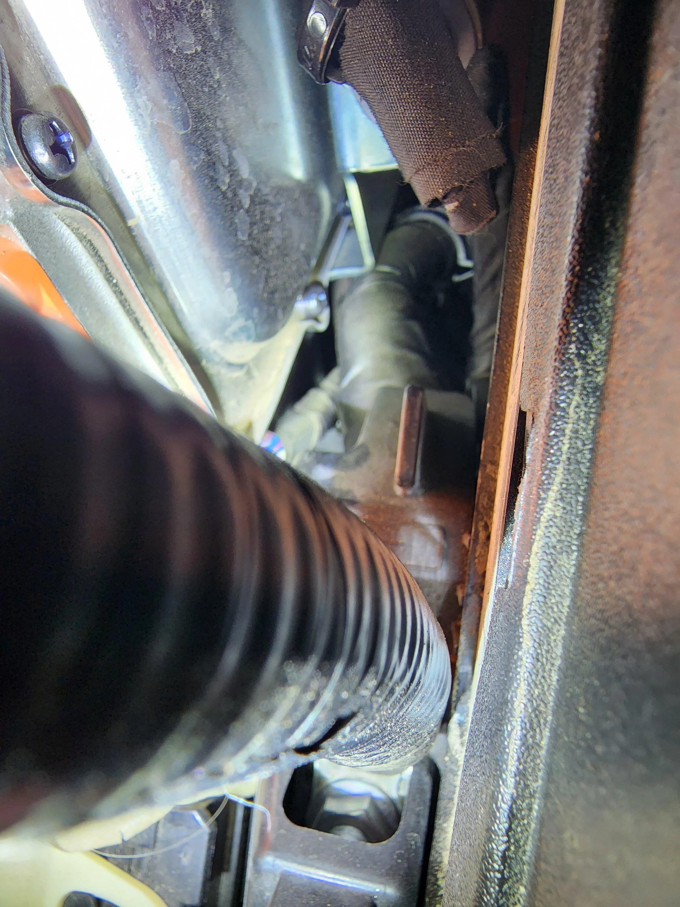

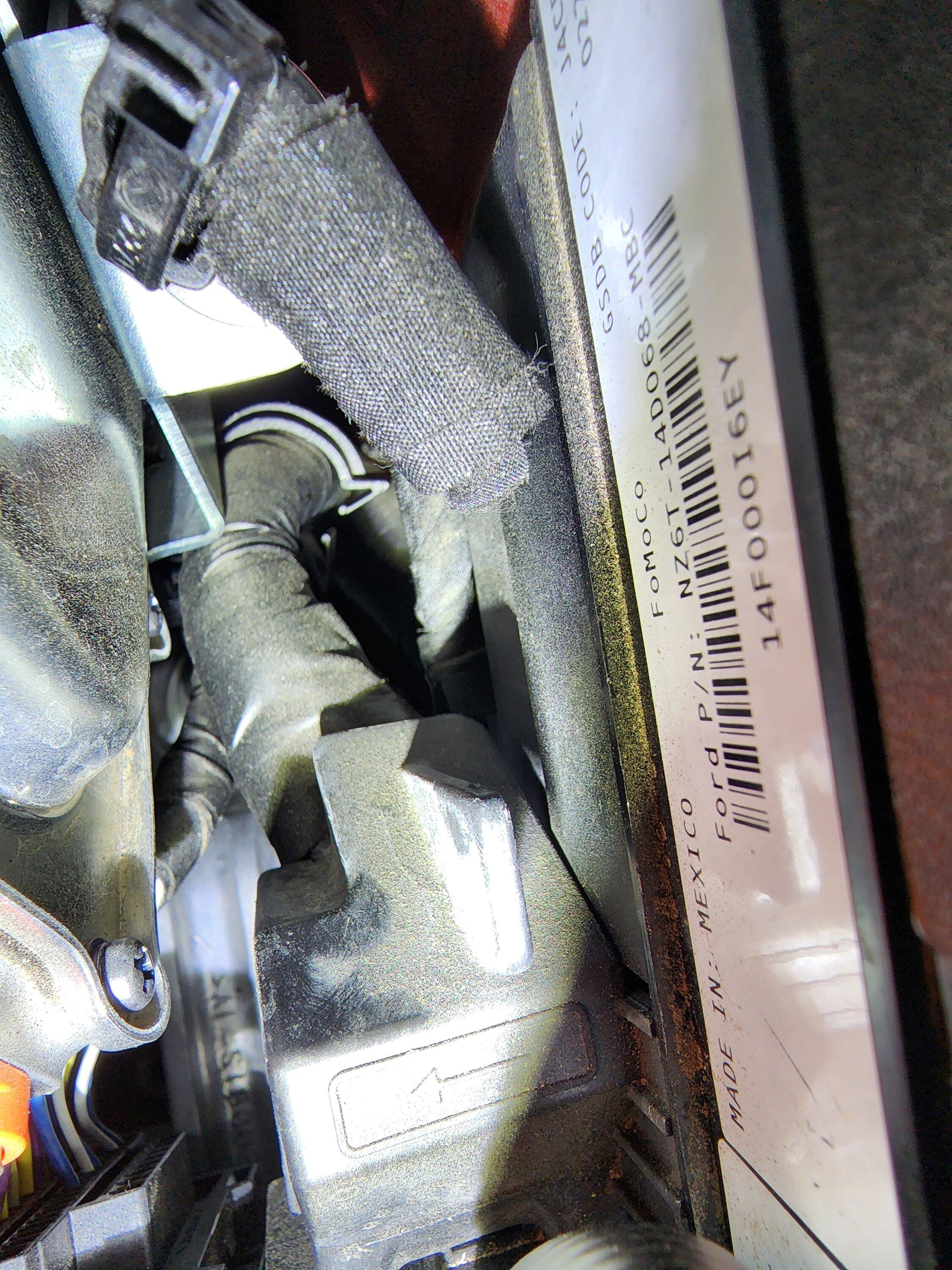

Chris, location? We are seeing/hearing that the majority 12v cable lug that is defective is in one of 2 places, the 1 under the hood under black plastic cover, to left of fuse block.
The other possible connection, which we think occurs most often in directly behind the.first, towards the firewall, its connnected to the 12v buss.
These pics are such, taken on top of fuse box, left side, down towards ground, the cable visible is the cable next to fuse box, other pic is of cable right behind to rear of Mav, these are the 2 possible cables that account for 98% of the 12v battery cable failures.

Dang, my engine is dirty. Texas dust.
Second pic shows cable running back towards firewall, under black plastic cover that has arrow pointing towards left, this is the most common point of failure. Right under that cover is the failure cable lug. It is aluminum cable so the replacement lug has to be copper clad.
