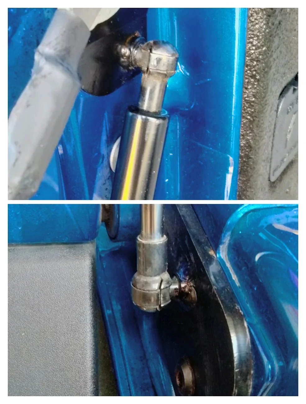

January 2024. I bought a no-name brand of Amazon for $19.99 still going strong. Here's a current picture. One of the best $20 I spent on this truck.
Ford Maverick Tailgate Assist Strut - Binding with the tailgate cable IMG_20260224_143337

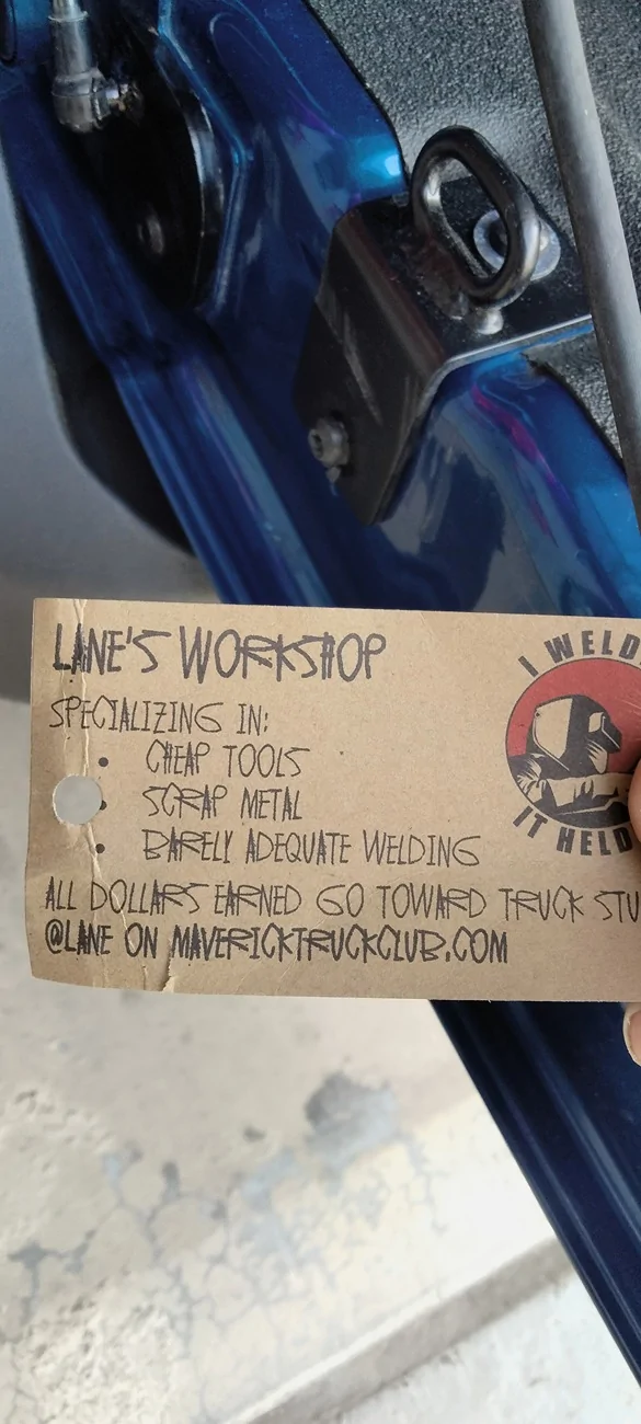

Rick I replaced the driver side tie down with one made from one of our members.
Ford Maverick Tailgate Assist Strut - Binding with the tailgate cable IMG20260224144426

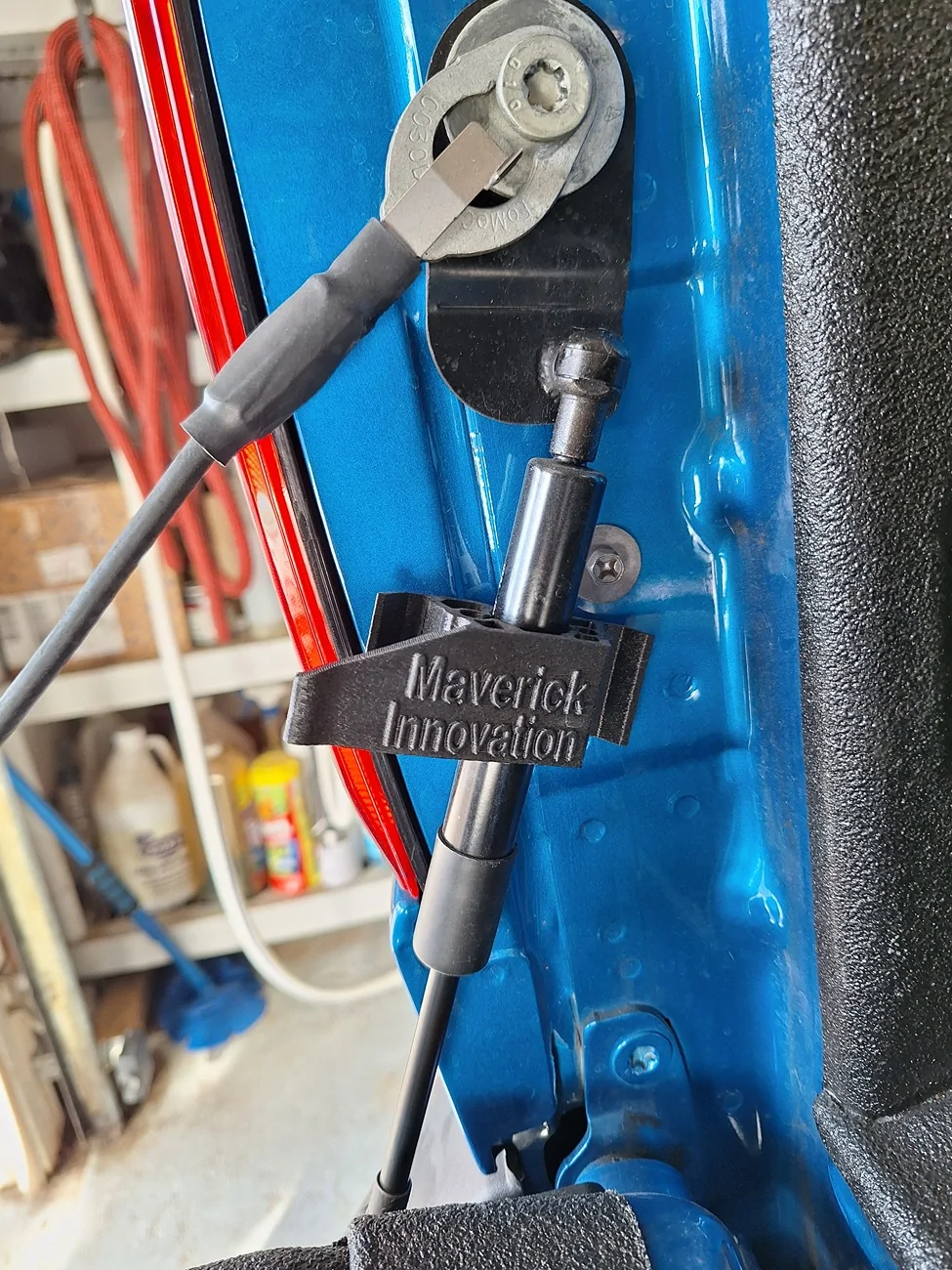

You need this
I installed a tailgate assist strut, following the instruction video - but the tailgate cable binds on opening and closing. Did I do something wrong? I considered just removing the cable, but wanted to see if there are others who've had and overcome this issue?
This will resolve the problem, a seller off Etsy is where I bought mine comes in two pack.

That there is the rotating of the bracket I was talking about. If you don't really crank down on that bolt, the bracket rotates, and the cable can then move behind the strut when you close the gate. The cable catch, or whatever you call it, install there clearly is one fix to the issue.
