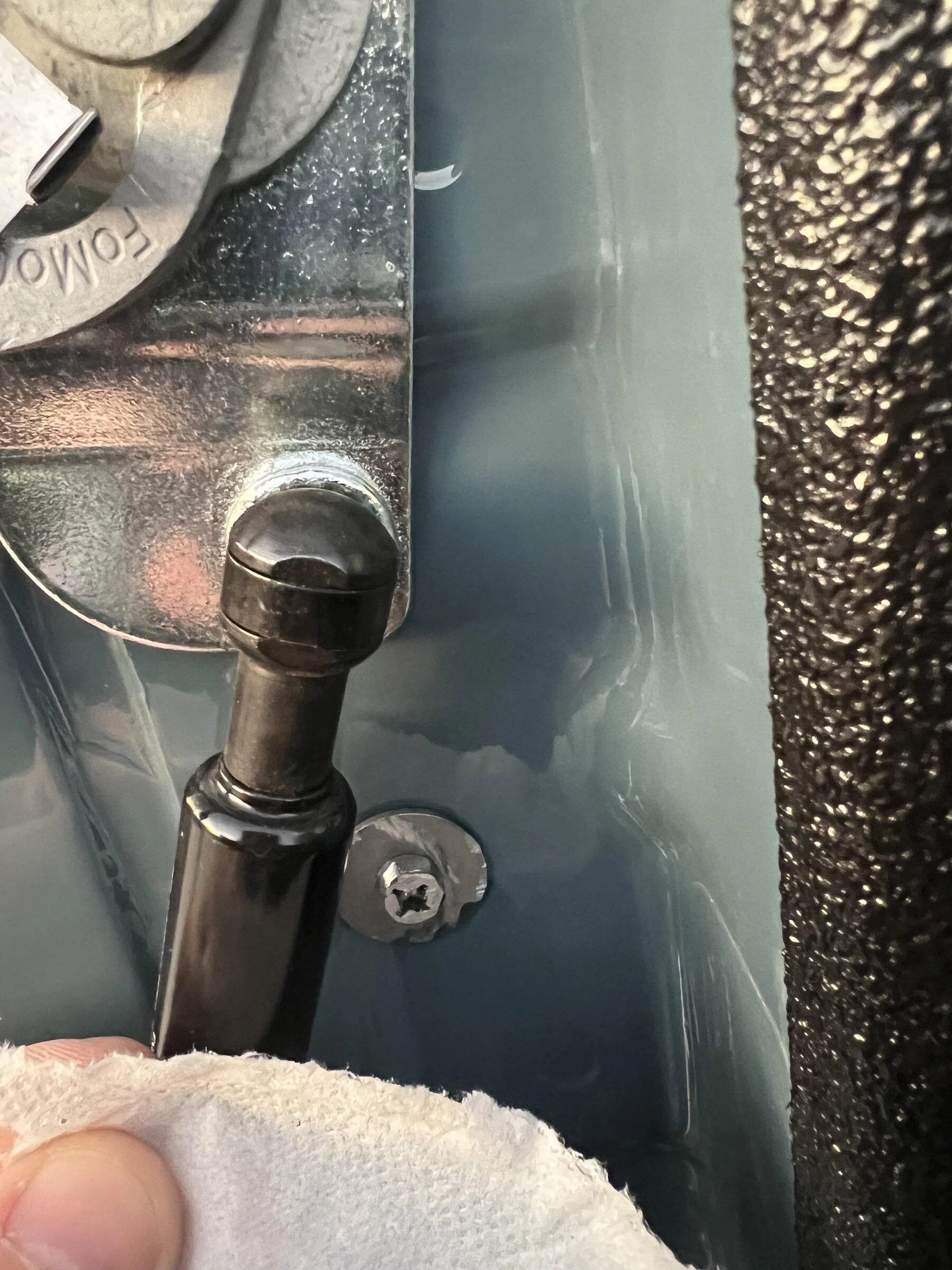

Shouldn’t have to do this but…remove the screw. Place in a vise with softies holding the threads. Grab dremel and grind head height down for clearance. Use a piece of toilet paper (yes the soft gold) as a tester. Place tp on top of head of bolt close the tailgate and see if you can remove the tp.
Or replace the screw with a pan head screw.
When you close the tailgate, the strut will shift slightly to the passenger side, so when you are visually checking for clearance, do it with the tailgate closed.

If you look at the photo from Ford, yes it is upside down, but look at the bolt in question. Find that bolt, and swap it.
Maybe, just perhaps Deezee is telling the truth by saying the current bolt wasn't there. Looking at Ford's photo, and the photo you guys have posted of your install, the bolts are different.
DeeZee was probably given an early vehicle to use to design, Ford probably later realized they could save some money by changing the bolt in production versions.

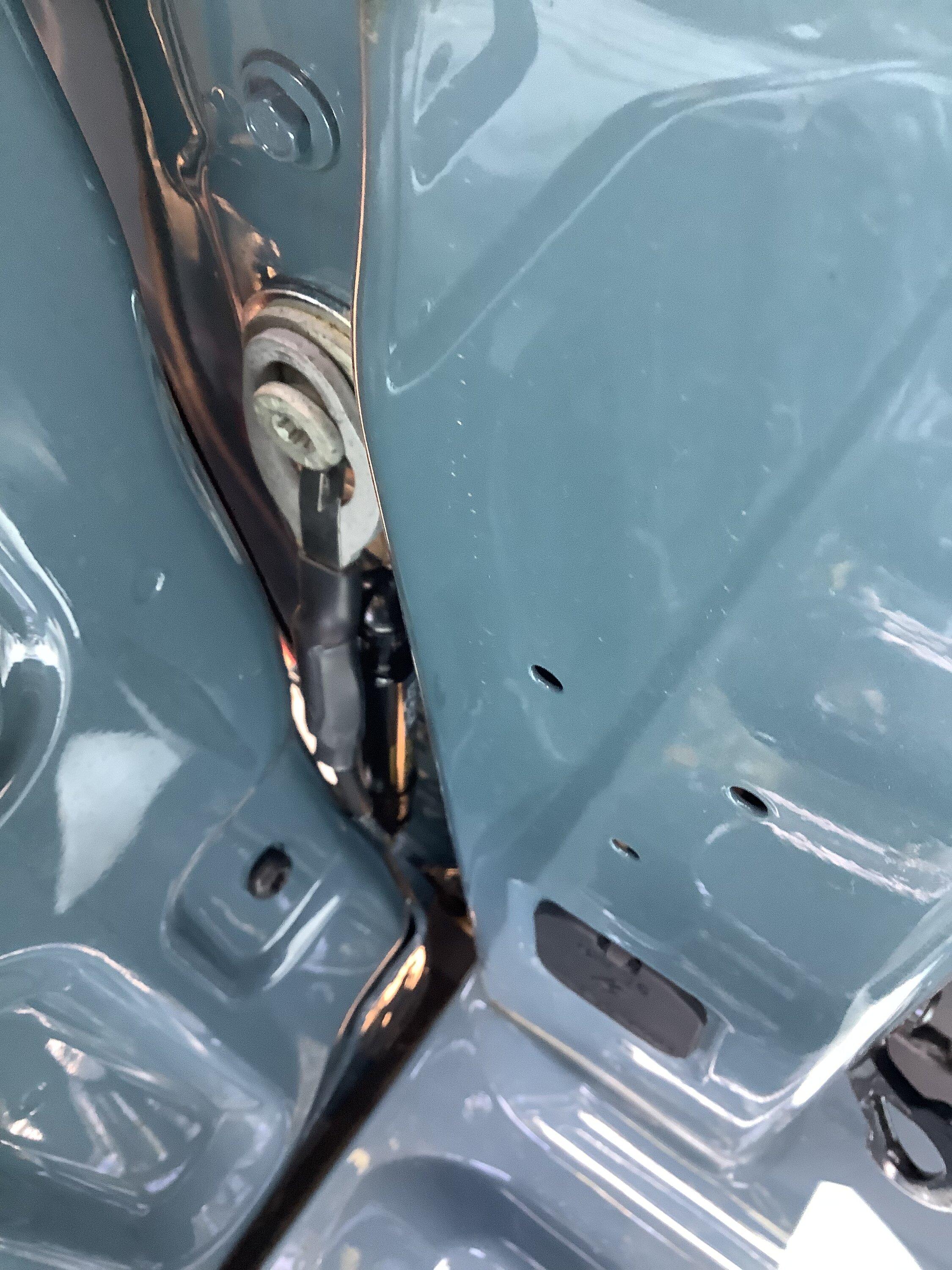

Hopefully another data point on this, I just installed the Tailgate Assist from Ford, and I initially tilted the strut bracket next to the tail light (to avoid rubbing the screw, as shown in previous examples), but then looking closely, I could see the strut wasn't even near the screw head, in my case. I adjusted the bracket to be perfectly vertical/flat, and I could still see about 1/8th inch between the screw and the fat strut housing (strut installed correctly, main/fat end on top).
So, you might install the bracket flat, then slowly close your tailgate and see if the screw head is going to rub the strut housing. If it is going to rub, then just tilt the bracket. Maybe Ford started using different screws, or maybe Dee Zee adjusted the Tailgate Assist kit recently... Anyway, it works great!

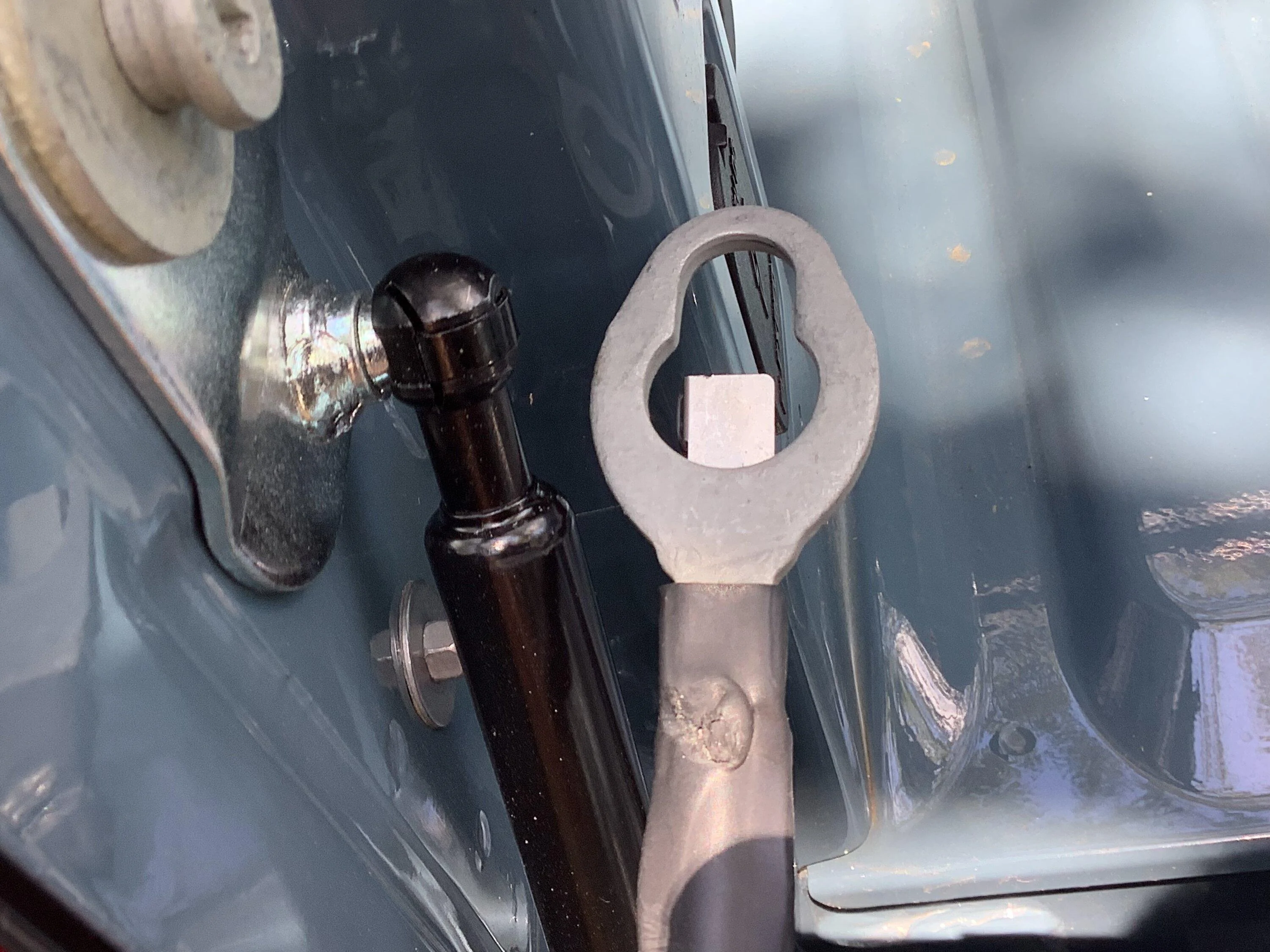

I’ve installed this tailgate assist and have no issues with the strut rubbing the screw. However the cable gets pinched between the top of the strut and the tailgate damaging the protective heatshrink. I have to guide the cable to the back of the strut as I close the tailgate. Installation was very straightforward, and I don’t think I installed this incorrectly. Anyone else have this issue and/or have a solution? Thanks.
So, a year later, but how has your cable and heat shrink held up?

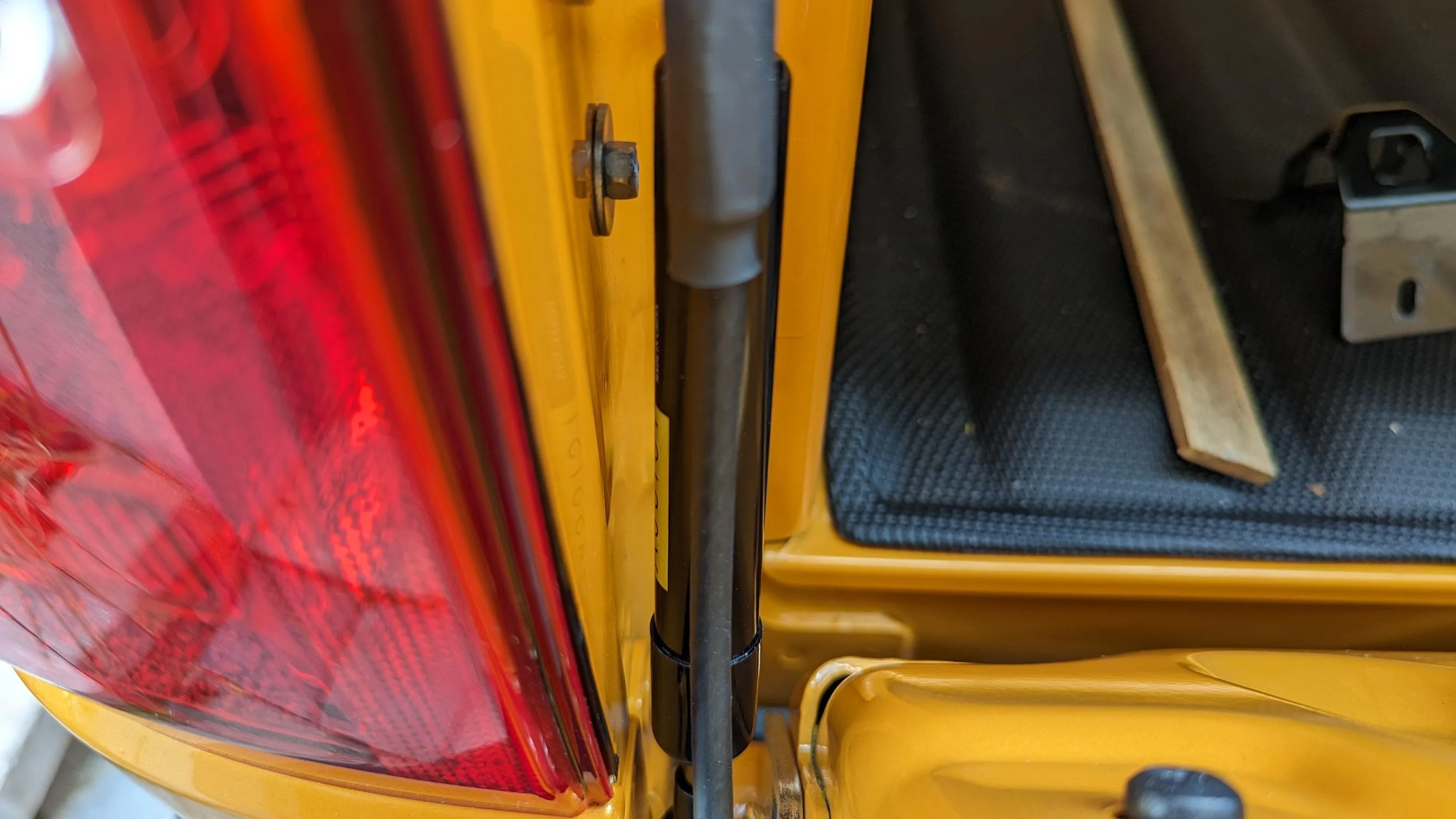

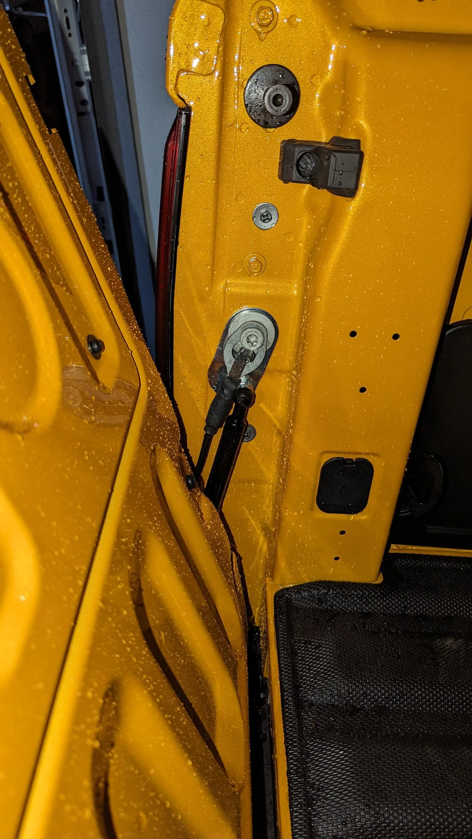

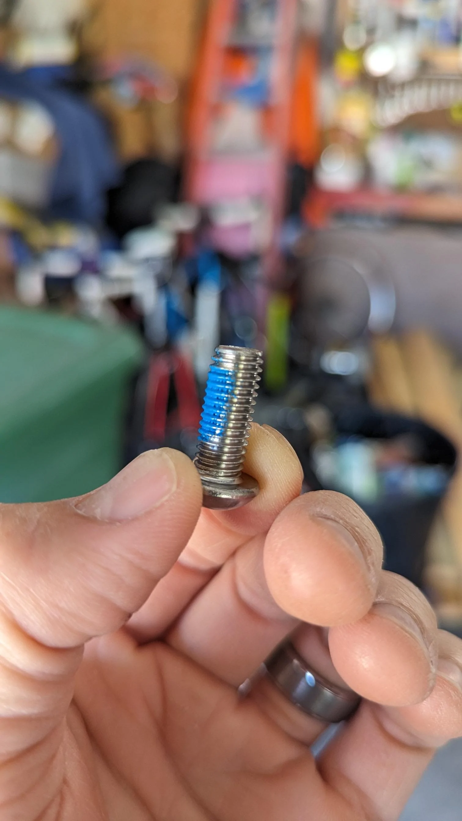

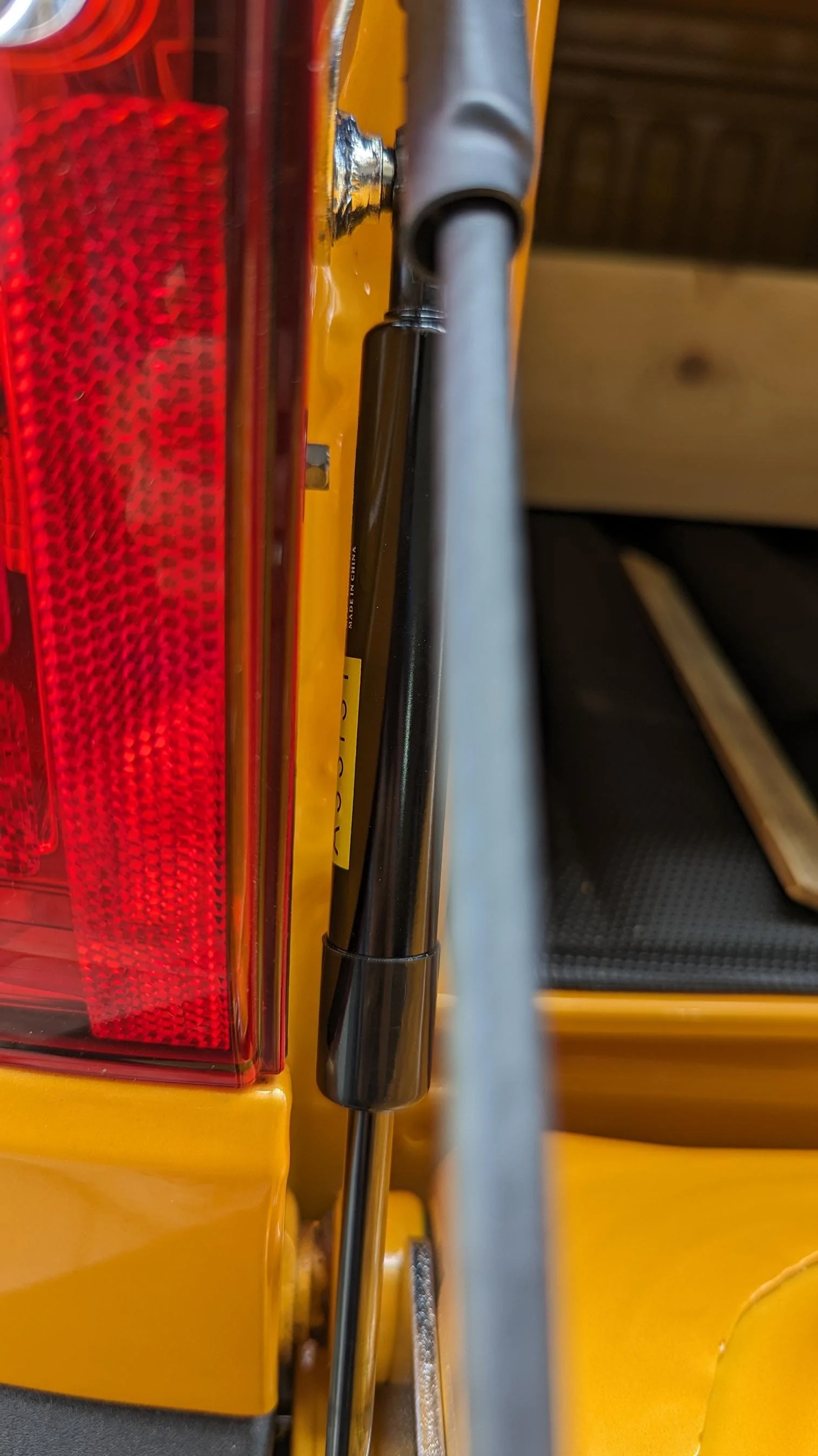

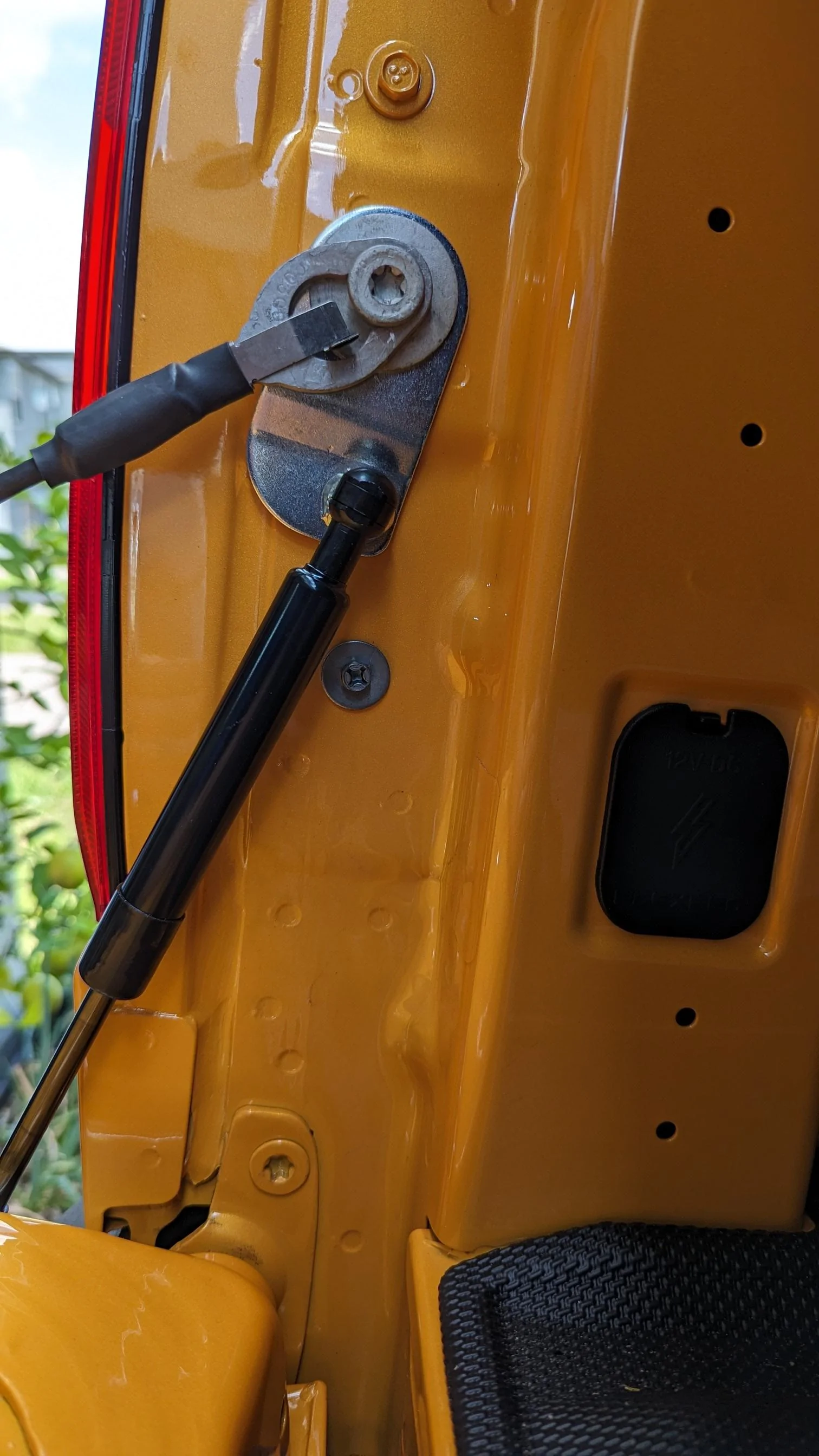

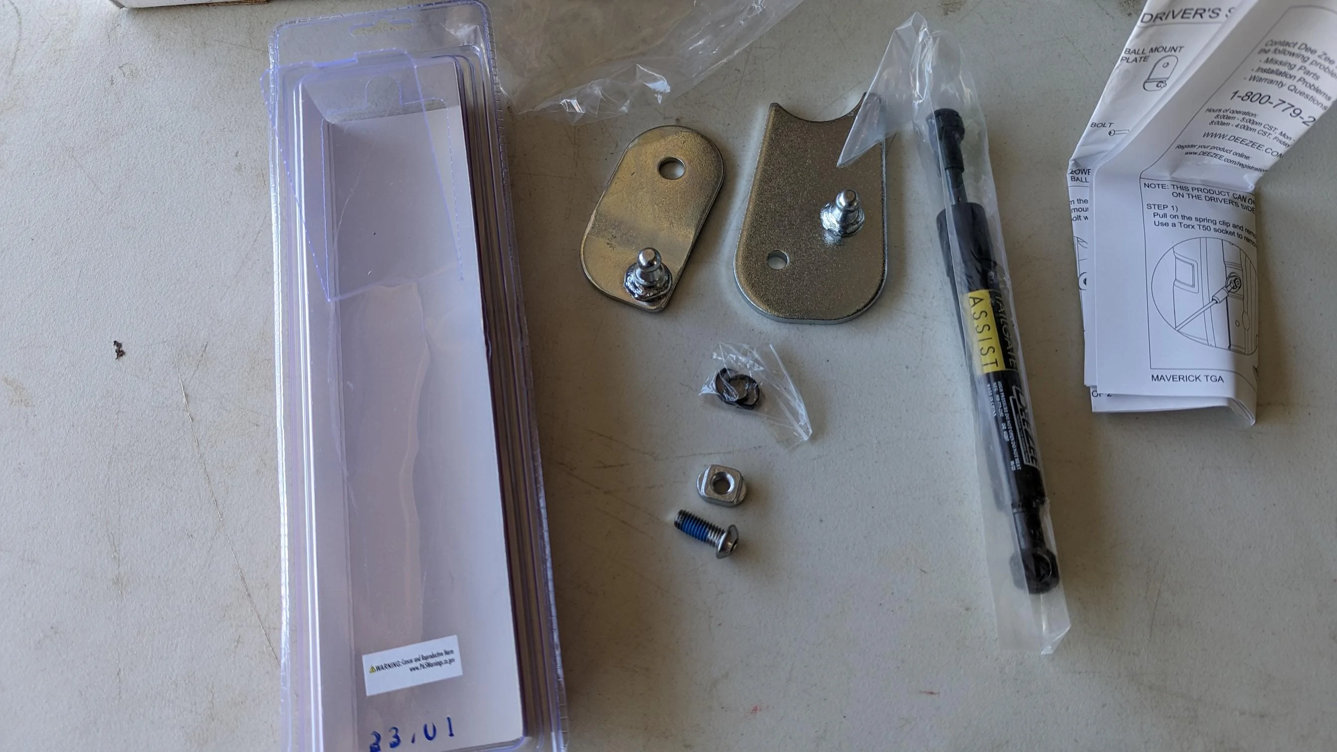

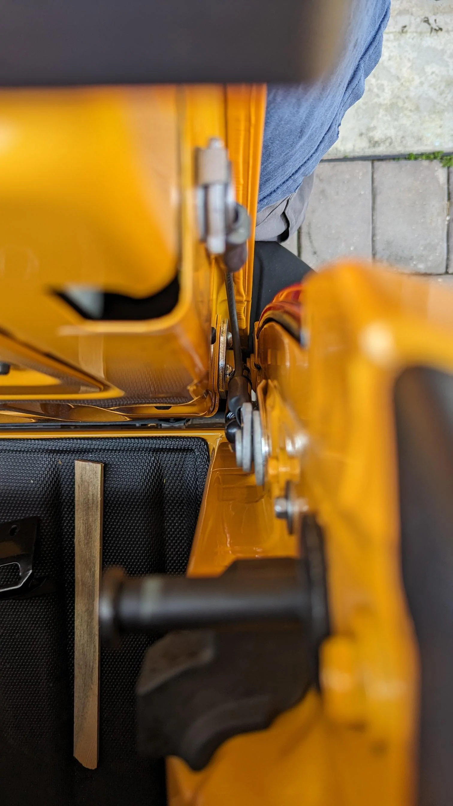

Leaving this here for any who come looking,
Firstly thank you to everyone who posted before and dealt with early issues so we could be aware of what to look for. That being said I had none of them..
- my package was brandy new from Amazon and stamped "23/01” so maybe manufactured this year with improvements?
- the tail light screw does not rub against the strut. See pictures. I actually left the upper bracket, which attached to the truck body, a little loose to see what position it fell into naturally when working the assembly, and tightened it down afterwards.. it rested at a slight angle, as shown in the pics so I left it that way..
- my strut is installed with the body upwards and the arm on the bottom, as shown in instructions
- the heat shrink portion of the tailgate cable does not seem to be rubbing against either and seems to collapse to a suitable position
So perhaps deezee fixed their issues!
The cable heatshrink has sustained more damage due to the rubbing against the strut. I recently removed the strut because I was hauling a long item and needed the extra tie down on the tailgate. I may reinstall the the strut and see if I can do something to eliminate the rubbing. I’m glad that you are not having any issues with yours.

A shot in the dark: (pun intended huuur) I inadvertently installed the upper bracket at a tilt (not exactly vertical).. perhaps by doing so, the cable rests in line with the strut head and is not encouraged to fall past/overlap/rub against it..
Good tip. I’ll give that a try. Thank you.(y)
