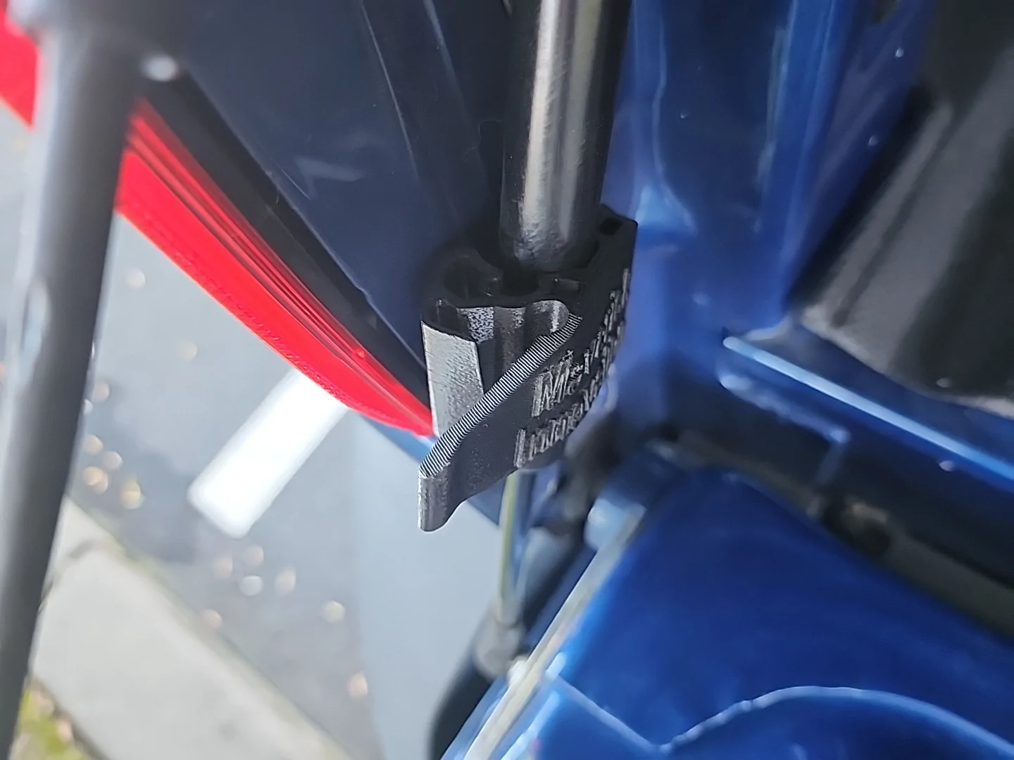

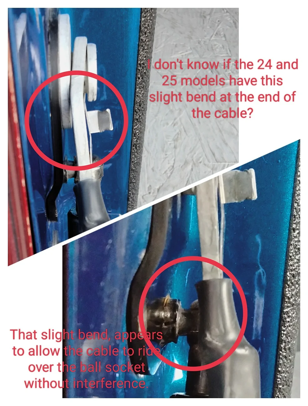

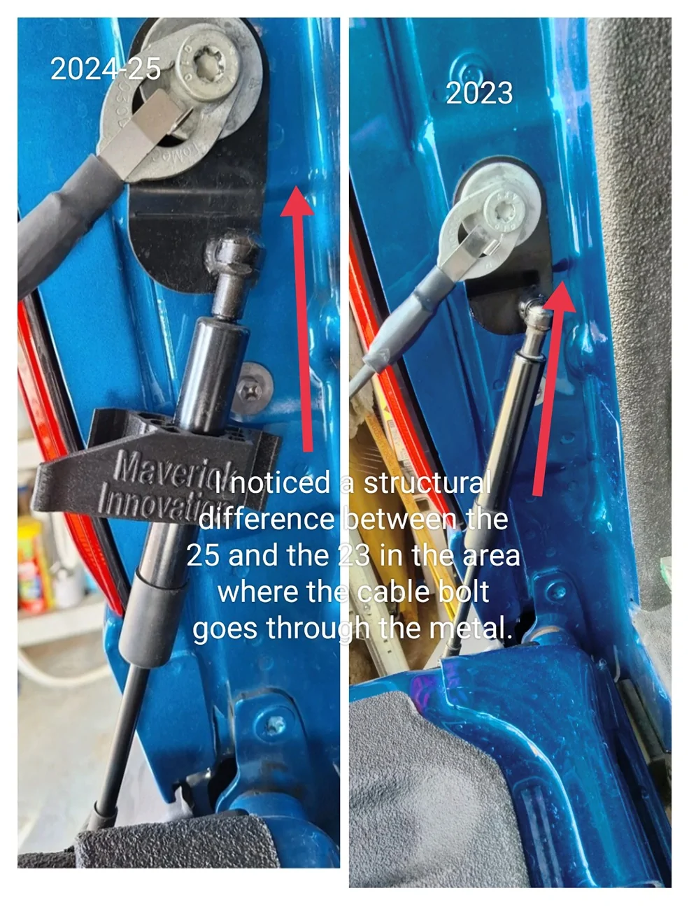

The attaching end of my23 cable has a small bend in it.

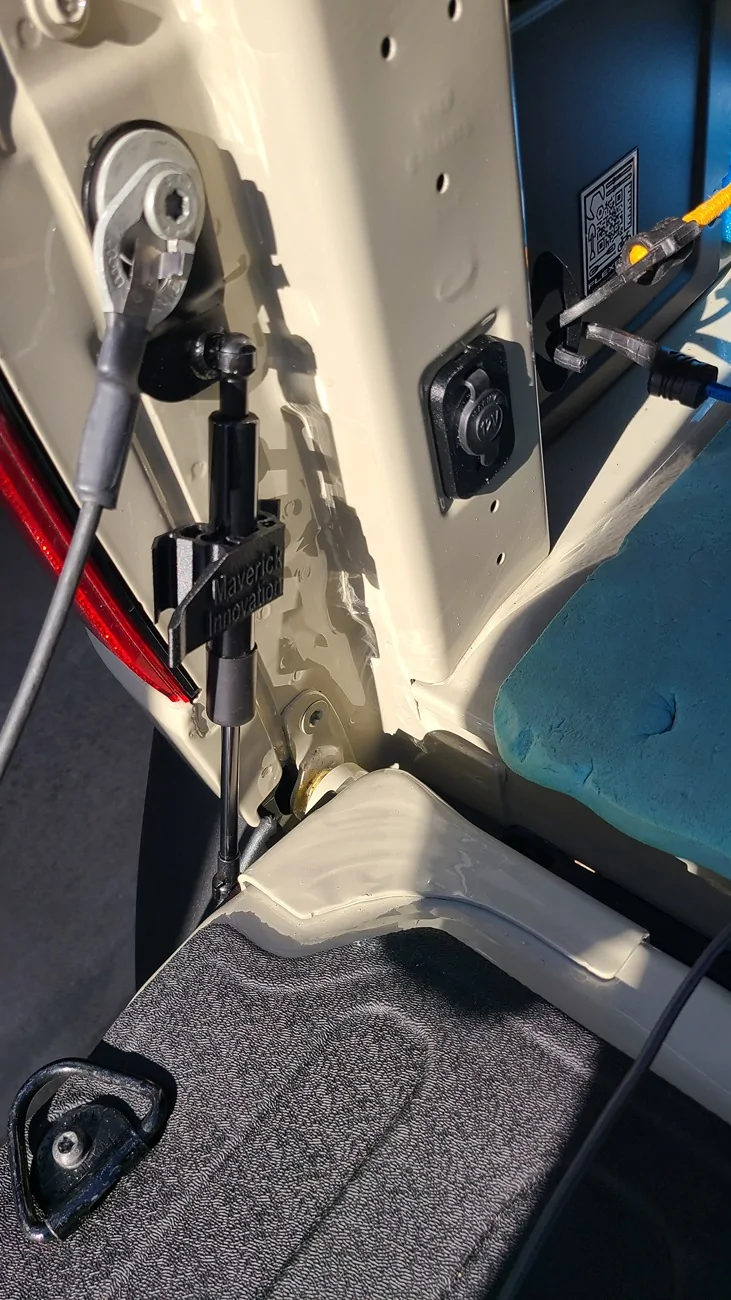

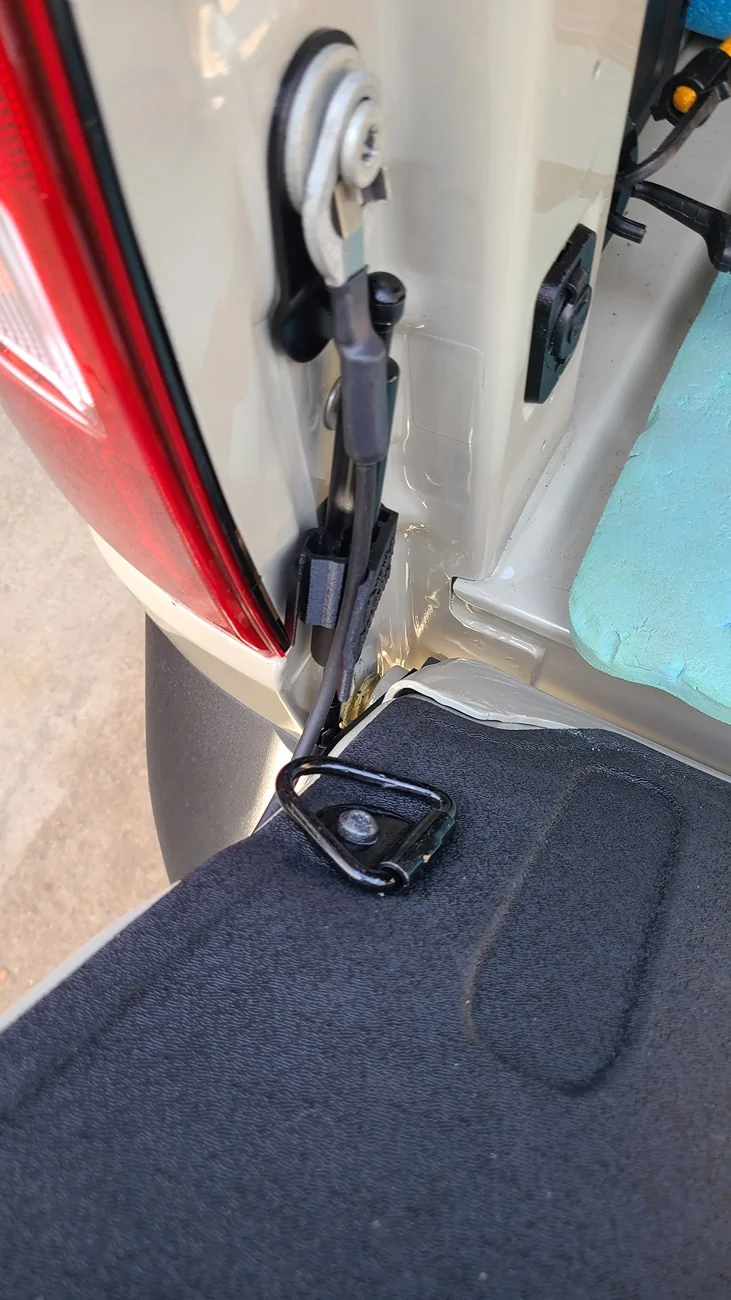

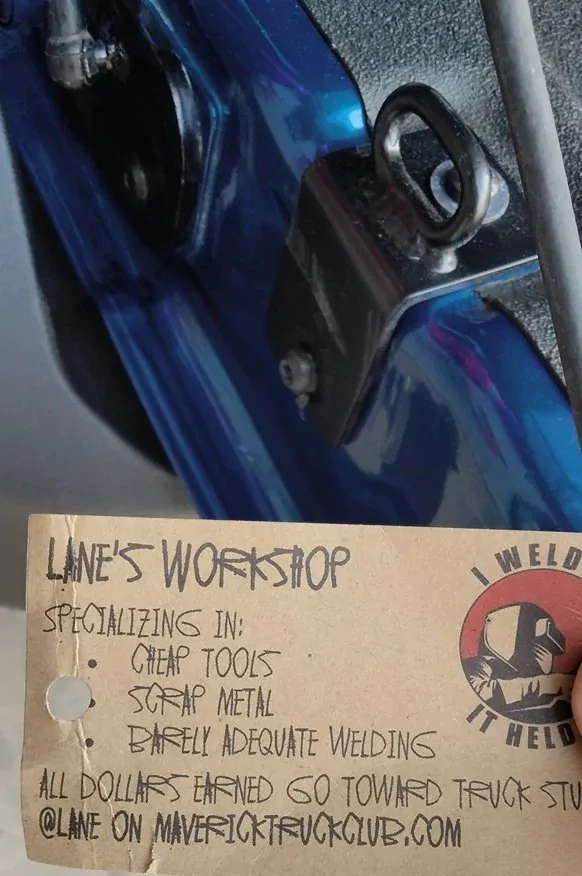

Rick I replaced the driver side tie down with one made from one of our members.
Ford Maverick Tailgate Assist Strut - Binding with the tailgate cable 0001
That's me (thanks Glen!). Yes, when you install the tailgate strut and remove the factory tie-down bracket which now interferes with the strut, you lose a useful tie-down point. I made a replacement tie-down for mine.
Ford Maverick Tailgate Assist Strut - Binding with the tailgate cable 236269-5d38332d1e5f7e8761f1030b274d31c5
Works well and clears the new strut and no issues with the cable. Enjoyed making it enough that I keep making more. I have a thread here in the For Sale forum if anyone would like one. Don't lose a tie-down point!

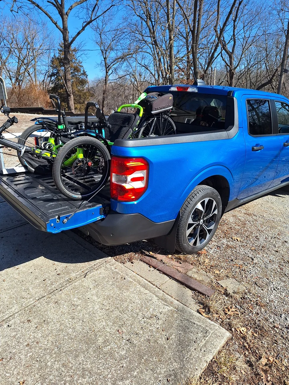

Yes caused by leaving my tailgate down going over rough roads with my Catrike.

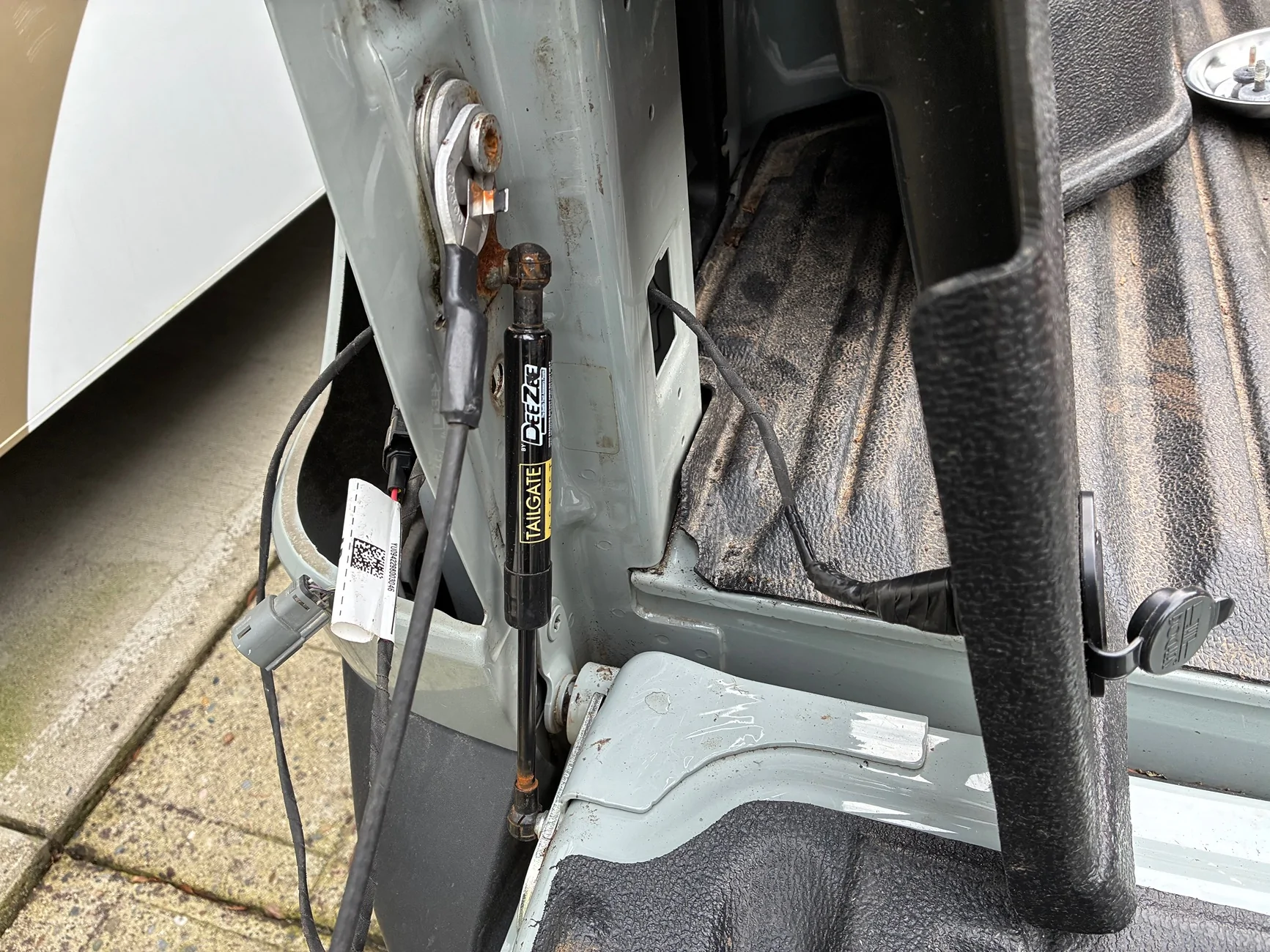

I installed a tailgate assist strut, following the instruction video - but the tailgate cable binds on opening and closing. Did I do something wrong? I considered just removing the cable, but wanted to see if there are others who've had and overcome this issue?
Try this out
https://www.etsy.com/listing/1817791225/tailgate-cable-guide-for-ford-maverick
It works great!
Ford Maverick Tailgate Assist Strut - Binding with the tailgate cable 20250104_112844
Ford Maverick Tailgate Assist Strut - Binding with the tailgate cable 20250104_112739

I had that problem. It was because the plate the strut attaches to rotates, moving the connecting point of the strut. The cable can then move behind the strut when the tailgate is closed.
Solution was loosen the bolt holding the plate, rotate the plate so it's vertical, and then you have to really crank down on the bolt so the plate doesn't rotate again.
I had the same issue and was able to fix it the same way.

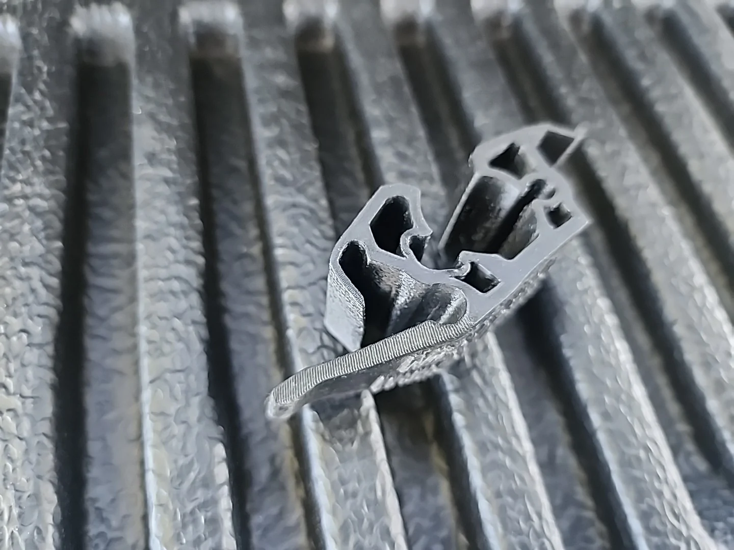

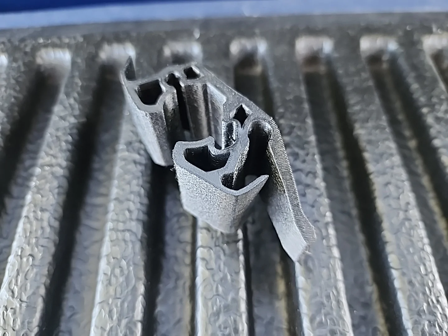

Anyone have issues with the Tailgate Cable Guide deforming? It was great new but now it pops off the the strut all the time.
Ford Maverick Tailgate Assist Strut - Binding with the tailgate cable IMG_20260610_114032
Ford Maverick Tailgate Assist Strut - Binding with the tailgate cable IMG_20260610_114025
Ford Maverick Tailgate Assist Strut - Binding with the tailgate cable IMG_20260610_114006
