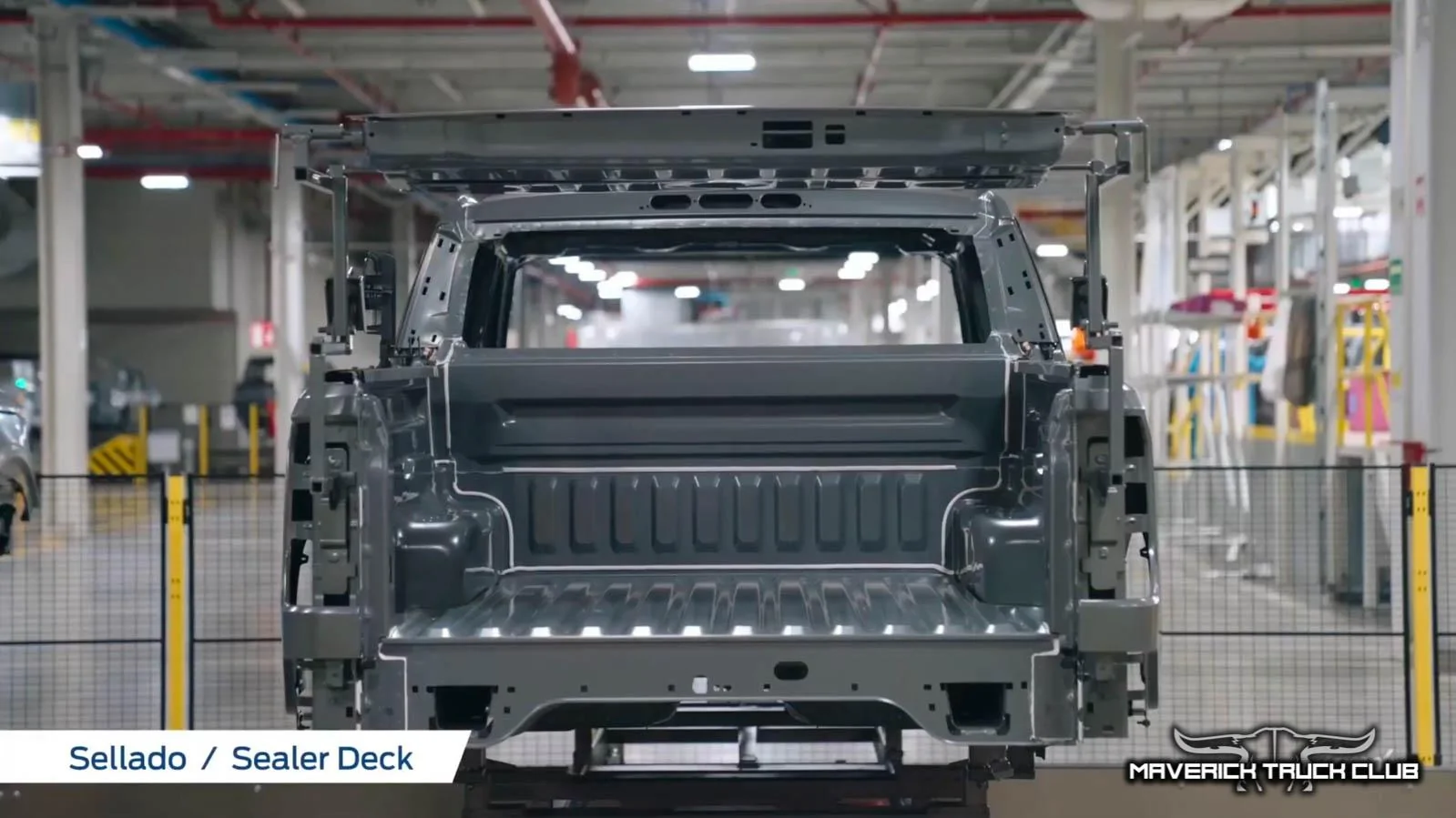

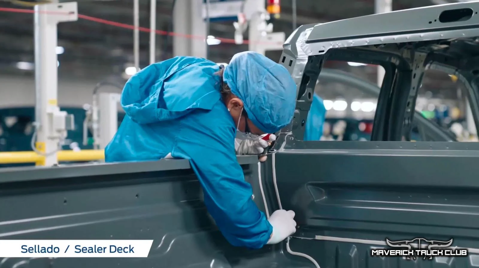

I wonder if the is is a case where they are painting over a seam sealer and it’s not as heating properly.
I went out to look at mine, just purchased yesterday. It's definitely a form of seam sealer. On the drivers side mine had what appeared to be a little excess at the joint. I pushed on it lightly and the paint had "give" to it. What I'm believing this to be is the production line is applying the seam sealer and it has not fully cured before the paint is applied and the resulting continuation of sealer curing creates some outgassing which creates a "bubble" of paint. Apparently the OP's truck had the paint in that area come off entirely.

If you check out slide 17 of product assembly line processes in today's News section, I think you'll see the worker installing sealant in area described by some owners.
