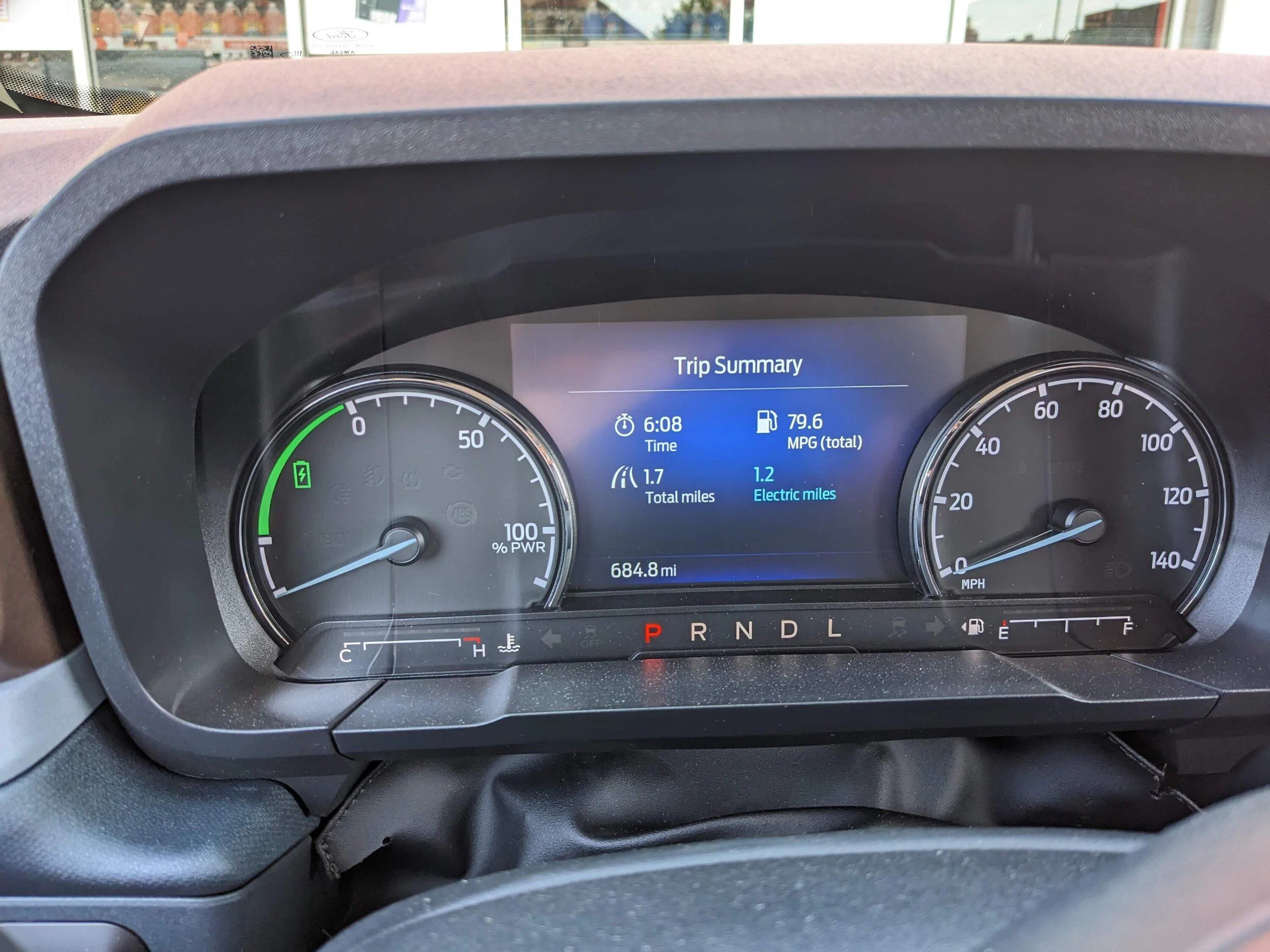

It's a dash display setting you can turn on that shows when the vehicle is operating in electric, hybrid or regeneration mode, and has a dynamic bar graph display to act as a coach. My wife has fun trying to make sure she stays in the blue electric zone as much as possible, and has learned how to read the regen bar to make sure she always gets to 100% on the brake coach.
100% correct. did u have to talk her into paying attention to the EV coach or was it her idea? i have yet to convince my Darling Bride to give a flying you know what about that kind of stuff, sigh.
i'm sorta okay with it because she does have MANY other redeeming qualities that more than compensate.
but back to the topic at hand, the EV coach is my main instrument cluster display some 90% of the time when i'm behind the wheel.
my next task is to understand the power meter gage thats where a Tach usually goes. i'd like to believe that the Mav design team didnt give such a large & prominent piece of IP real estate to this gage without a good reason (i hope)., or maybe it was just put there for cosmetic reasons?( i sure hope not). i may be the dull knife in the drawer but Ford's explanation o
Ford Maverick 38,000 mile summary. BEWARE: ISSUES GALORE! PXL_20230510_195447814
f this gage and what information it's trying to convey seems somewhat opaque to me.
