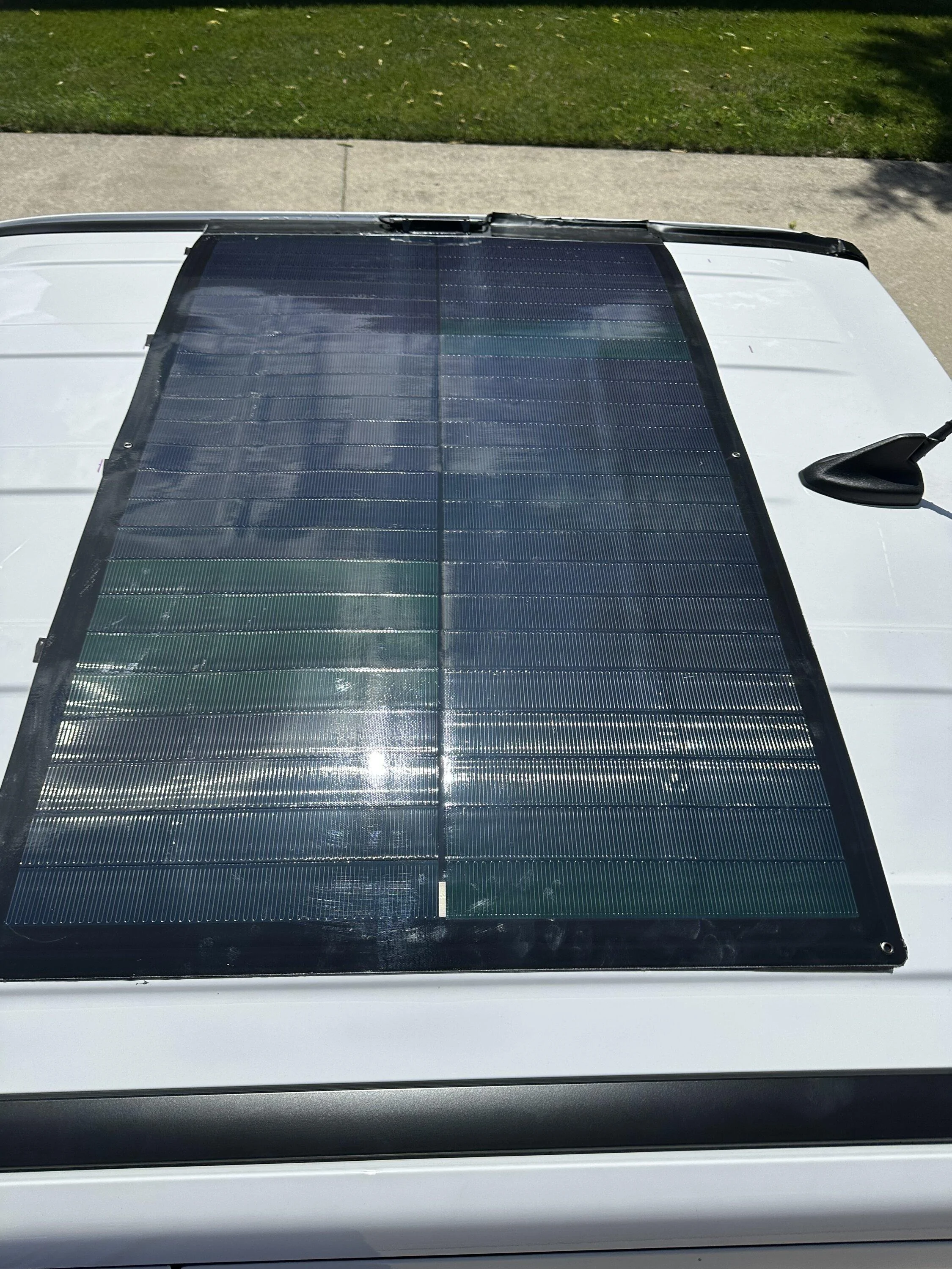

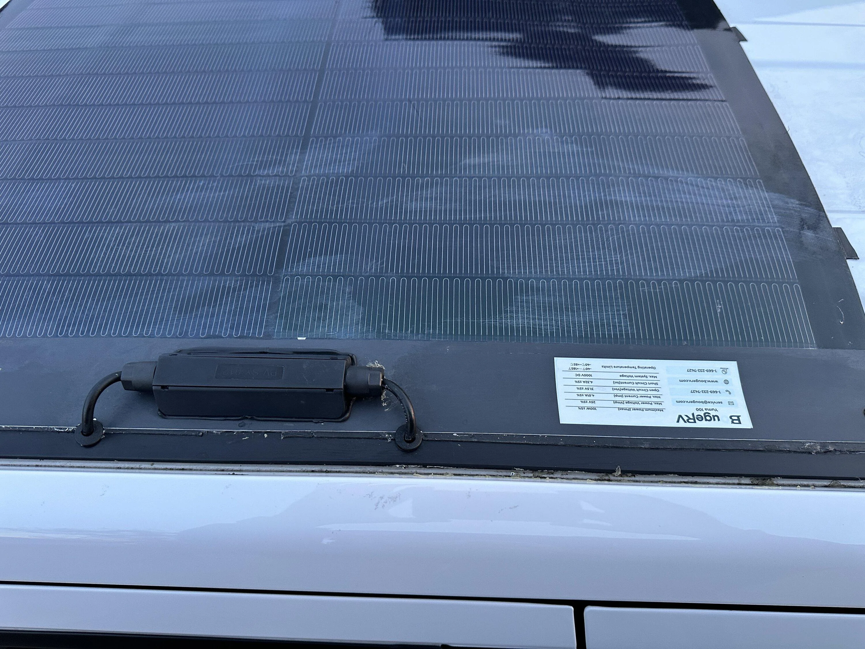

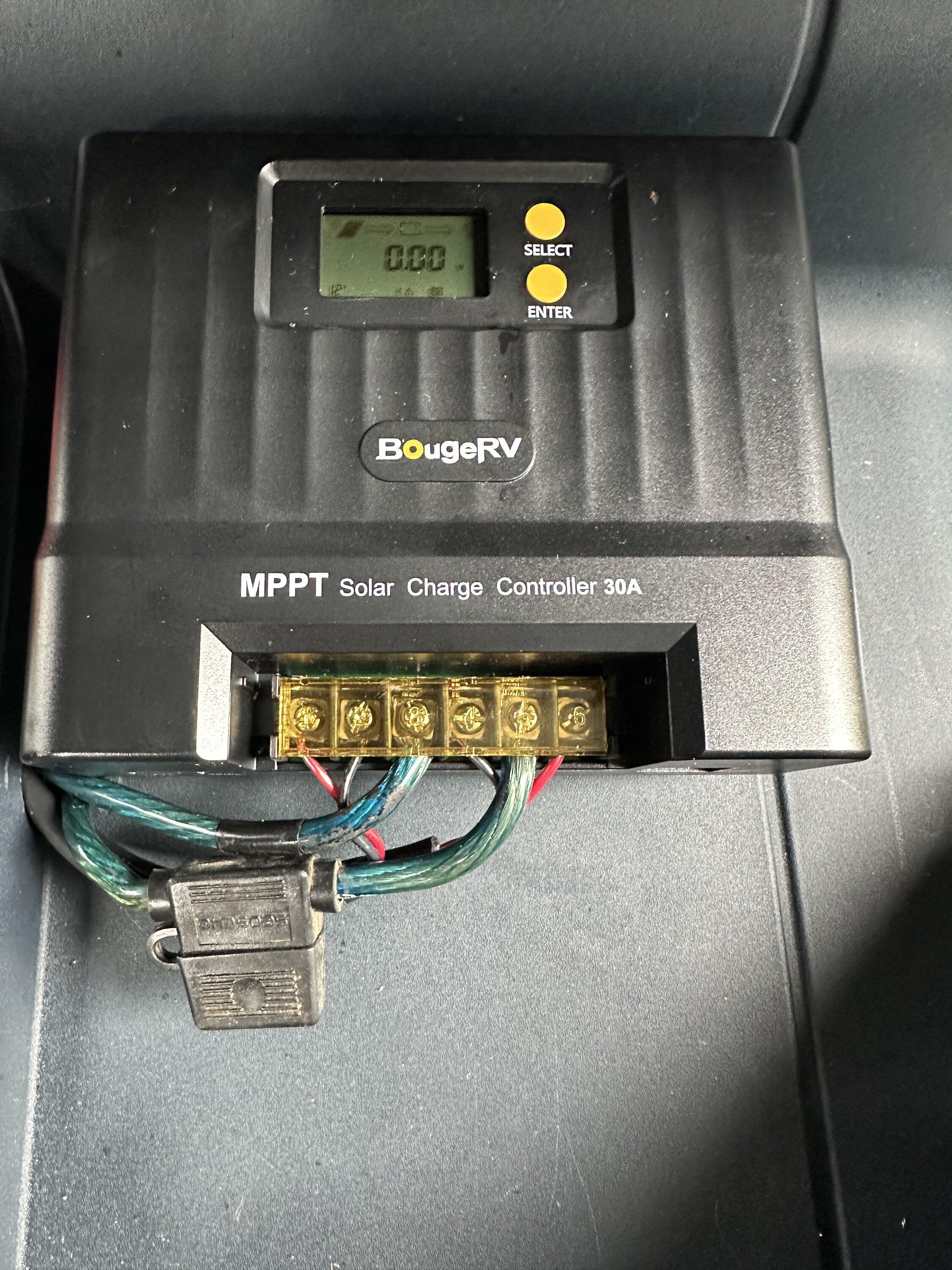

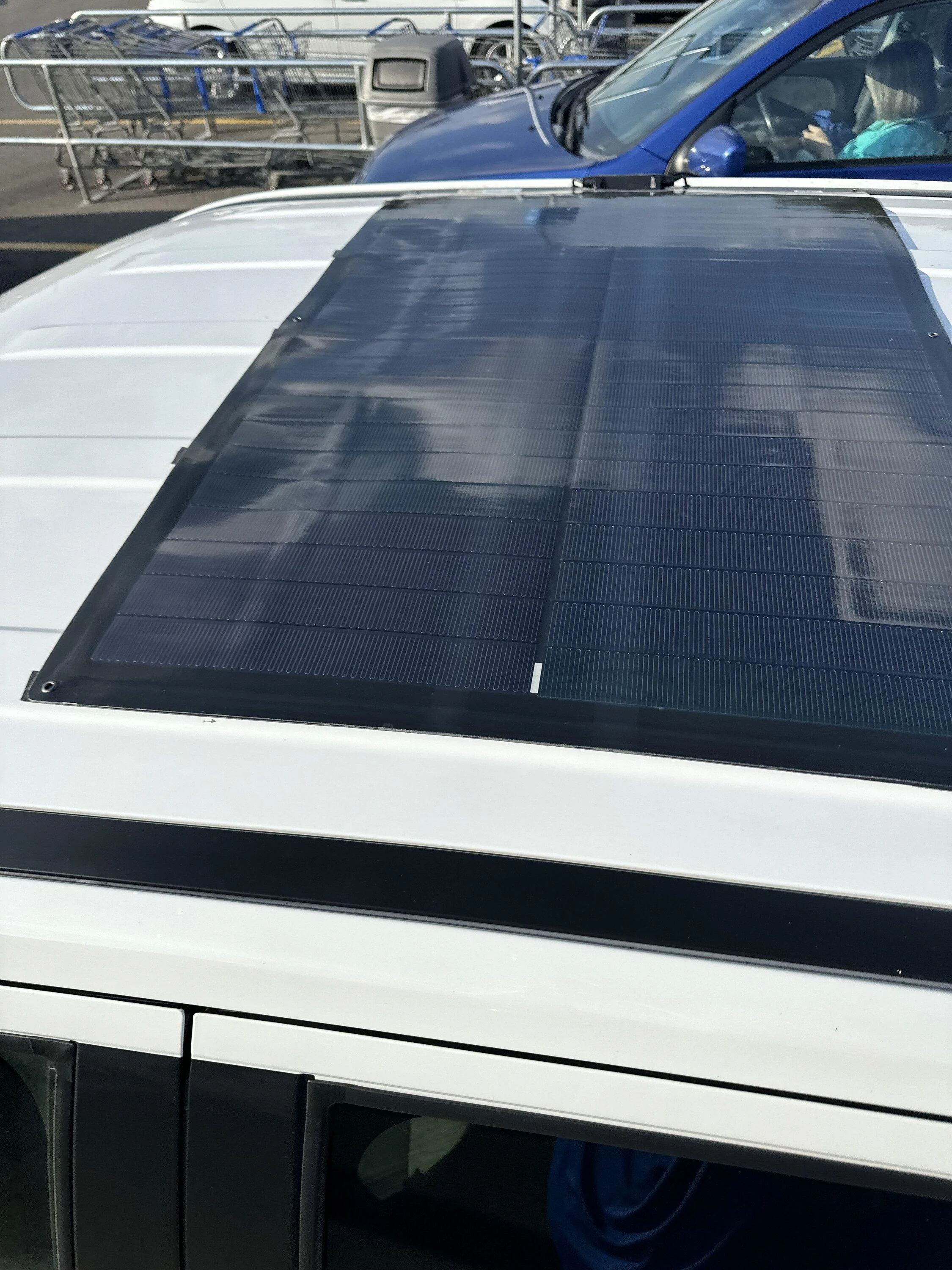

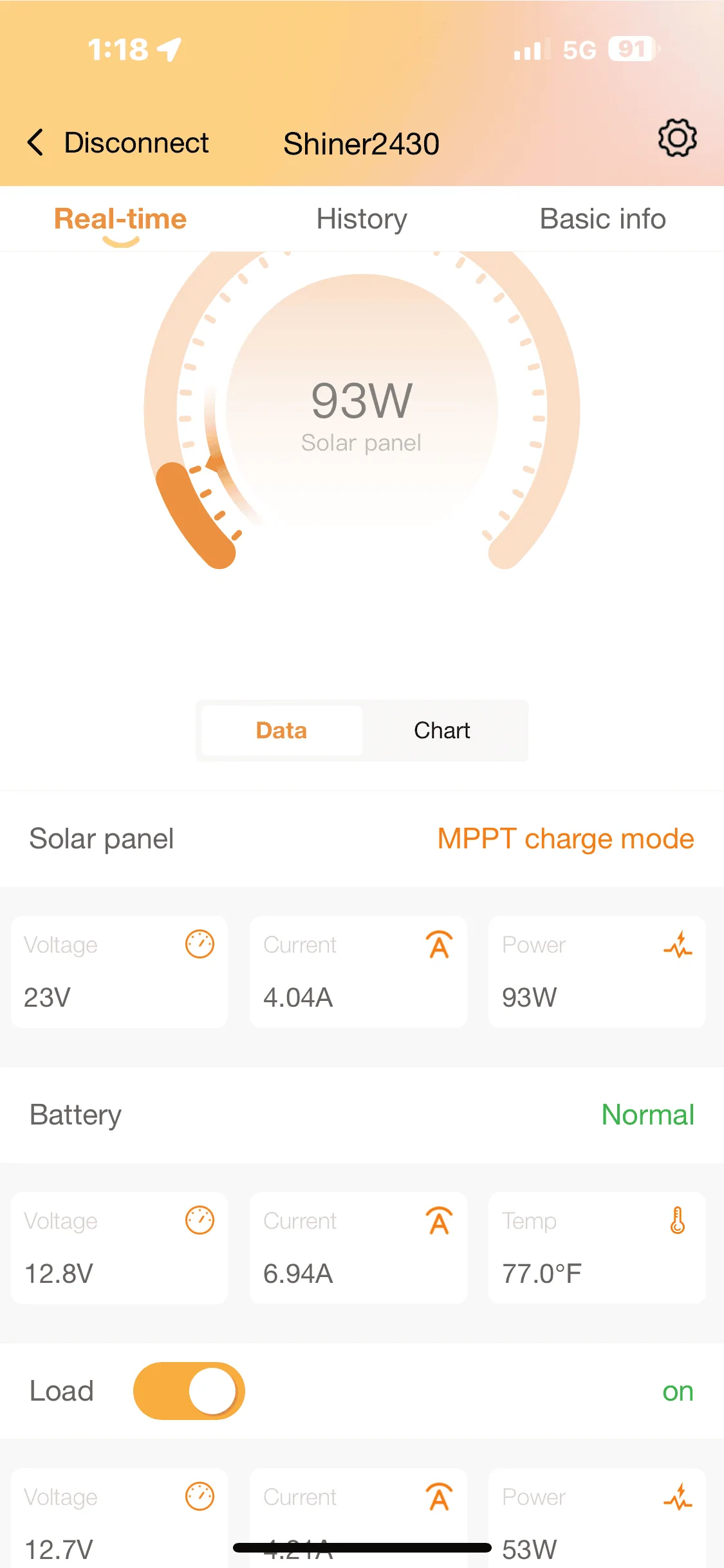

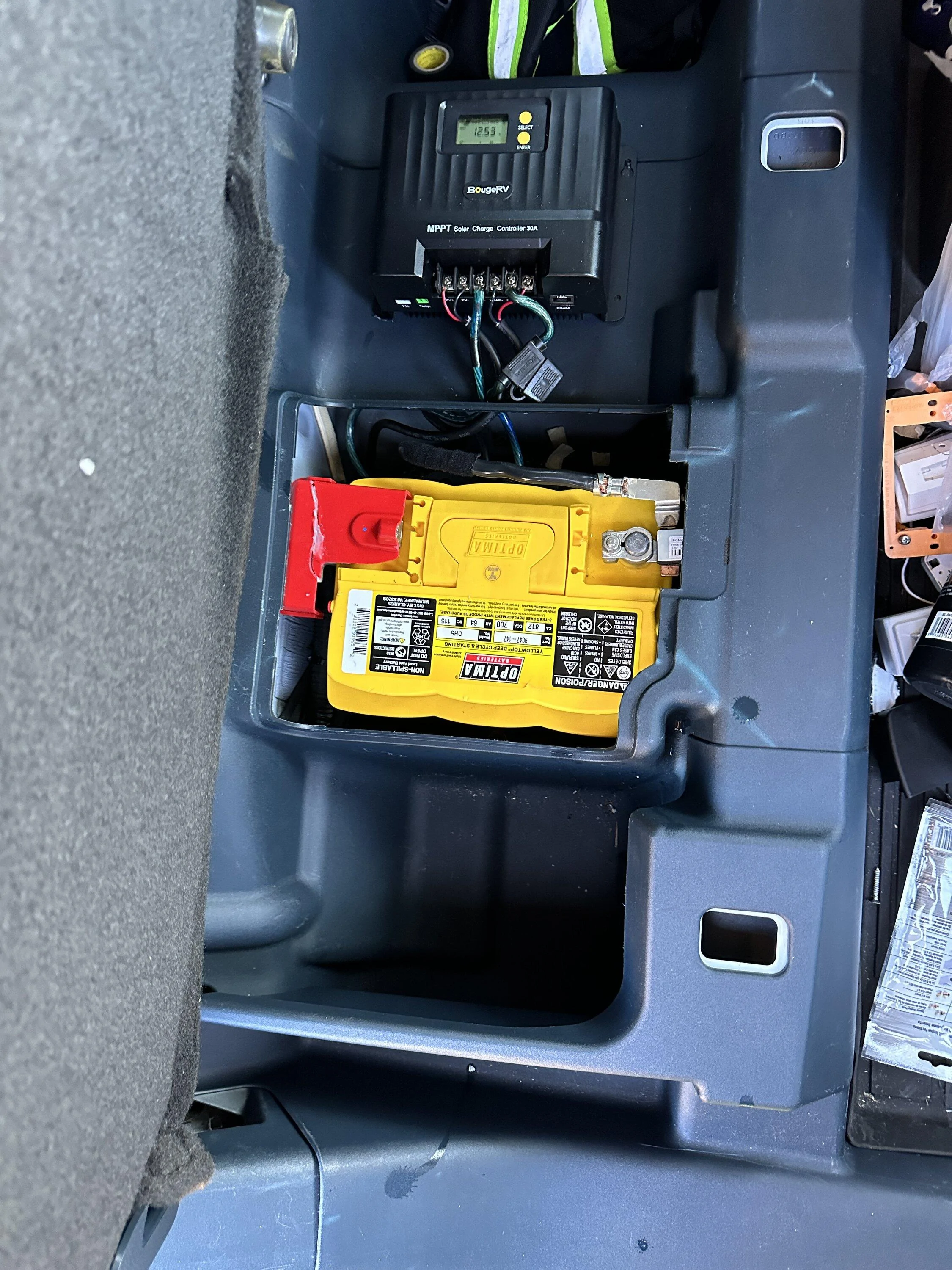

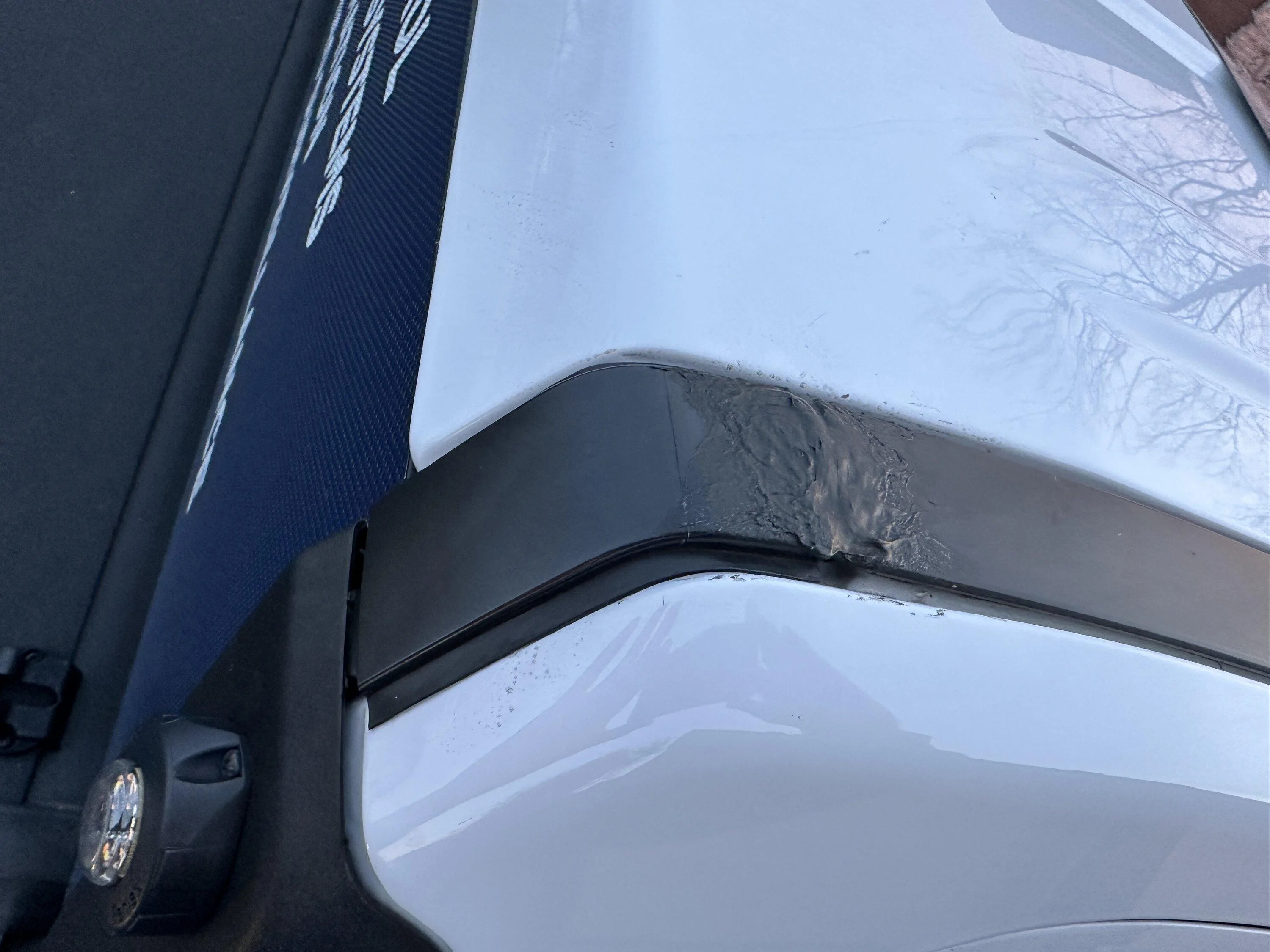

I have solar on my 23 hybrid. It’s only for the 12 volt battery tho as I have strobe lights running and it almost will keep the battery fully charged while they are running. I mounted a BOUGE RV CIG panel to the roof using 3M black hi bond tape. Was going to mount it to the BAK cover , but was too stiff to roll up with it. Been thru plenty of car washes with no issues. I had to snap off the rear corner roof rail and epoxy it back to make room for the wires. The channel is hollow until it gets about an inch away from the corner. I’m using a BOUGE RV solar control to do the charging. The CIG panel is super thin and flexible. Doesn’t care which way it points either. Can also be partially shaded with minimum effect. Getting around 7 amps out on a summer day , less during the winter. Also had to upgrade my 12 volt battery to an optima yellow top DH5. This all started with the deep sleep and couldn’t run my strobes over 10 minutes before the battery choked. I do have battery protect circuit so I don’t kill the battery with my lights running. The DH5 fixed my deep sleep and I can run the strobes all day without issues.
