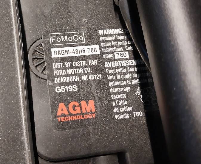

My Mav has the same battery, that It came with. (Build date: 10/31/2022).
I took a look and photo of it, just a while ago....
This is what the Part Number is... BAGM-48H6-760..
So, He came WITH a AGM-type Battery.. Is this a GOOD THING? (y)
Also, I looked up my VIN, NO Recall for Battery listed...
??Maybe My Mav is actually a MY23?? :unsure:
Jerry
You have an AGM battery so your battery is not subject to the recall. The start date of MY 23 was 11/14/2022 so you have one of the last MY22 built by Ford. From my understanding, Ford started placing AGM batteries in the Mavericks sometime in October 2022.

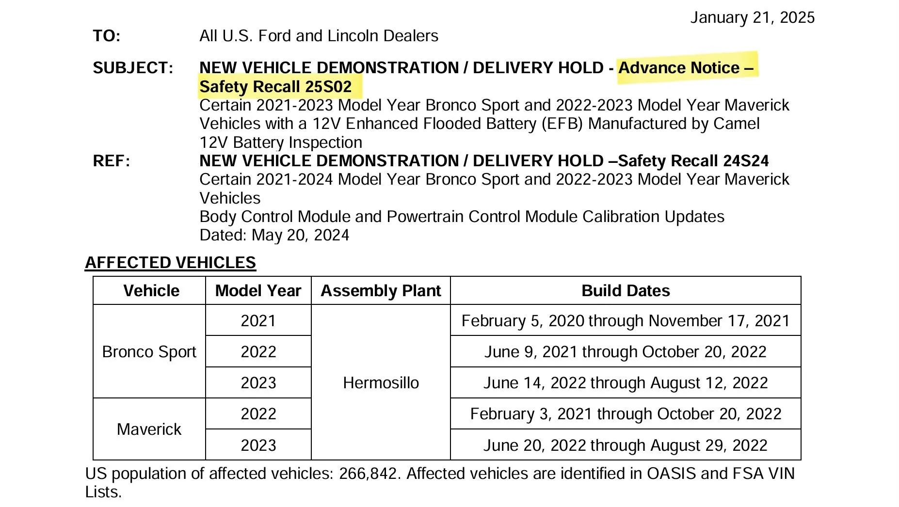

Ford switched to installing only AGMs in the EcoBoosts.
Darnon
Jul 4, 2021
5,723
7,234
WNY
Also I noticed that while '23s are listed as being affected, they technically aren't. The notice to dealers outlines the affected build dates of the 23MY units as June 20, 2022 through August 29, 2022. 23MY retail production didn't start until mid-November so those were all manufacturer-intended vehicles (probably a lot of demo Tremors).

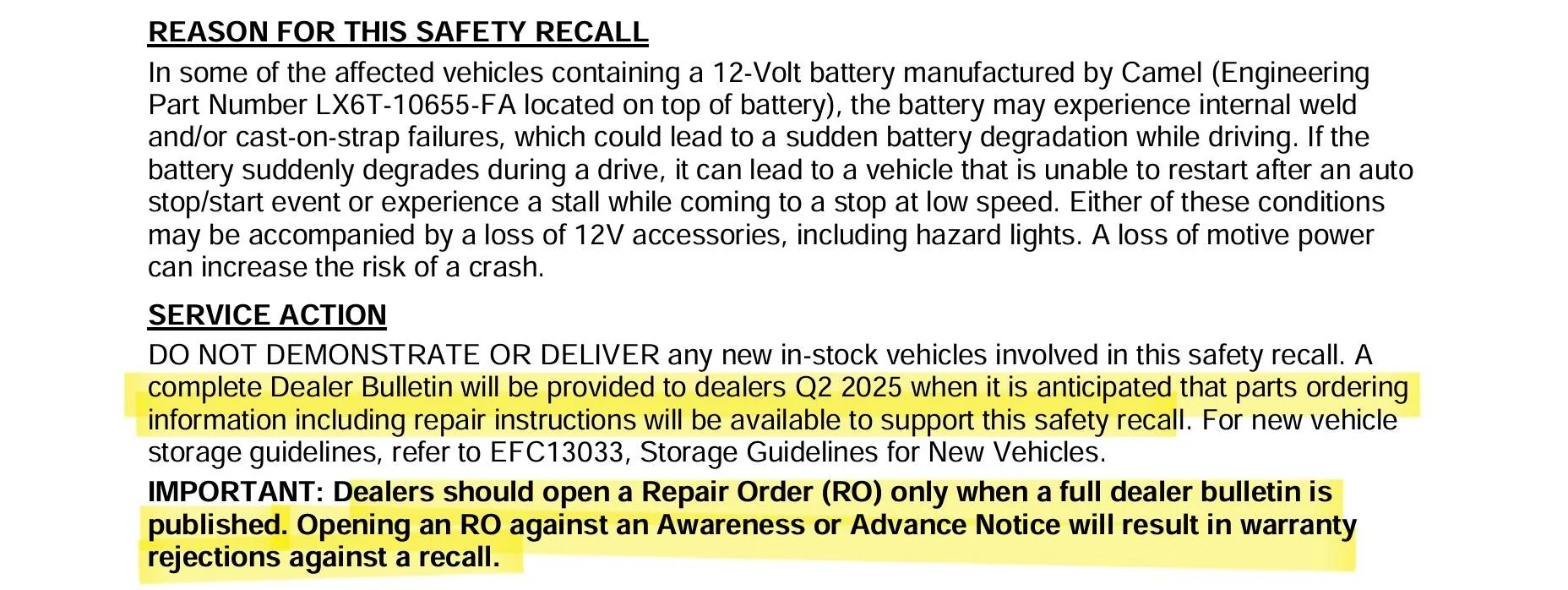

I probably shouldn't do this but I will post some screenshots of the recall as it reads so far. This is still an advance notice of the recall. Ford has not sent out letters to anyone yet (according to the notice). They do have the list of VINs so you may be able to put your VIN into the recall website and it could show whether yours is included. I'm not sure if that's true or not. But no repair orders can be started yet. Also, it doesn't say that it is for only EcoBoost engine. In fact, if it was they will usually include that information. I've seen many recall notices, I cover them every week on my livestream.
Ford Maverick Recall: 25S02 12V BATTERY INSPECTION 1000021062
Ford Maverick Recall: 25S02 12V BATTERY INSPECTION 1000021064
