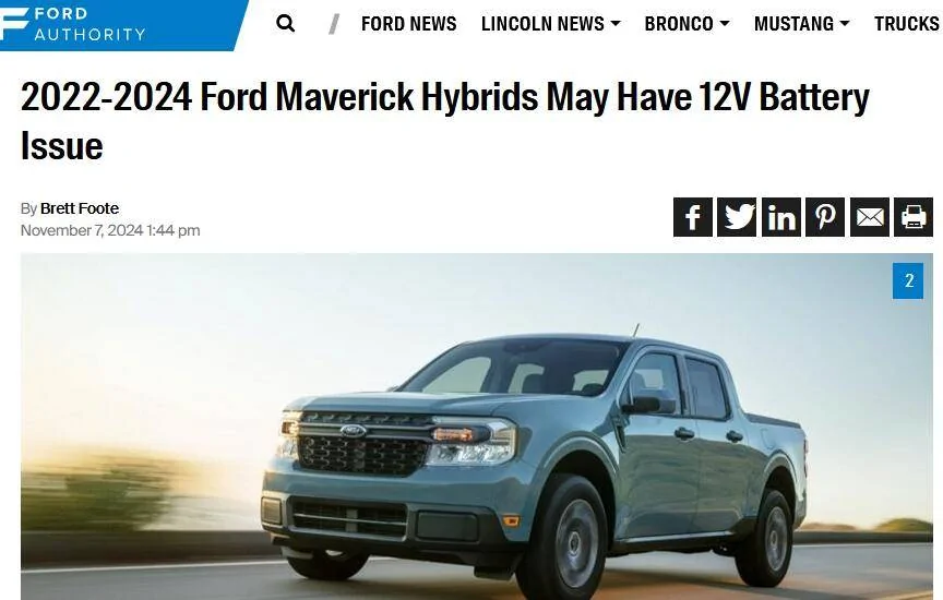

Respectfully, how is this not a HYBRID thing? States Hybrid specifically in the article.
Sorry - misunderstanding.
The Recall this thread is about is not a hybrid thing. EB specific.
There was a past recall about the same issue too. EB specific.
There is no recall for hybrids regarding batteries yet. Unlikely to be because the hybrid issue prevents starting and driving - the ultimate safety!
