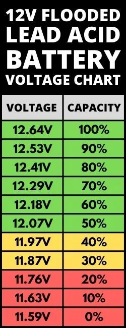

This is NOT just a problem with a cheap battery - there is a problem with the charging system, that's ruining the battery. If you Google at what voltage are lead acid batteries damaged, it says less than 80% capacity (12.4V). Repeatedly starting at voltages lower than that is hard on the battery. There really should be a battery voltage reading on the instrument cluster display.
I'm hoping there's a software update to fix the charging problem, AND that I get a free battery out of the deal.

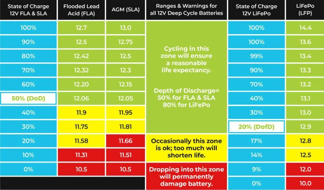

You're actually safe staying above 50% charge with lead acid batteries. But, all lead acid batteries need to be charged to 100% SoC on occasion to get full life out of them.
Here's a more accurate table with AGM and FLA SoC voltage levels:
Here's a more accurate graph with AGM and FLA SoC voltage levels:
great reference.
also, deep sleep kicks in at 12.0v *or* if the rate of discharge is too high.

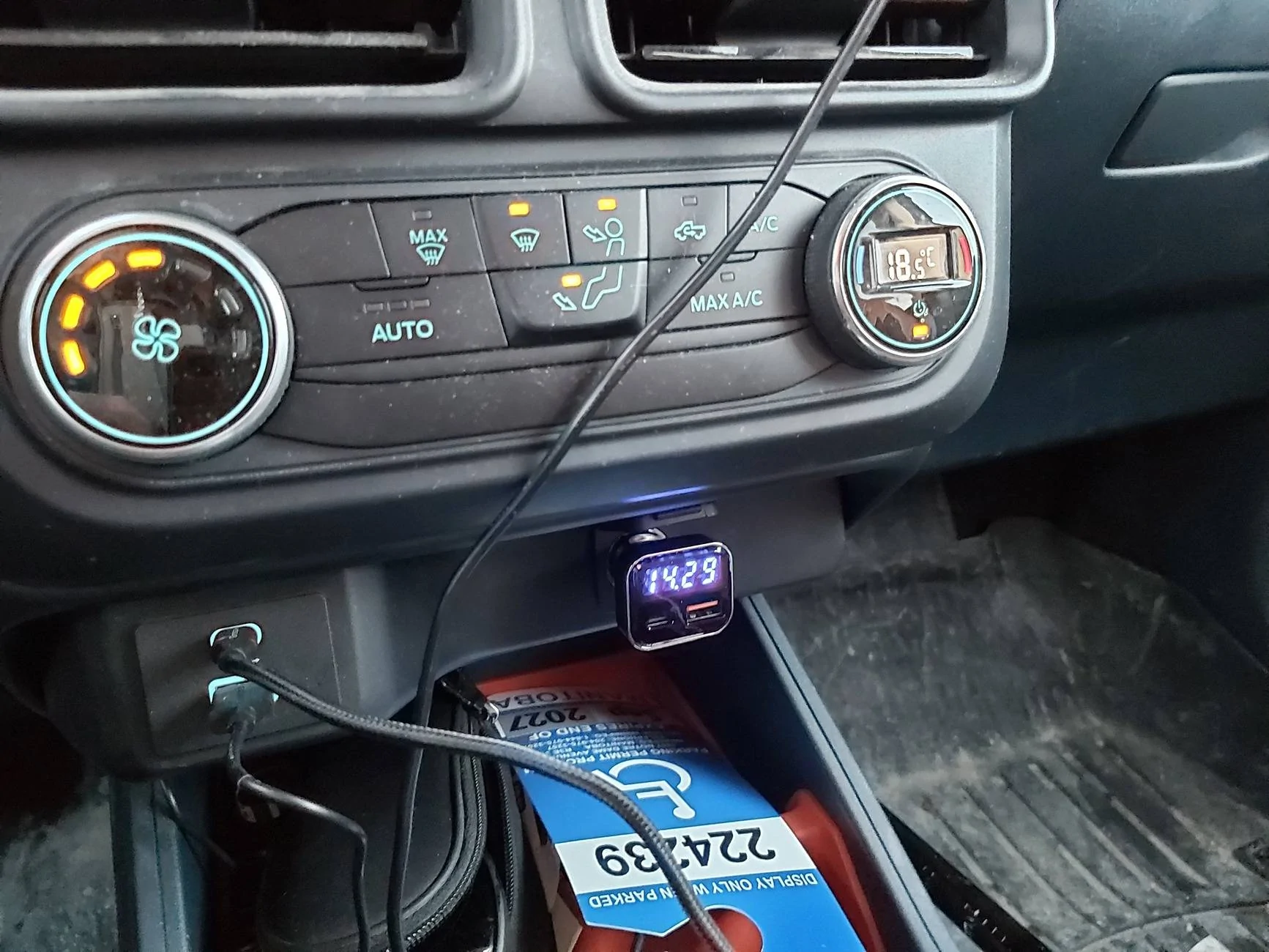

Thnx for sharing that! Life has been better since swapping out the cheap Chinese Camel battery. I bought a cigarette socket USB charger, with voltmeter, am much better able to monitor battery voltage.
The capacity on that Camel battery just faded away. I have the routers turned off, pulled the fuse for the telematics router to stop that battery drain too.

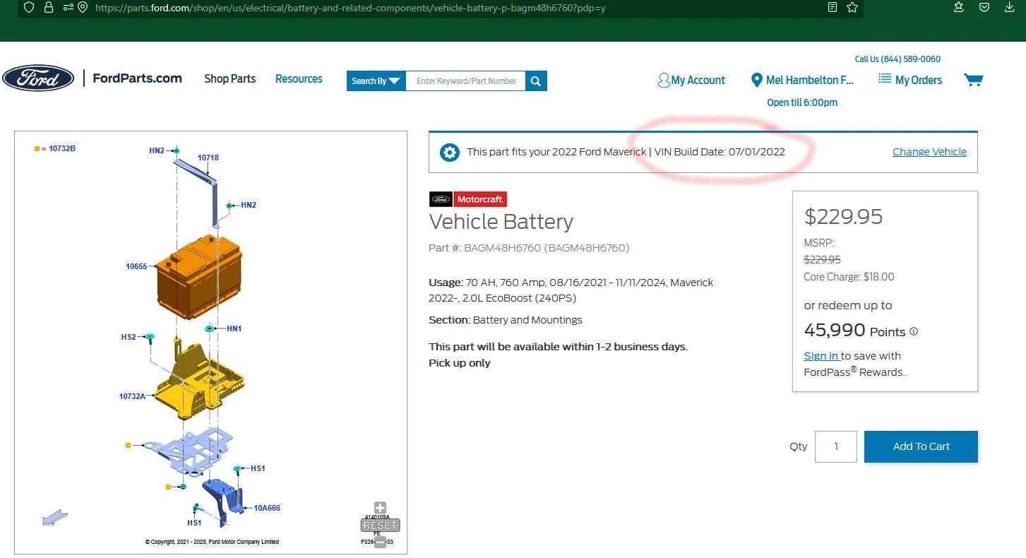

you don't need to for this recall. the scope of this recall is that if your ecoboost original equipment battery is an enhanced flooded battery, it's getting replaced with an agm.
however, since you asked:
go to parts.ford.com and search by vin and type 'battery' in the parts search box. you'll get this. (the EF battery is no longer even listed as a valid part for the ecoboost, only the AGM battery is listed now.)
