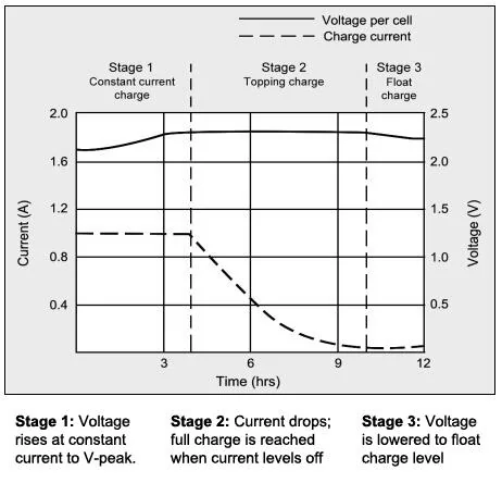

You are correct - driving doesn't change anything that I've ever recorded, compared to just sitting with HVB recharging.
The 15 V is fooling the figures though.
Actual charge rate starts at around 10 A charge to the battery for some seconds, down to 5-6 A for perhaps a minute, then drops 2-3 A for another min or minutes depending on where SOC is, then down to 1 A or below afterwards.
I had several short trips Fri night, with truck off for minutes at a time, and got the SOC up there better than I'd get with a straight drive home, and it was starting at 10 A with the quick drops each time. Compared to I've noticed sitting in driveway waiting, then a turn off, wait 30 seconds, and turn back on - does not fool the system, it went back to 1 A or less charging rate.
So you've got the following going on basically. Except the logic for how long each charge rate should last seems to be Ford's weird screwed up method. Those figures x 6 for cells.
This is what the EB system is attempting too.
https://batteryuniversity.com/article/bu-403-charging-lead-acid
