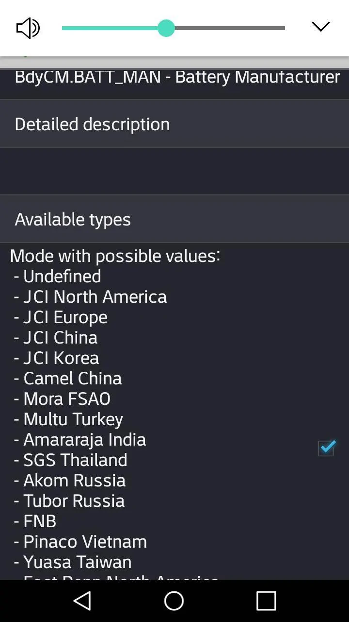

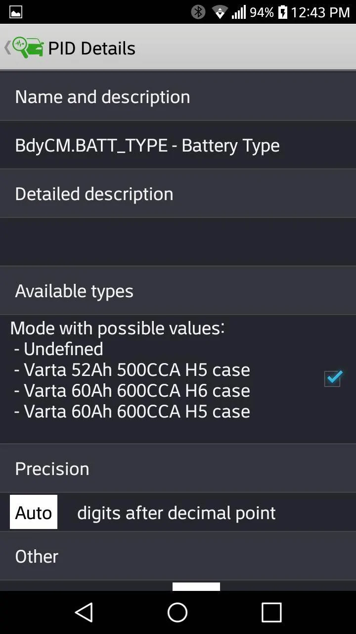

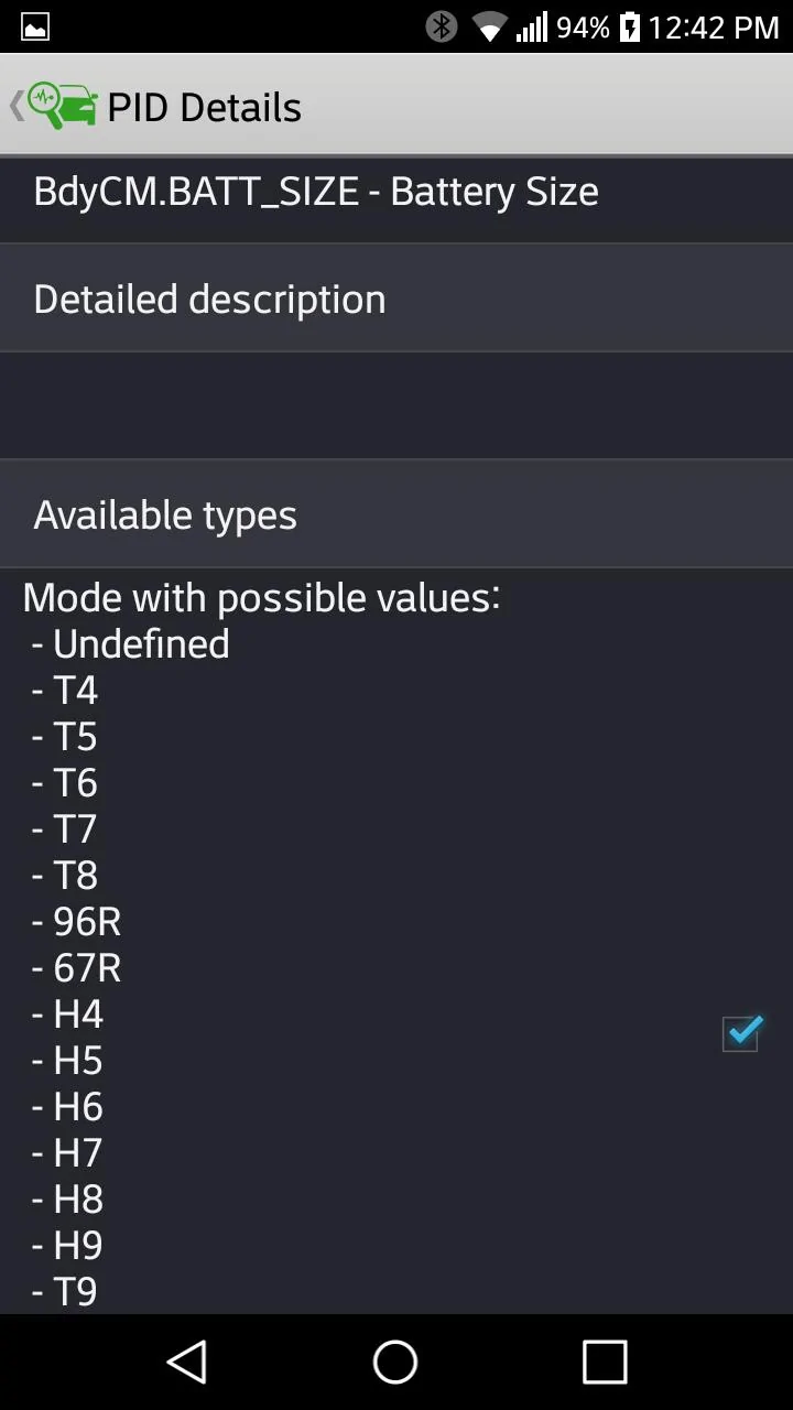

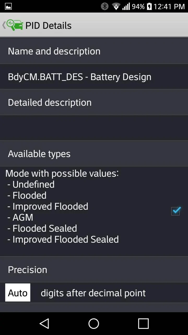

HeyBales
May 3, 2024
4,949
4,550
KC Metro area
HeyBales
May 3, 2024
4,949
4,550
KC Metro area
If you have the PID before you changed the type to AGM also check to see if anything was changed in the PID. From what I've read on other site there are code (maybe even in different PID?) for battery sub types. (Not all AGM have exactly the same charging parameters though differences would be close).
From these that appear to be unused - I'm guessing not actually used .... yet?
The checkbox isn't on an option - merely showing the options can be checked and happens to rest in middle of list. Compared to other PIDs like "Fault in PTC" shows Yes & No to be displayed but no check.

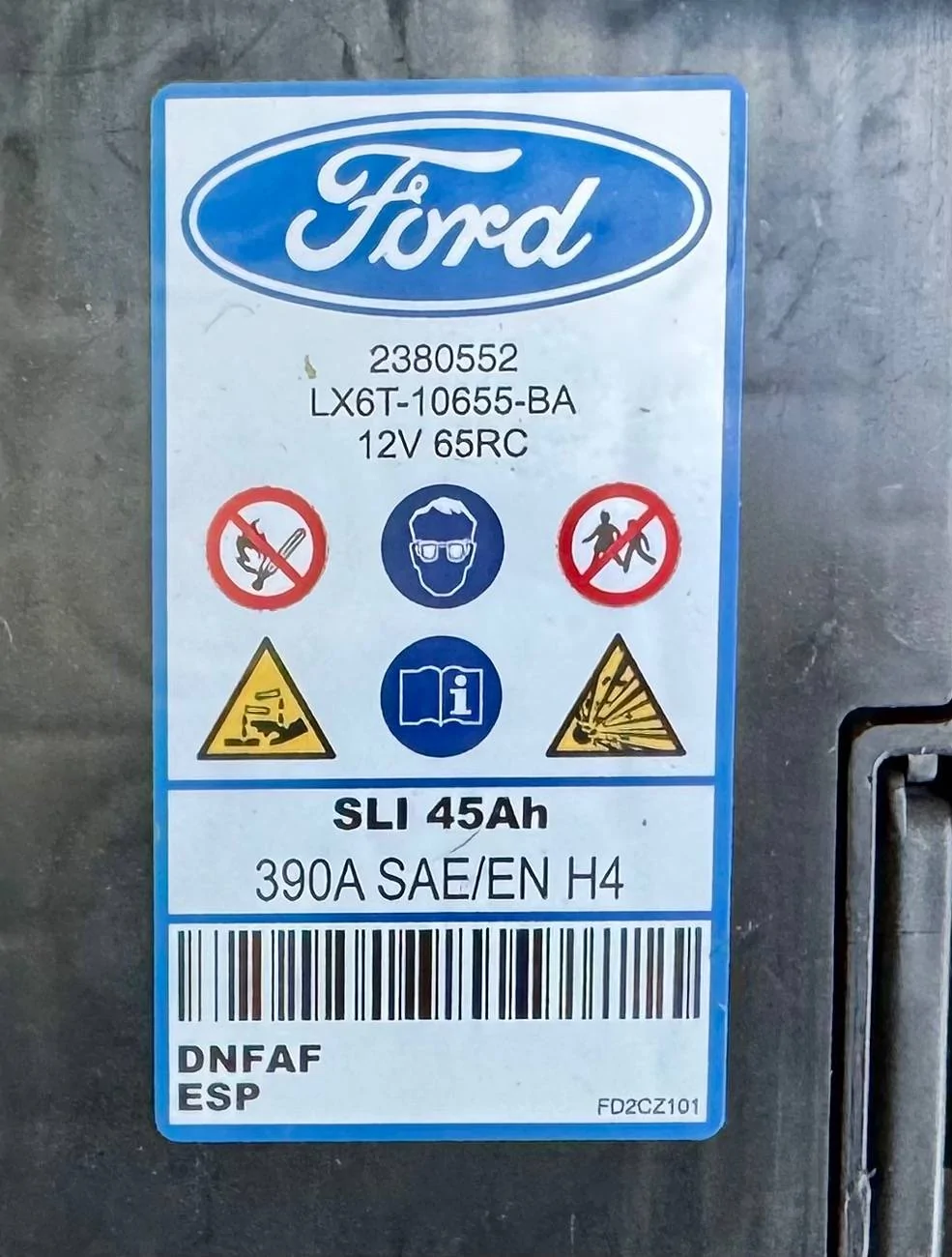

So.... I have an early release of the '22 Lariat Hybrid, and I don't exactly drive it a lot. 12,300 miles and will have had it 3 years next month.
I get the sleep mode / drive the truck warnings rather regularly, and it's definitely annoying to say the least. I sure hope Ford plans on addressing this in 2025!
Here's my original factory 12v battery which I assume is one of the offending types, and yes I have had all the reprogramming recalls performed.
That's the H4 just a little taller than the BXT99RT4A shown in my 2022 manual. It has the same CCA 390 and 45Ah.
See if dealer will warranty replace it before your 3/36 warranty is up.

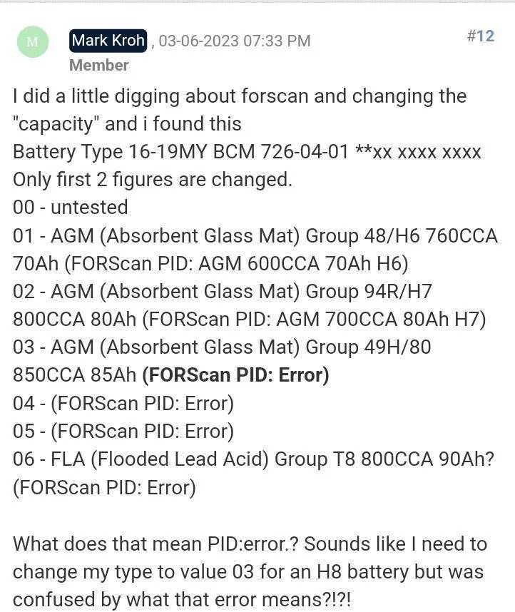

OK I found this on F150 thread.
So in BCM there should be PID where first two digits tell what battery code to use. Just need to find Ford's code for the battery installed? Maybe this has been changed in Maverick?
I posted this on different thread here.
Ok did some looking and found couple things:
#1: someone in F150 forum using forscan to set battery type to AGM. This was 2021 so maybe the codes then are not the same now and/or may have different ones for valid maverick. From what I've read the 01 is for a BC AGM and the code 02 is for AGM... etc.
#2: a link to different f150 thread has 86 posts from someone asking about installing different battery. Member bluegrass post quite a bit on the Ford BMS and in one past halfway if I remember correctly stated the different items (8+?) that the program used to charge the particular selected battery (variables different for different batteries, etc.).
Need to find the table for all Ford allowable battery types and their xx codes.
