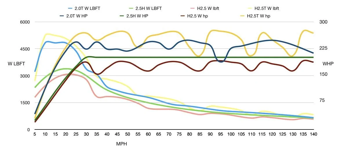

The hybrid offers way better fuel economy, 87 vs 91 octane recommended, electric torque off the line with a smooth transmission that makes the most of the available horsepower (see below, above 30mph the difference between the 2.0T isn't as massive), better stop/start performance, quite a bit of savings up front, and long term the hybrid uses a naturally aspirated port injected engine that is tuned to never even go all the way up to redline so should last forever whereas the 2.0T ecoboost is not only going to have more frequent oil and spark plug changes and the like but being direct injection turbo is bound to eventually have the unavoidable carbon buildup on the valves requiring a tedious walnut blasting if you end up keeping the vehicle 100K+ miles. FWD tends to be more reliable than AWD, as there's less moving parts and sensors, and FWD with Blizzaks can often overall outperform AWD with old all seasons since AWD doesn't really help with braking and turning traction which winter tires do.
Ford Maverick Ordering experience/please help me decide 2.0 ecoboost vs 2.5 hybrid 5C7FD18F-F470-419E-B9CC-9FB33FCDF964

Once you start loading people or things in the Maverick the MPG of that hybrid will be lower and being down by ~100HP to the 2.0L version performance loss will be noticeable
Go to fuelly.org and look at those two powertrains on the Escape, which has been out since 2020, and you'll see that just isn't the case.
From the thousands of surveys, the hybrid averages 39mpg on 87 octane recommended and the 2.0T averages 26mpg on 91 octane recommended. Adjusting for octane pricing difference, that bumps the hybrid up around 12% higher effective mileage which would be 44mpg.
Most of your fuel usage is either from stop and go or from highway cruising, not from flooring it, and the 125hp electric motor with regenerative braking and a smoother stop/start experience should be much more efficient for that, and for the highway even fully loaded weight doesn't really matter much as its really more about aerodynamic drag and it takes only a small amount of horsepower for steady state cruising, not stressing either powertrain.
The eCVT as seen above also has higher "area under the curve" for horsepower than you'd think for its peak output, meaning its not as far behind the 250hp engine as you'd think on paper.
The only truly massive difference is below 30mph when flooring it, as around 20mph you can see the 2.0T/8-speed powertrain is putting down 230hp vs the hybrids 150hp, and a AWD will have a much better launch than FWD. So aside from a 0-60mph drag race though, if you're flooring it to pass on the highway or accelerating on an entrance ramp, I expect the hybrid to do quite well.
Easiest way to verify for yourself would be to go drive a Escape back to back right now with the two powertrains, it shouldn't feel that different in a Maverick body, as the Maverick chassis is based on the Escape anyway.
