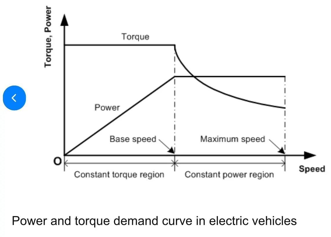

Hmm. I see quite a few comments touting the hybrid’s great torque, acceleration and 191 hp. Those are all true, if you’re in an unladen truck, starting from a stop light.
The electric motor, because of how it is designed and how the electric components are set up, how the battery is sized, etc., will provide 173 lb/ft of torque at 0 RPM, which is great for getting a load moving. It will provide that constant torque of 173 lb ft up to 900 rpm, at which time the battery management system will limit the total output to 22,500 watts, or 30 hp.
Ford Maverick Looking for advice - 2025 2.5 Hybrid vs. 2.0 EcoBoost engine IMG_1916
This graph visualizes how this works. From 0 to maybe 20 mph, the electric motor is making “constant torque” of 173 lb/ft. But once it gets up to its power design limit of 22,500 watts (30 hp), it enters into the “constant power” part of the graph and the torque starts falling, while the output remains at a constant 22.5 kW. So once you are at freeway speed, like 65 mph, the electric motor can still add 30 hp to the system, but at that speed the electric motor is spinning something like 5,000 rpm, so the motor is only putting out 30 lb/ft at freeway speeds.
What this means is that the hybrid will feel really strong off of the stop light with 158 lb/ft from the gas engine and 173 lb/ft from the electric motor, for a total of 331 lb/ft. But that will only be available up to 20 mph, before the electric motor’s torque curve starts rapidly falling off. At freeway speeds, when you try to pass, what you’re going to feel is 158 lb/ft from the N/A 2.5 and 30 lb/ft from the electric motor, for a total of 188 lb/ft. All of the sudden it feels weak compared to the ecoboost.
Another consideration is the battery size, of 0.9 kWh. The battery management system is going to prevent fully discharging or overcharging, which can damage the battery. So if you start to climb a mountain pass, while towing a trailer, that battery is only going to be able to give you, say, 0.6 kWh. At a maximum discharge rate of 22,500 watts, 0.6 kWh is only going to last for 96 seconds. That means that if you need assistance from the electric motor for longer than that time, you’ll be out of luck and will be solely relying on the 165 hp and 158 lb/ft coming from the 2.5 gas engine. And that will feel anemic compared to the 250 hp and 278 lb/ft coming from the ecoboost.
The TLDR; is get the hybrid if you’re only going to tow with it once or twice a year, but get the ecoboost if you’re a weekend warrior that is constantly towing your camp trailer and mountain bikes up into the mountains on most weekends.
