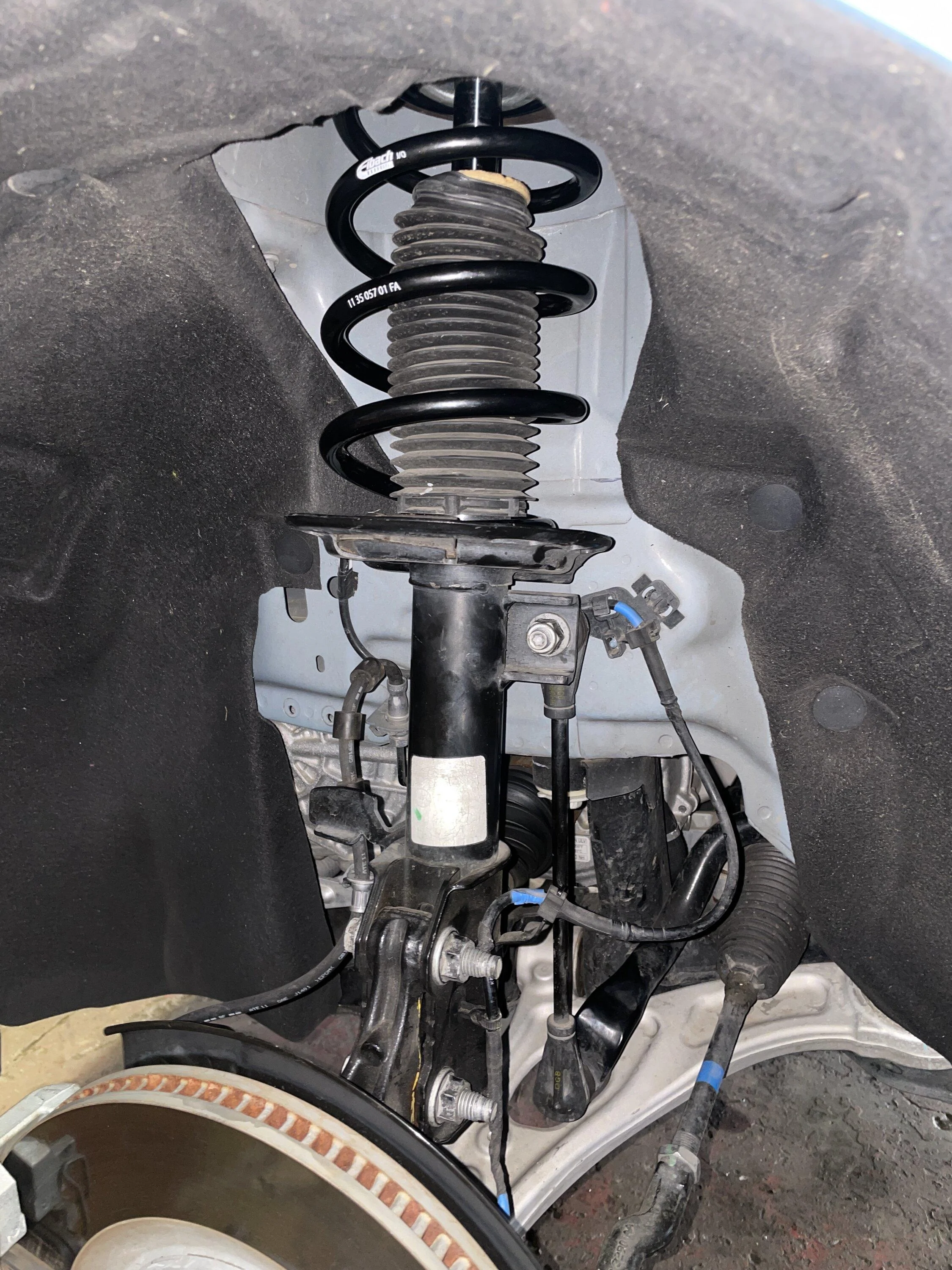

Just got my replacement springs installed, and I am finally glad to say that there is no noise! Thanks Eibach glad this issue got solved. Now I’m just kind of bummed out that I’m out 150 bucks for the reinstallation…oh well. Also incase ya’ll were curious, ride feels exactly the same as MAC_Detail mentioned

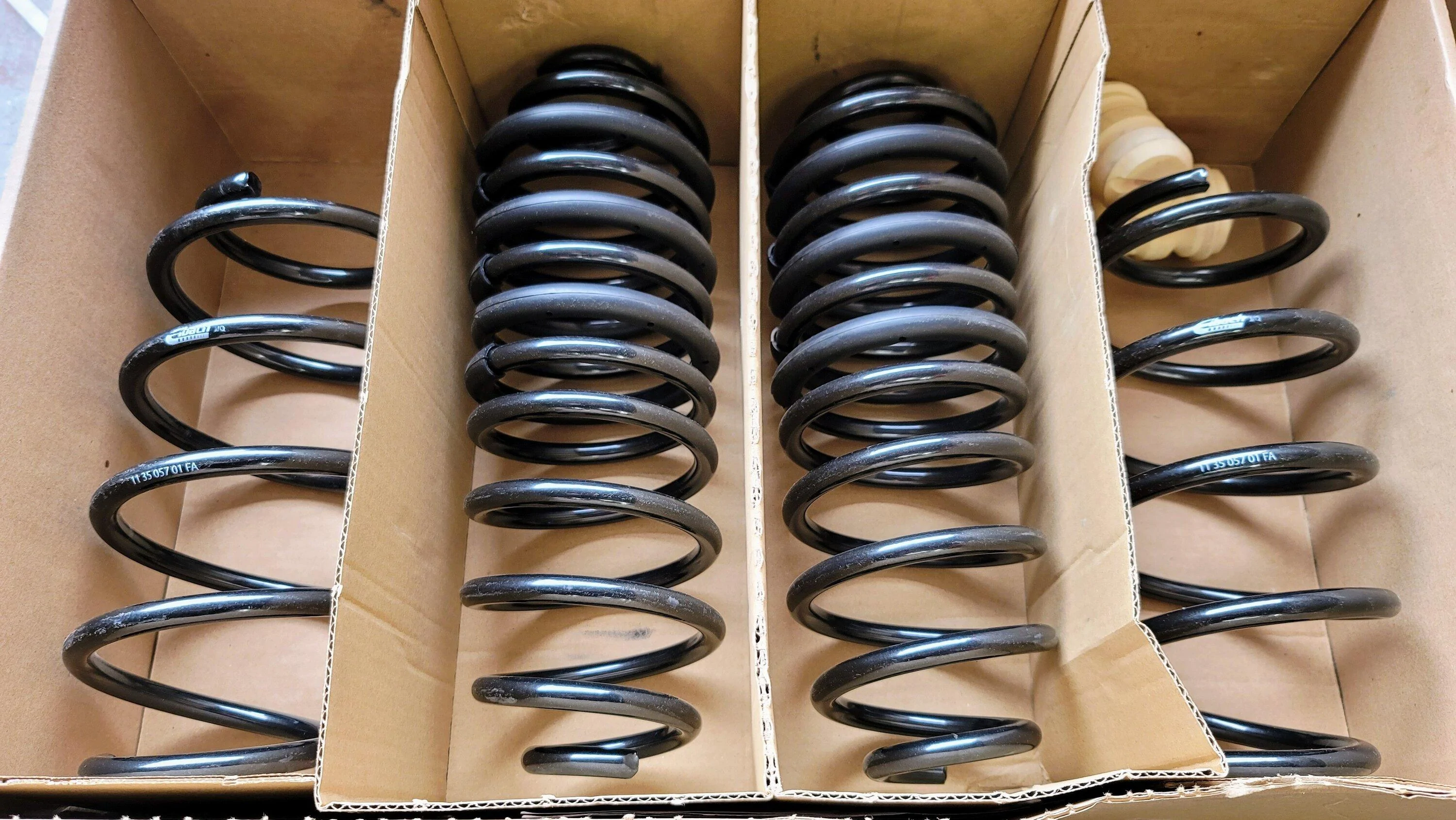

I bought the springs from a forum vendor and they were delivered today:
Ford Maverick It's Lowered...But... issues with Eibach lowering springs 20230531_145027
The front springs are marked J/Q so they should be the newer linear versions, correct? Are the rear springs progressive?
May 23, 2023
SoCal
22' XLT
J/Q is the new spring, correct. and yep the rears are progressive. You're in good shape.
