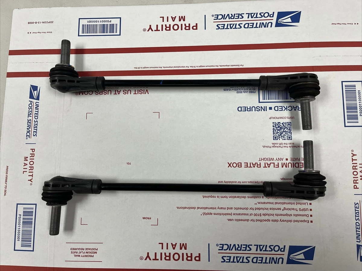

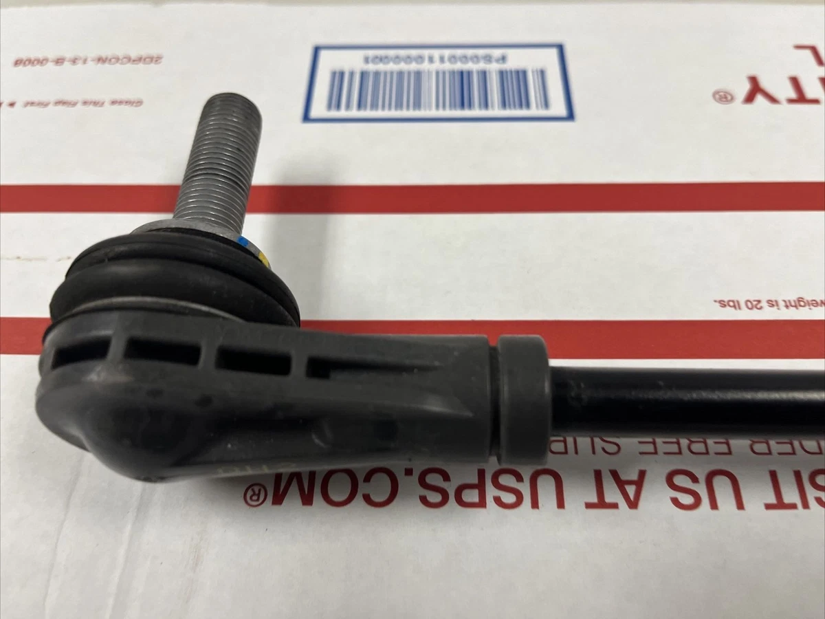

This is a stock maverick endlink from my truck. It popped and bent on me while driving after I installed the lowering springs.

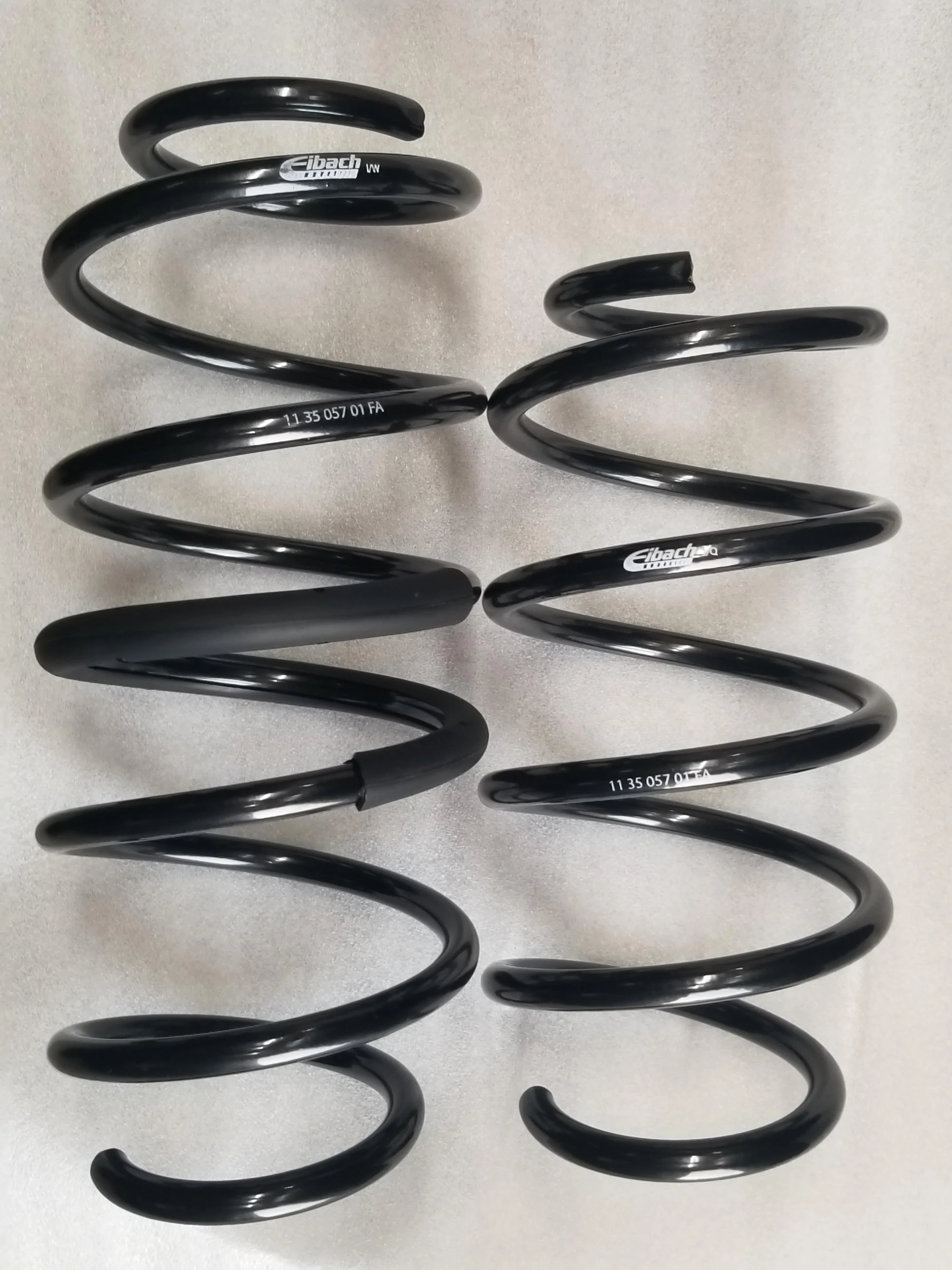

Here is a comparison of the original front springs #F11-35-057-31-FA for an Ecoboost AWD on the left with the new version spring on the right that I just picked up the other day from Eibach will call in Corona. The new spring has the exact same part number as the old one!
Glad I held up on my install!! Now my question is will I still have to cut my front bump stops 35mm shorter or at all because the new spring is shorter?
Ford Maverick It's Lowered...But... issues with Eibach lowering springs {filename}
crap. I've had a set a good while but haven't had time to install.
mine look like the ones on the left. I guess I better email Eibach to get them swapped out. :/
the free length of the one on the right obviously is a lot shorter. is the ride height the same? if it is that surely means the spring rate is higher.?
