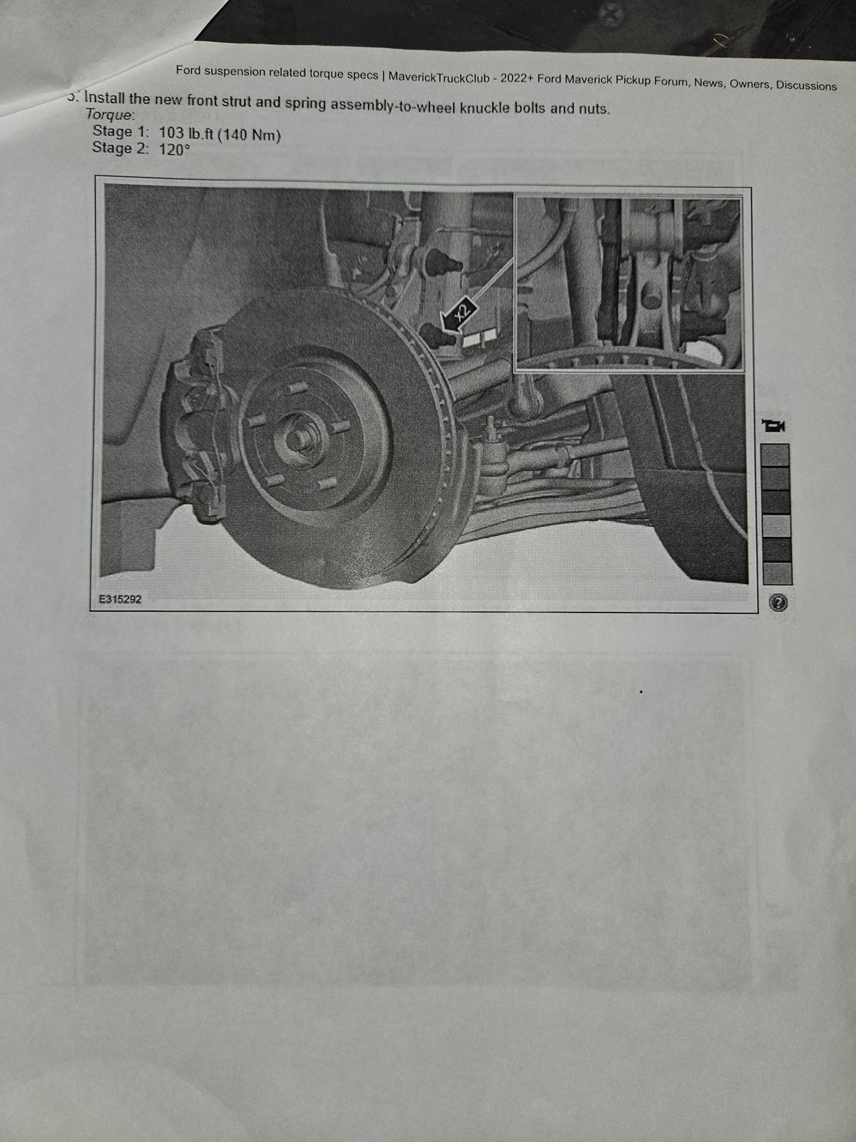

I would assume he's actually meaning the sway bar endlink bolts, as they do have bushings and you will have problems trying to torque them with the suspension unloaded.
it will be very hard to get under there with the truck literally on the ground so I would suggest using ramps and of course placing jackstands under and chocks on the rear wheels.

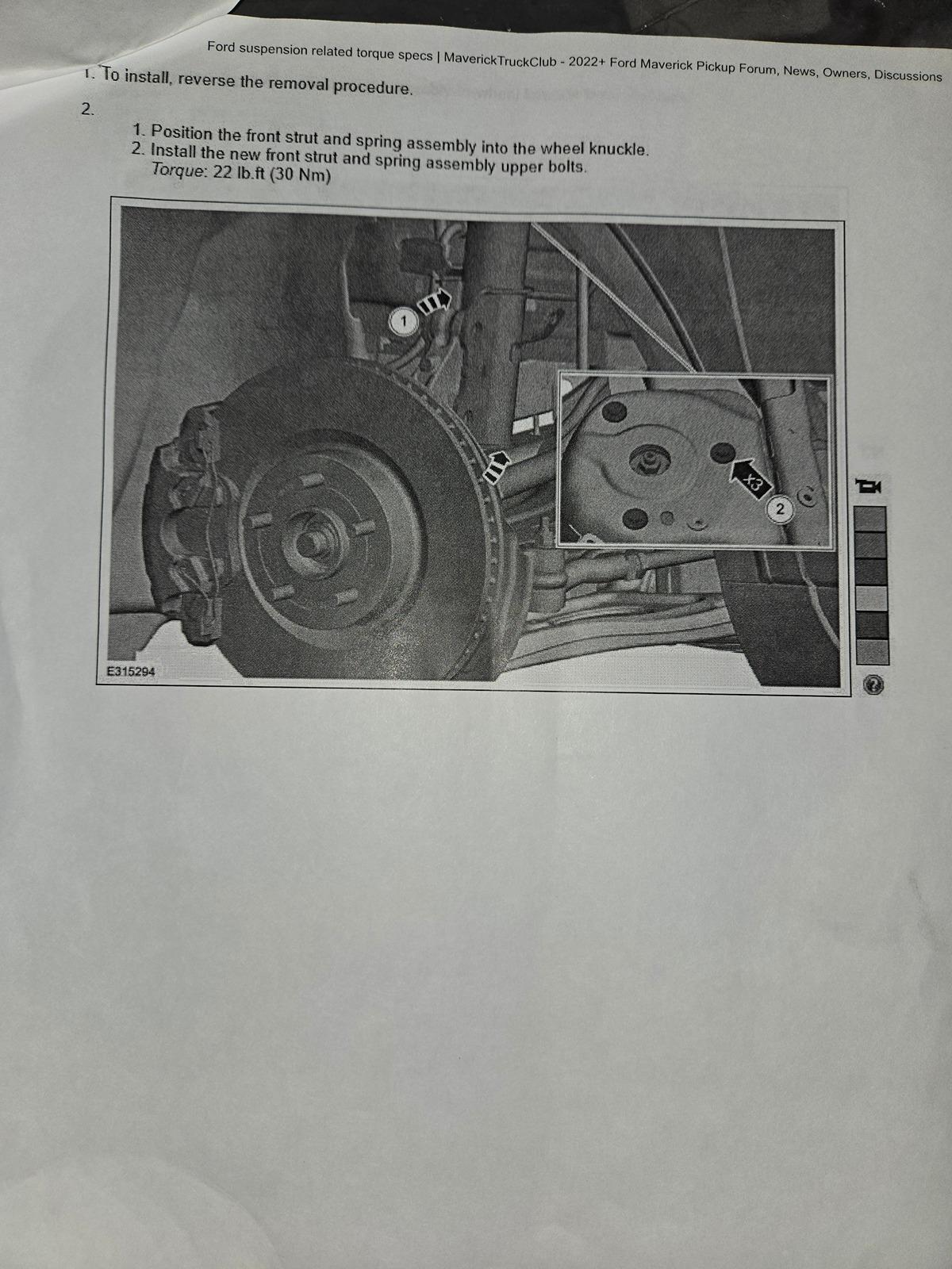

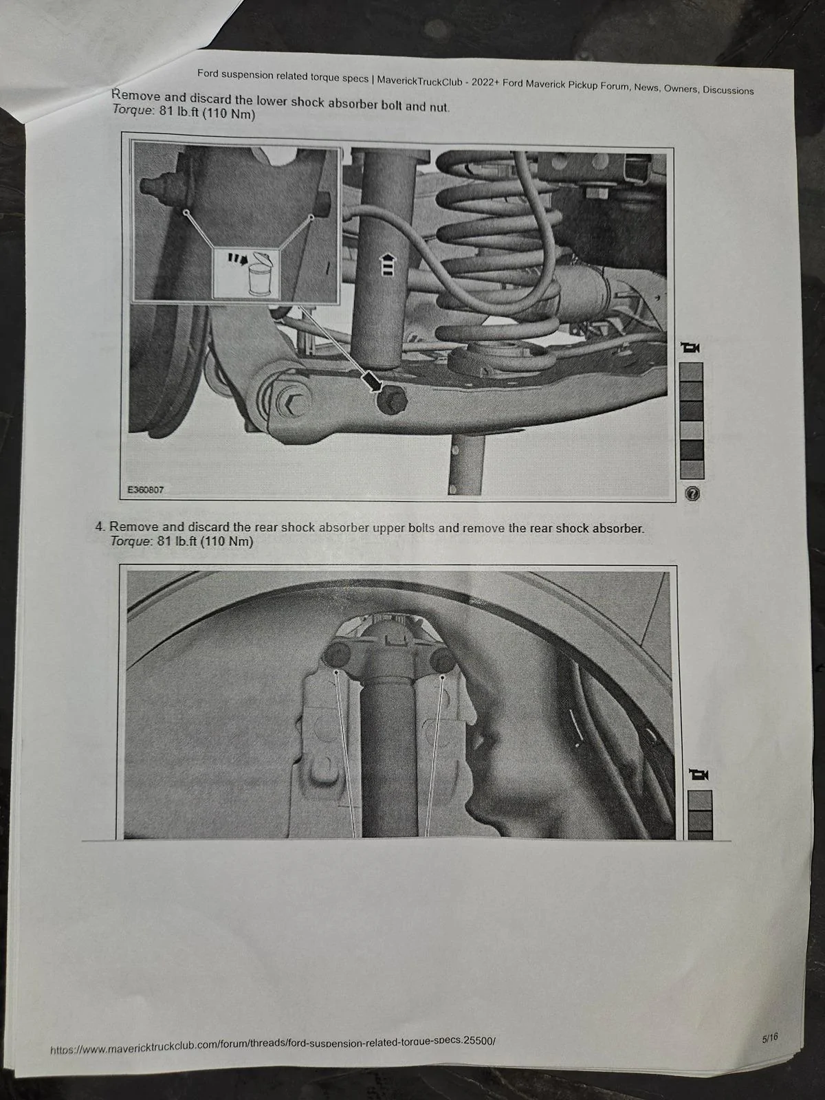

I got them from someone here on this forum. They come from the Ford Maverick manual. It also says that you must discard the OEM bolts and nuts and purchase new ones. I just re-used the OEM ones. I didn’t see a need to buy new ones.
