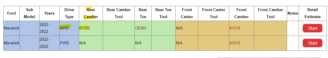

Hopefully there is a picture available for the Eibach adjustable arms
I don’t see anywhere that they are lower arms… I feel if they were they’d be more than $275
I hope they are different than the SPC upper adjustable control arms, because those only work for lifts
I just emailed Eibach to see if they're compatible. Good point though, I just assumed it'd be an adjustable lower control arm. We'll see what they come back with though.
