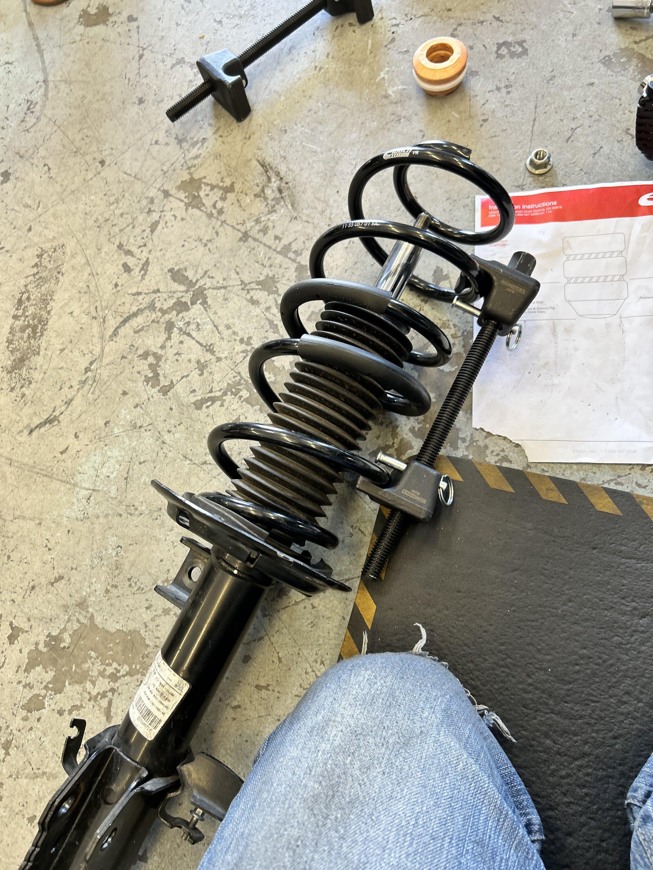

As requested
So these are the new springs? I'm asking because if you look at the picture I've included (during my installation) it's the same part number!
Ford Maverick It's Lowered...But... issues with Eibach lowering springs 70327640389__47C80850-6F62-47F2-AB84-645D8CA3F37A
jewc75
Nov 24, 2021
950
1,112
Yes new spring. Less coils and no isolator in the middle.

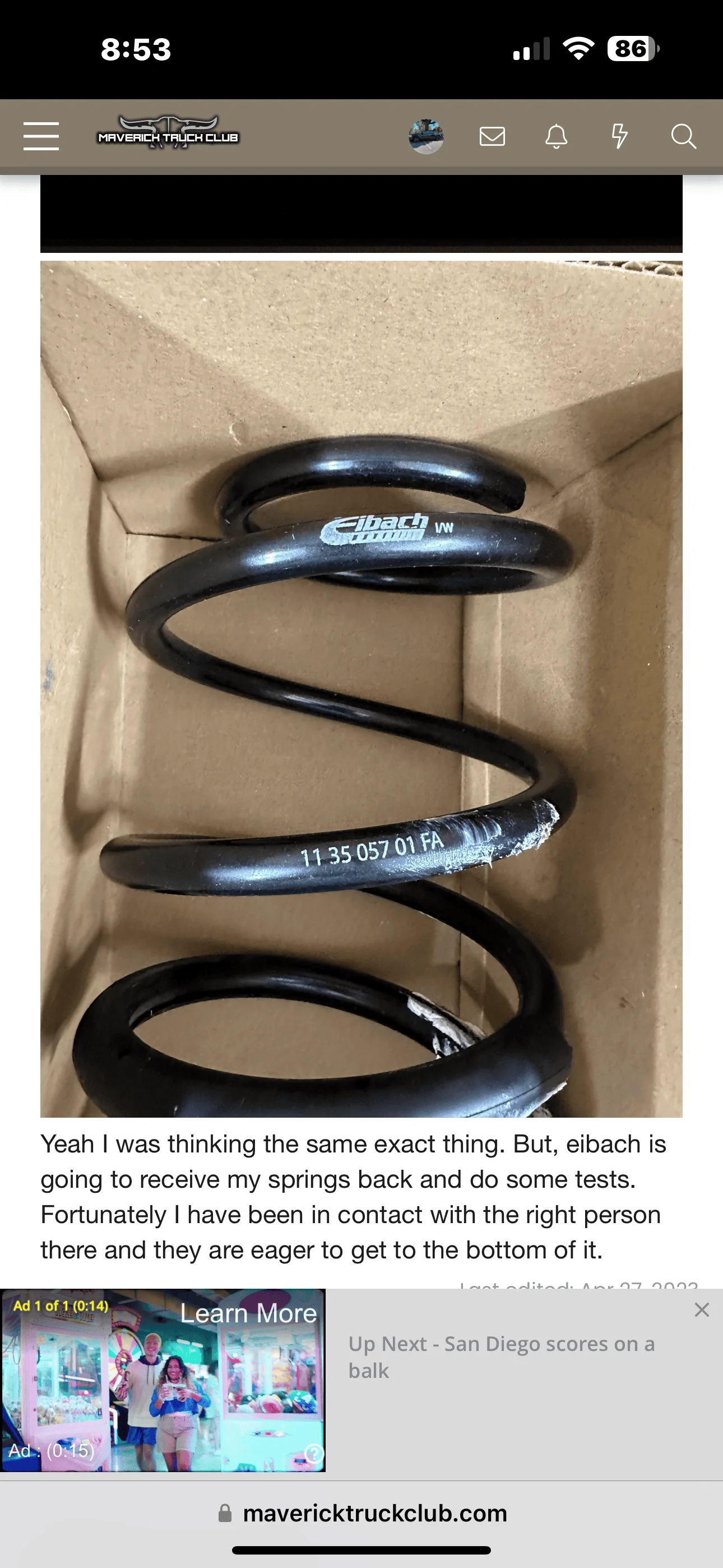

Here is a comparison of the original front springs #F11-35-057-31-FA for an Ecoboost AWD on the left with the new version spring on the right that I just picked up the other day from Eibach will call in Corona. The new spring has the exact same part number as the old one!
Glad I held up on my install!! Now my question is will I still have to cut my front bump stops 35mm shorter or at all because the new spring is shorter?

I think they left the part number the same for Marketing reasons.
Yes, you will. If you leave the stock bump stop in it with a drop spring you are losing that 20mm of travel they want you to cut off. Thus it will bottom out even more.
