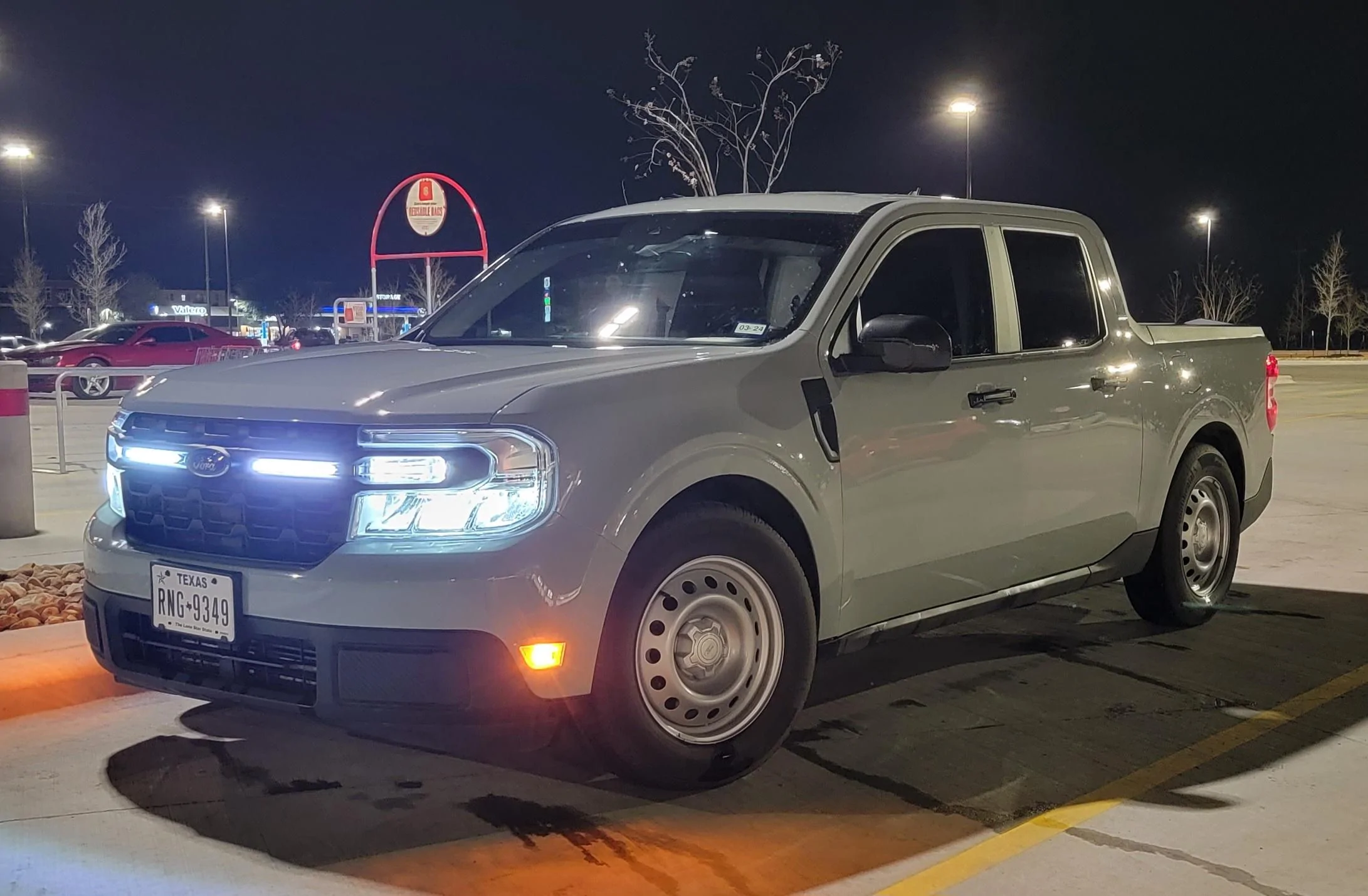

jewc75 love ya color catcus grey same as mine that is being delivered next week , is your truck stock height cause it looks lowered
