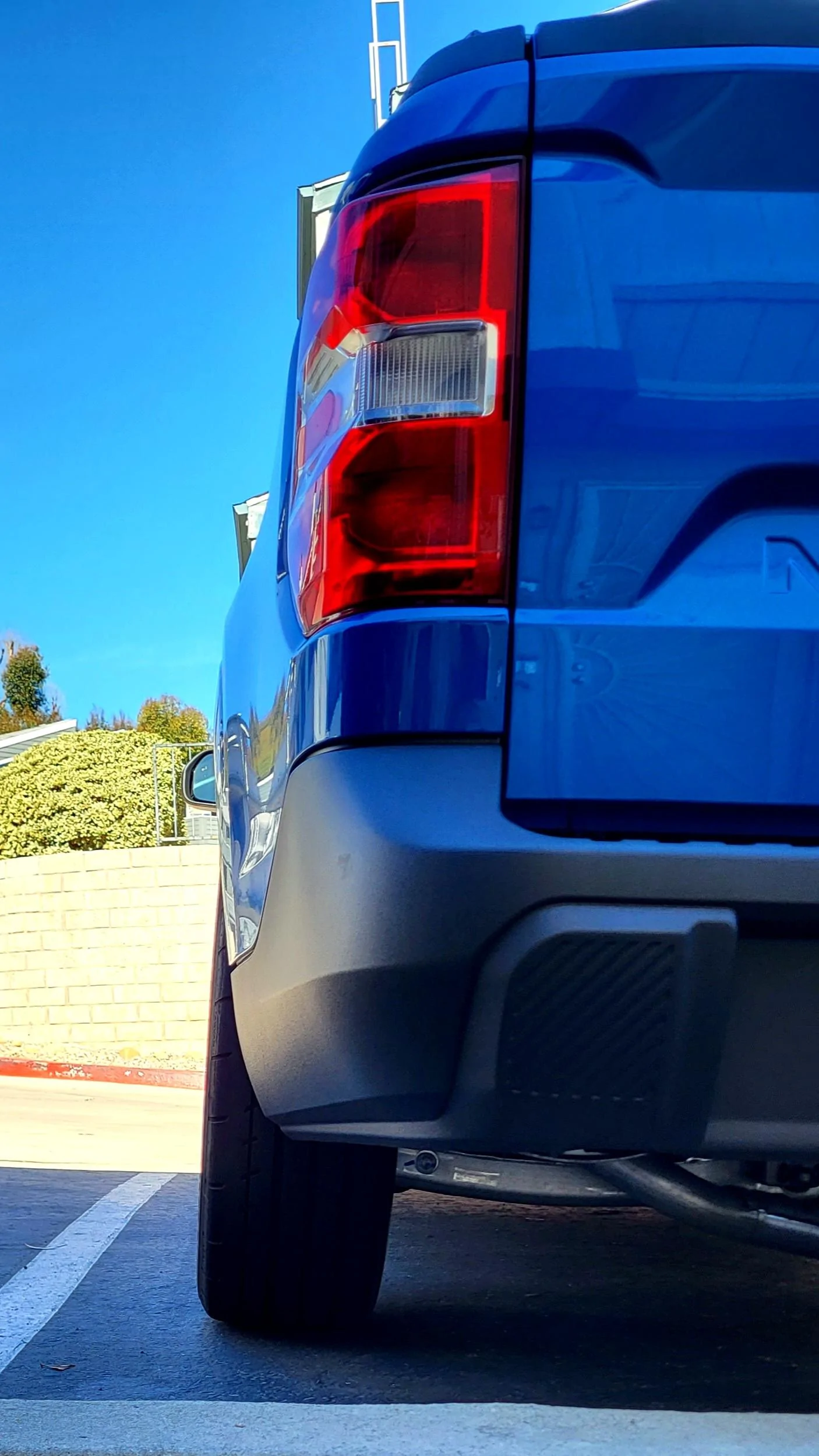

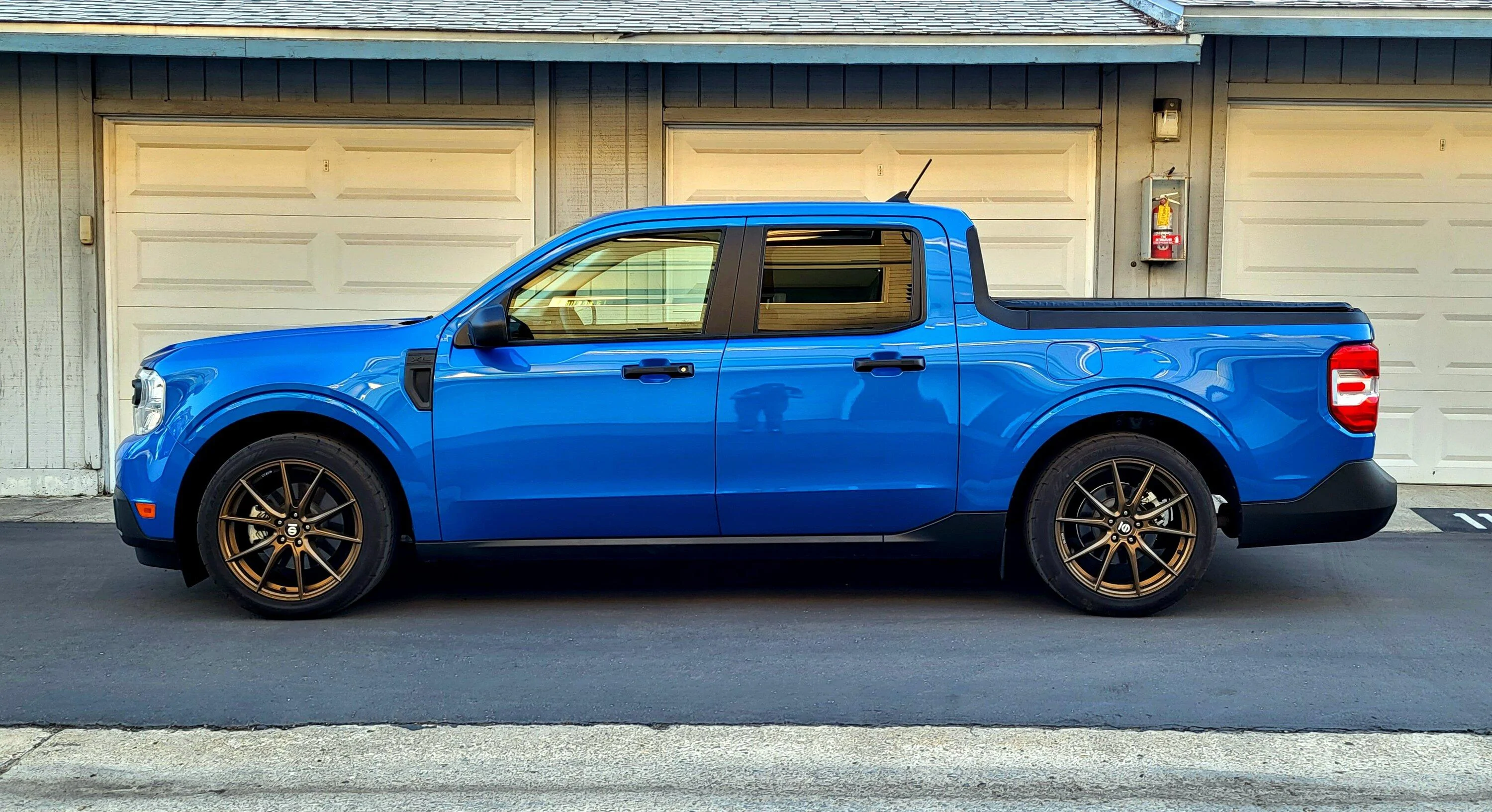

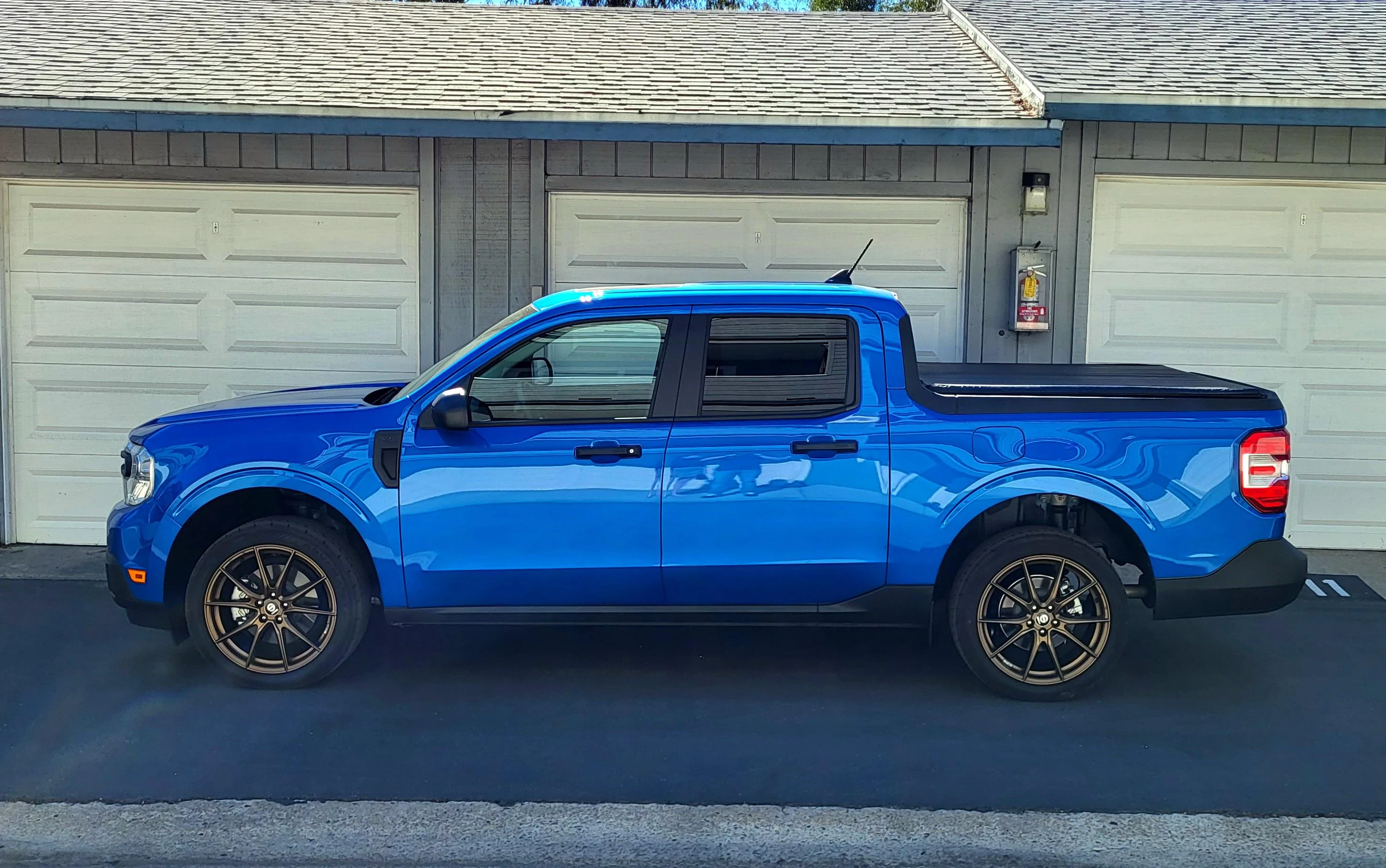

AWD lowering springs installed! I'm definitely glad I waited to go with the Eibach's because I feel like the H&R's wouldn't be low enough for my liking (I kinda want it another inch lower already). These really take care of the excessive wheel gap, especially since I'm running an overall smaller diameter wheel/tire combo than stock.
Install is really easy if you know what you're doing. It took me two and a half hours to install them, but I had access to a lift and a full shop. The video I posted above helped a lot to know what to expect before starting.
The whole truck feels much tighter (I also have a Steeda rear sway bar set to max stiffness and really grippy tires). You feel more bumps in the road but it's by no means harsh or uncomfortable. The front lower mud flap does scrape on speed bumps if I don't slow down enough, but is very minor. I haven't gotten an alignment yet but the truck drives straight with no pulling to either side. I'm going to be driving up to LA tomorrow for a longer test, but so far I'm very happy with them.

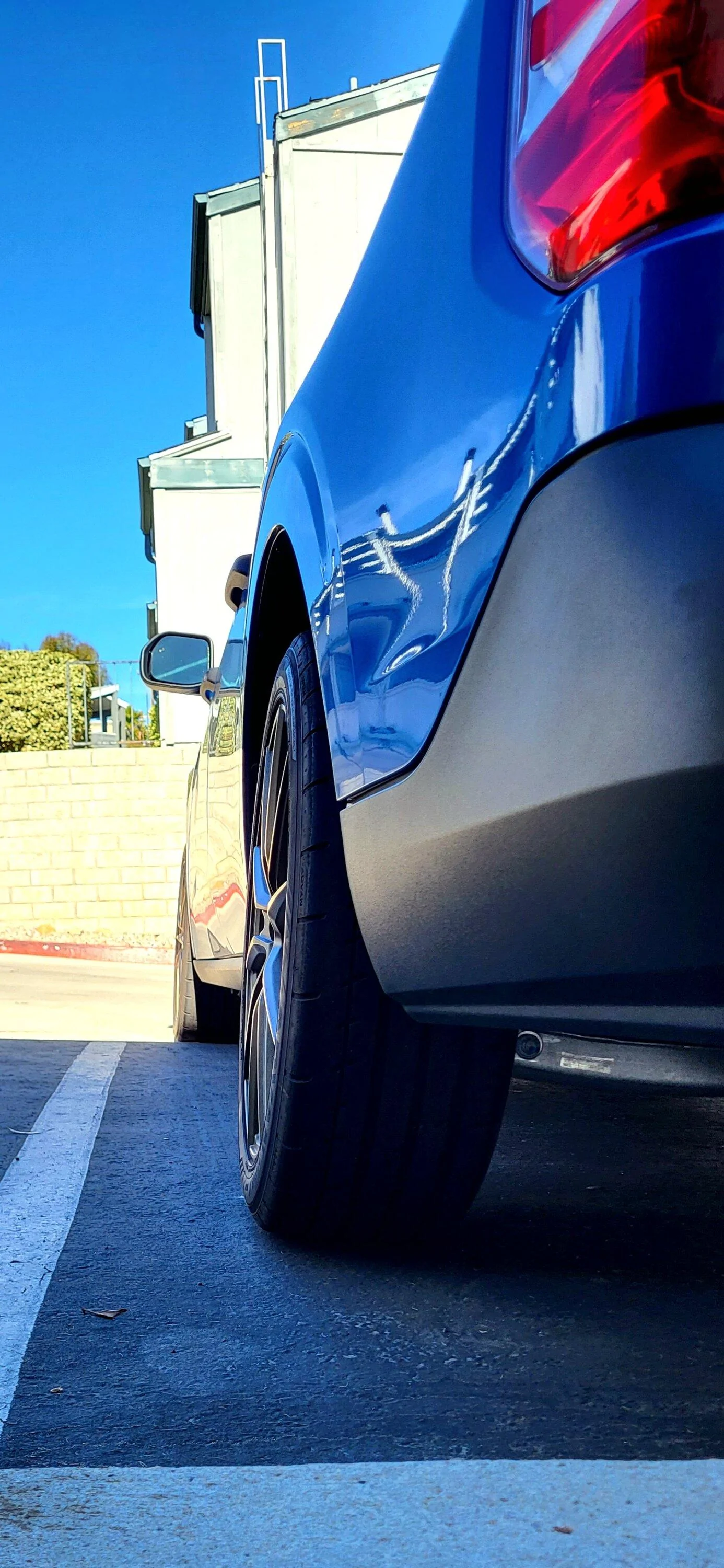

That looks awesome! I have H&r springs on the way, debating whether or not I need the cam bolt and adjustable rear arms. Do you have excessive camber with these springs?
I don't notice any excessive camber by eye on the fronts, but I'm not a precisely calibrated laser alignment rack 😁. The rears do have camber and while it's not that bad I do plan on eventually getting the cam bolts and adjustable rear arms just to straighten it out.

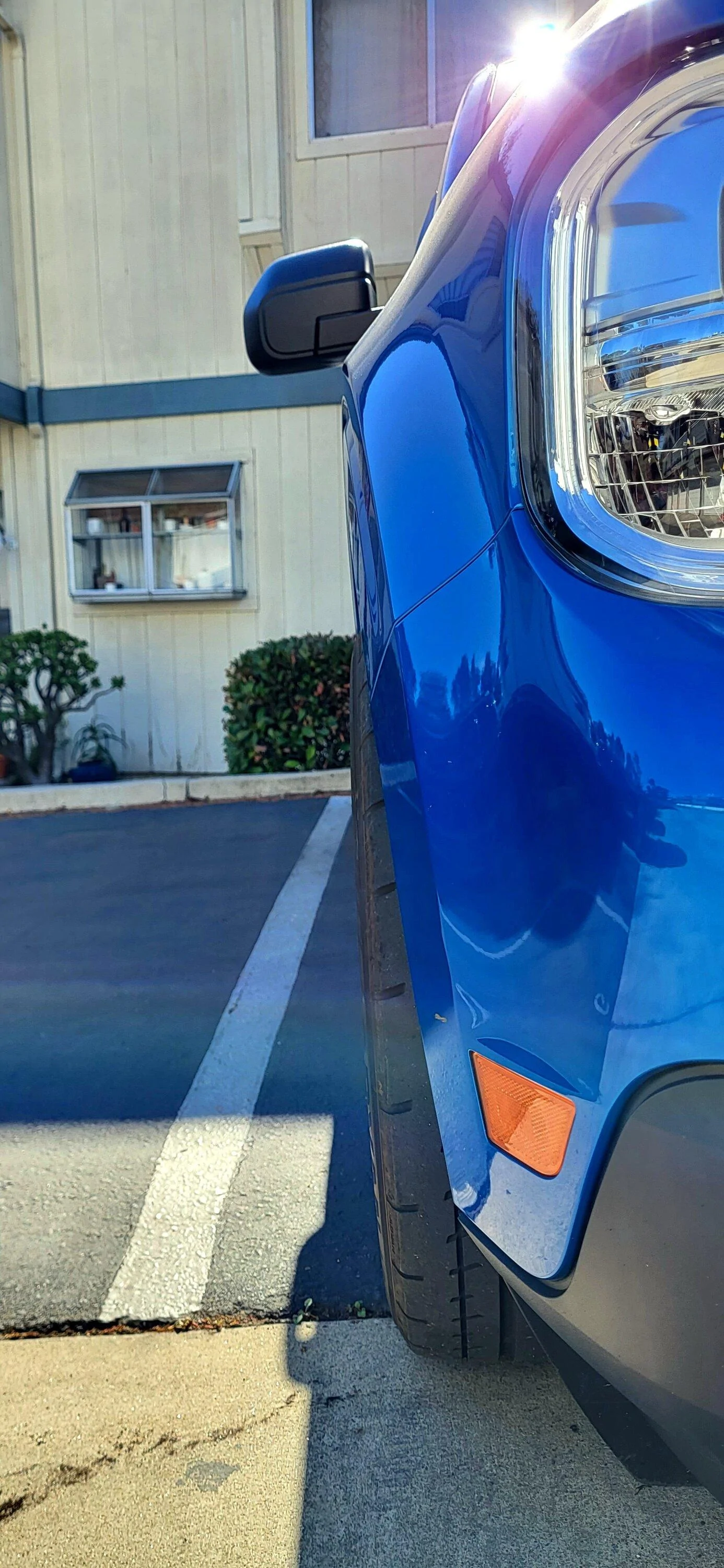

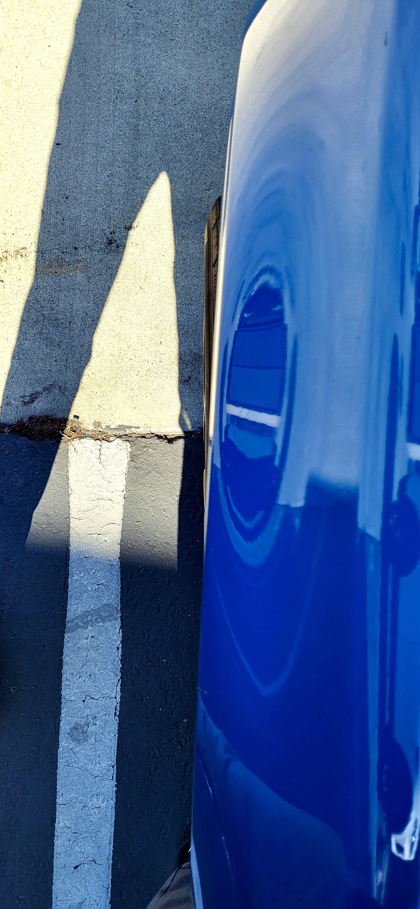

wheel/tire specs please. any poke on the front wheel?
Looks great lowered! What’s the info on the wheels and tires? Do they poke out past the fender? Also can you post more pics?
Wheels are Sparco DRS 19x8 +45 offset, tires are Yokohama Advan Apex V601 in 245/45-19. There is a little poke at the front where the fender gets narrower to meet the bumper, but other than that there isn't any poke. I could run a 5 mil spacer safely to change to a +40 offset and get a little more poke.
