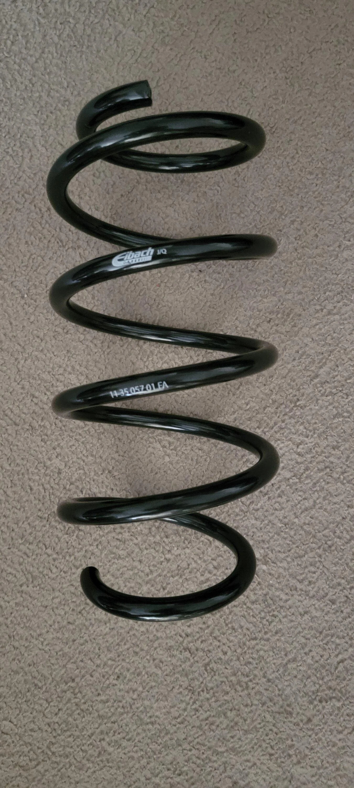

Yes new spring. Less coils and no isolator in the middle.
Can you reply back after you get the new coils underneath, and give it a test ride. Please let us know how it rides, and if the clunking is gone. I'd like to get the revised front springs and stay with the Eibach kit, but if these revised springs dont fix it I'd prefer to return the kit and get H&Rs

I just got word from Eibach and the new spring should have a J/Q stamped on it. If anybody has the old springs that cause the noise reach out to [email protected] and they will replace them with the new ones.
They are sending me a new kit also, I just found that out. I knew they would get to the bottom of it, it would just unfortunately take a lil time and trial and error. I hate I was having the issues, but I am kind of proud to know I helped them out with coming up with a resolution for this issue. They are a true enthusiast company and they make top notch stuff.

Would J/Q appear also on the part #? I was looking at their website and didn't see "new version,improved or redesign" just wondering.
No, it would appear on the springs as a pic of the new springs was posted. Right beside where it says Eibach, it says J/Q
