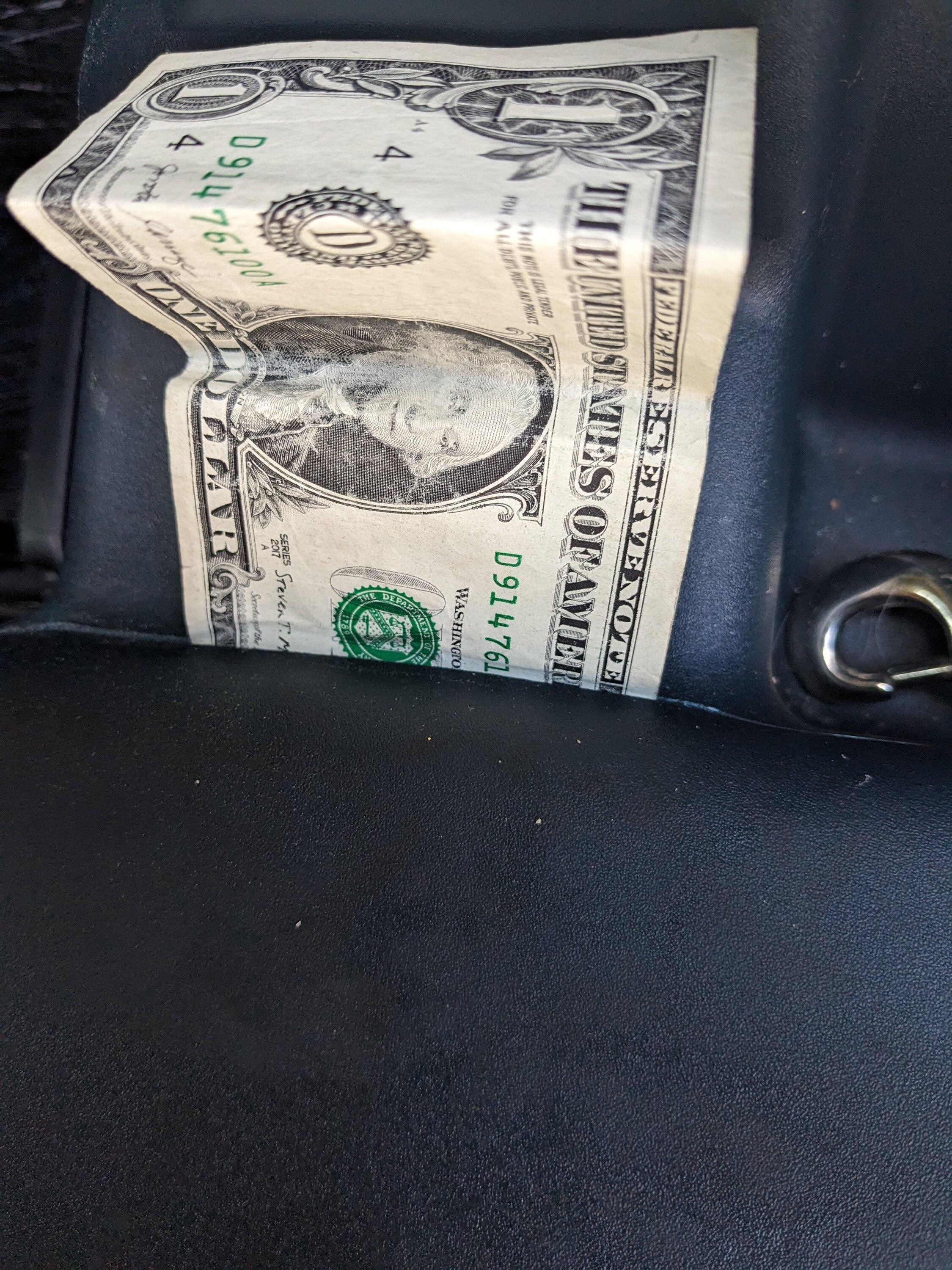

Well then it's a deep scratch,so deep I can hide money in it! A warning be careful stepping on that plastic I guess, it has been below zero not long ago and had friends in the back. I will for grins see if it t can be covered under warranty, if not I have some nice carbon fibre tape will cover and keep it from getting worse
That sucks. BTW you posted this in wrong thread.
thats what i get for posting on my phone fat fingered! lol. be careful stepping into the back of your truck!
Lol thanks I if it ever gets built I’ll keep that in mind
