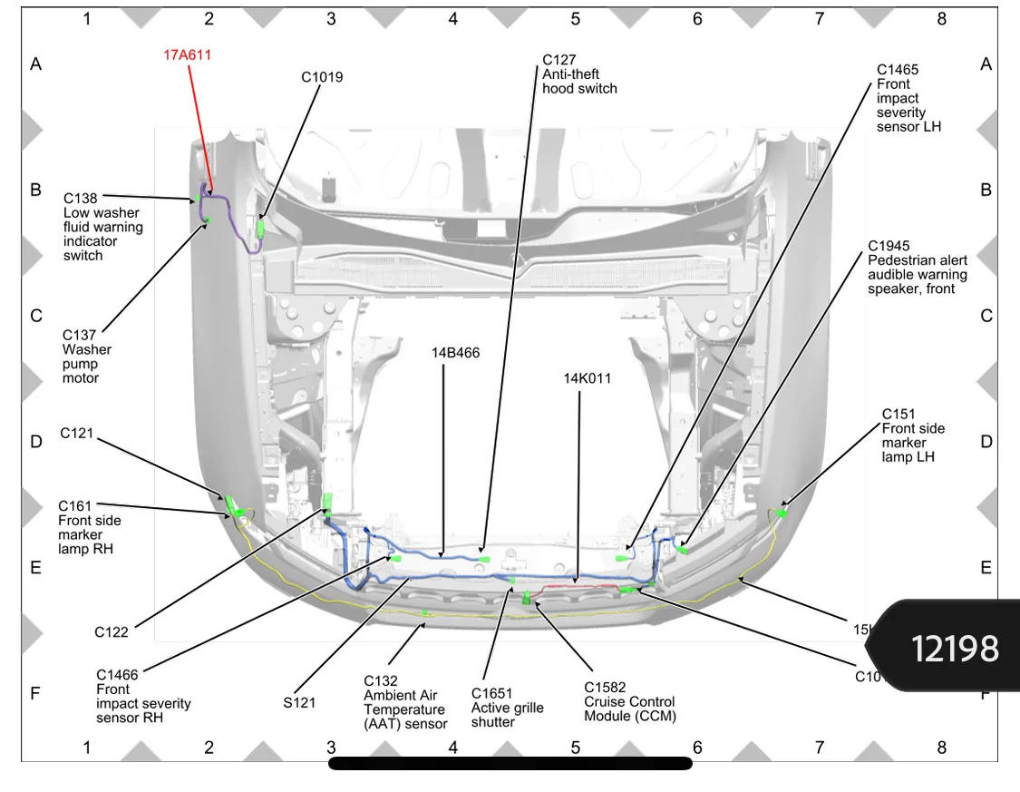

In the 12,198 page searchable technical manual that I paid for, there are zero hits for "octane sensor" and only four hits for "octane".
One was "knocking may occur if octane rating of fuel is too low".
Three places under spark plug fouling was "do not use octane enhancers".
Zero hits for timing advance, timing advanced, advanced timing, advance timing.
But a handful of hits conditions such as knocking and cold start that reduce or retard timing.
