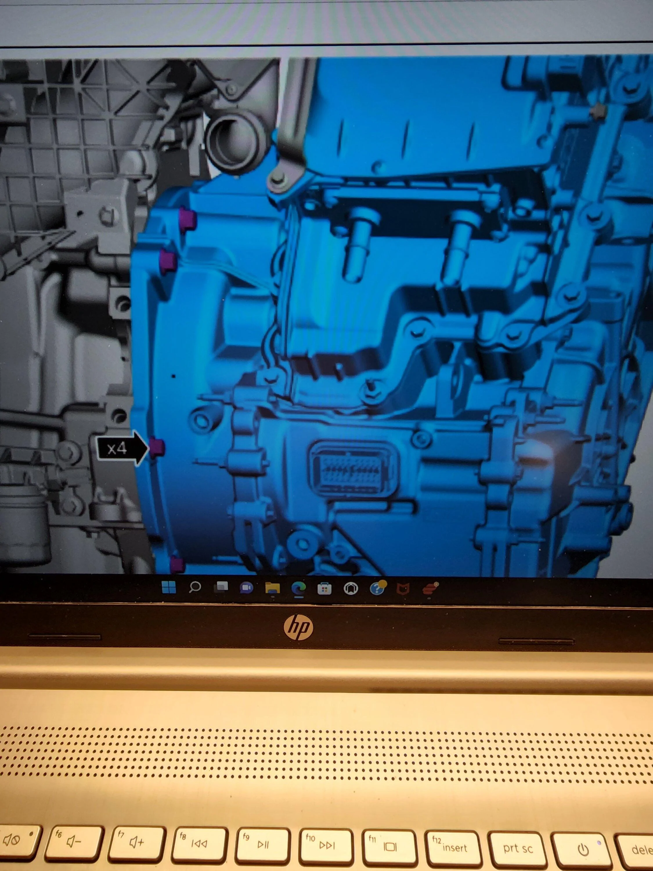

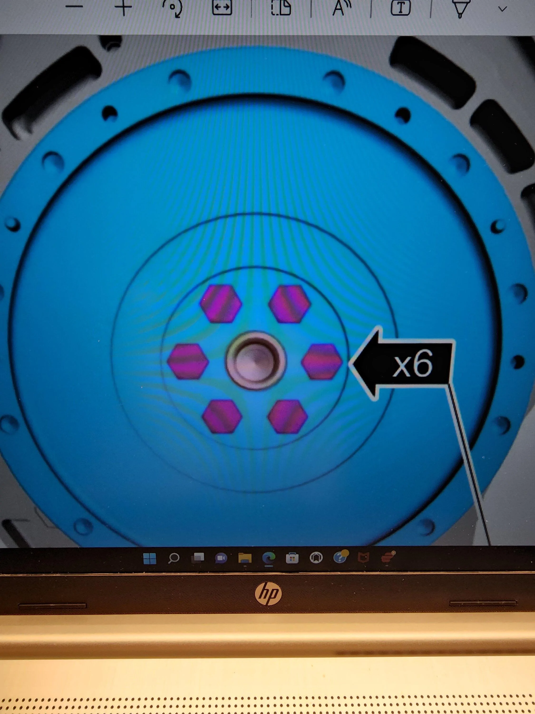

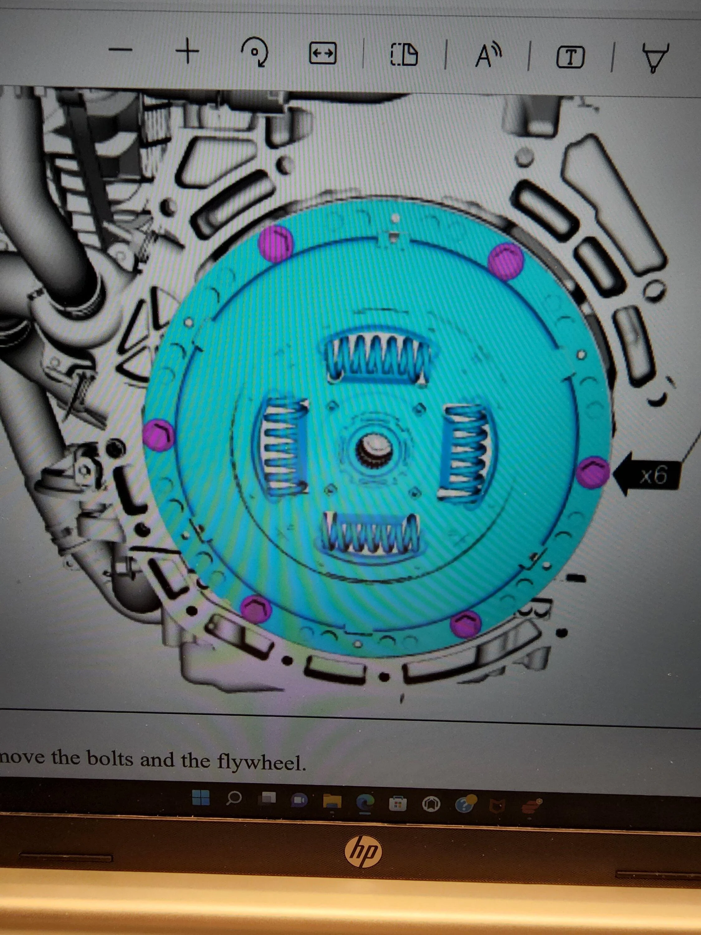

HI Randy,I just turned 10k miles. Out of the factory to ~3000m, all was good, then i started noticing a very small/slight shudder while decelerating vehicle when the regen slows, thought it might be just a tweak needed in the deceleration to regen program. ~7000m shudder getting quite noticeable. Now at 10000m i am getting concerned, there was one other member i read about that had his drive clutch diagnosed/replaced and this popped in my head.
It seems like its getting worse and longer period of shuddering.
Hope i dont have to go down that road, as the engine has to come out to split from drive unit. I have tried different modes of operation, but does not have effect on shudder. Doesnt shudder during acceleration, however i havent beat on it to determine.
