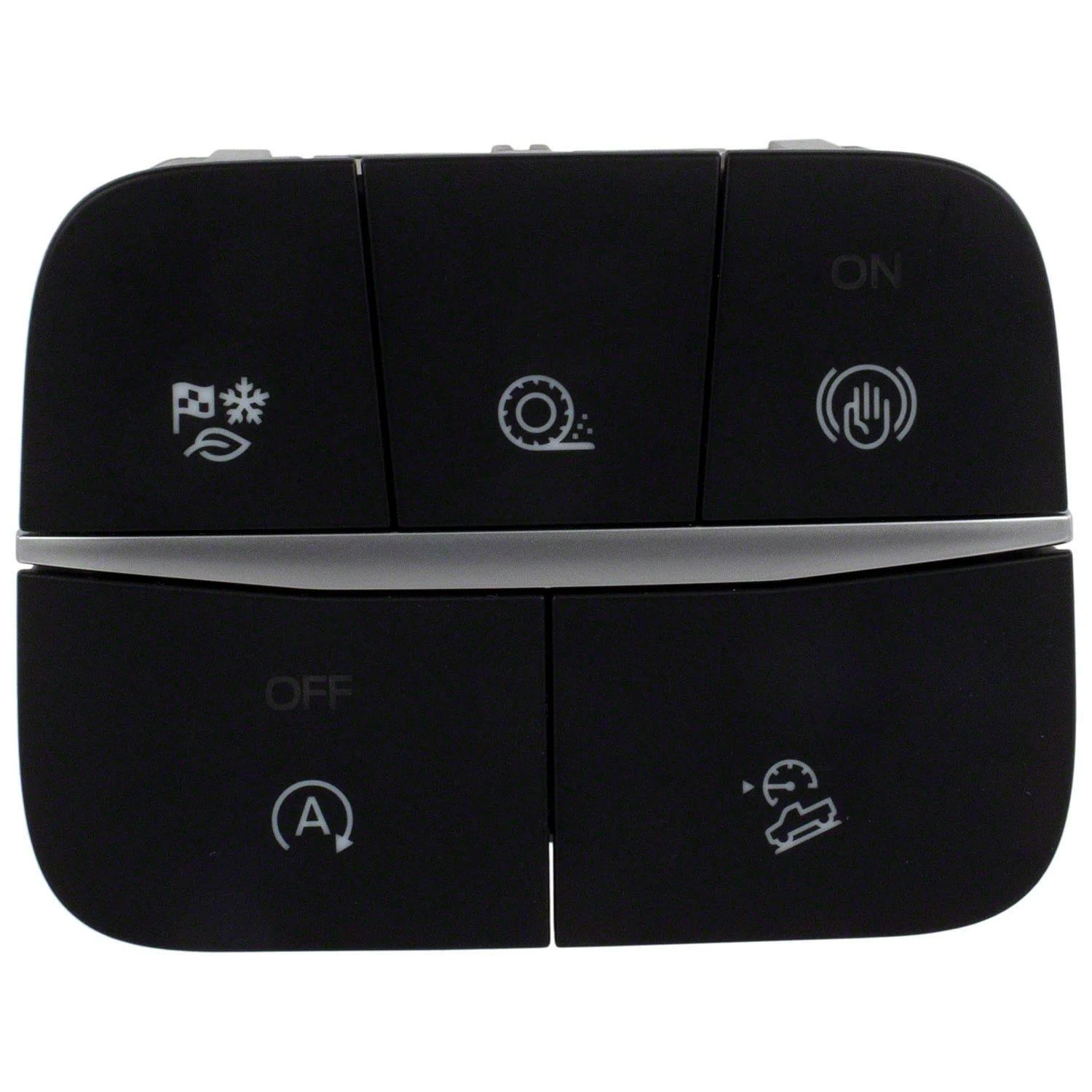

Next mod up is to go full FX4 functionality on an XL. I ordered the switch for Hill Descent Control. Once installed I just need to activate HDC functionality and the button with forscan.
Ford Maverick ForScan mod - enable all drive modes: eco, sport, mud and snow (confirmed working) 437844
Part # NZ6Z11500CA
Cost ~$73
