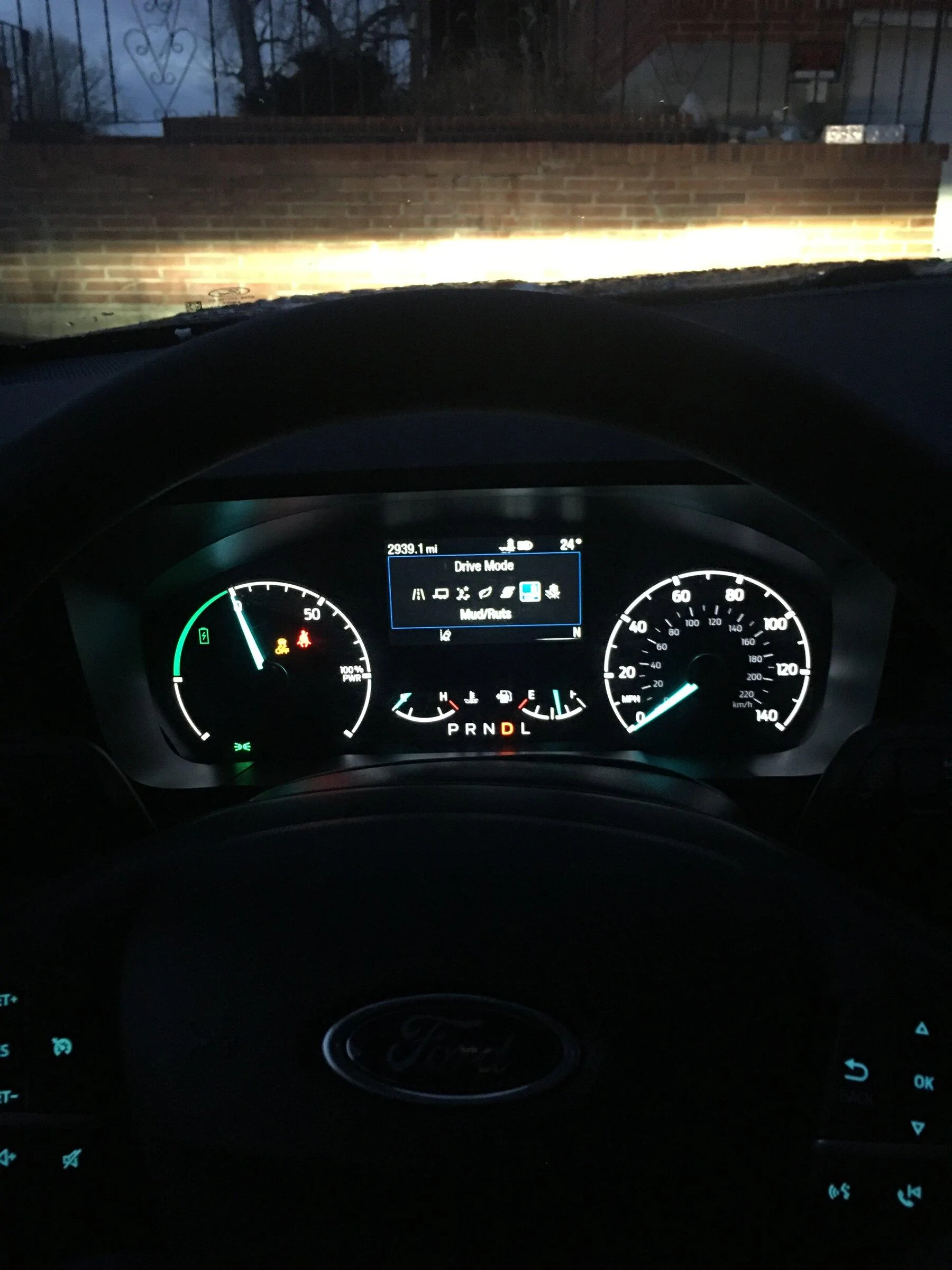

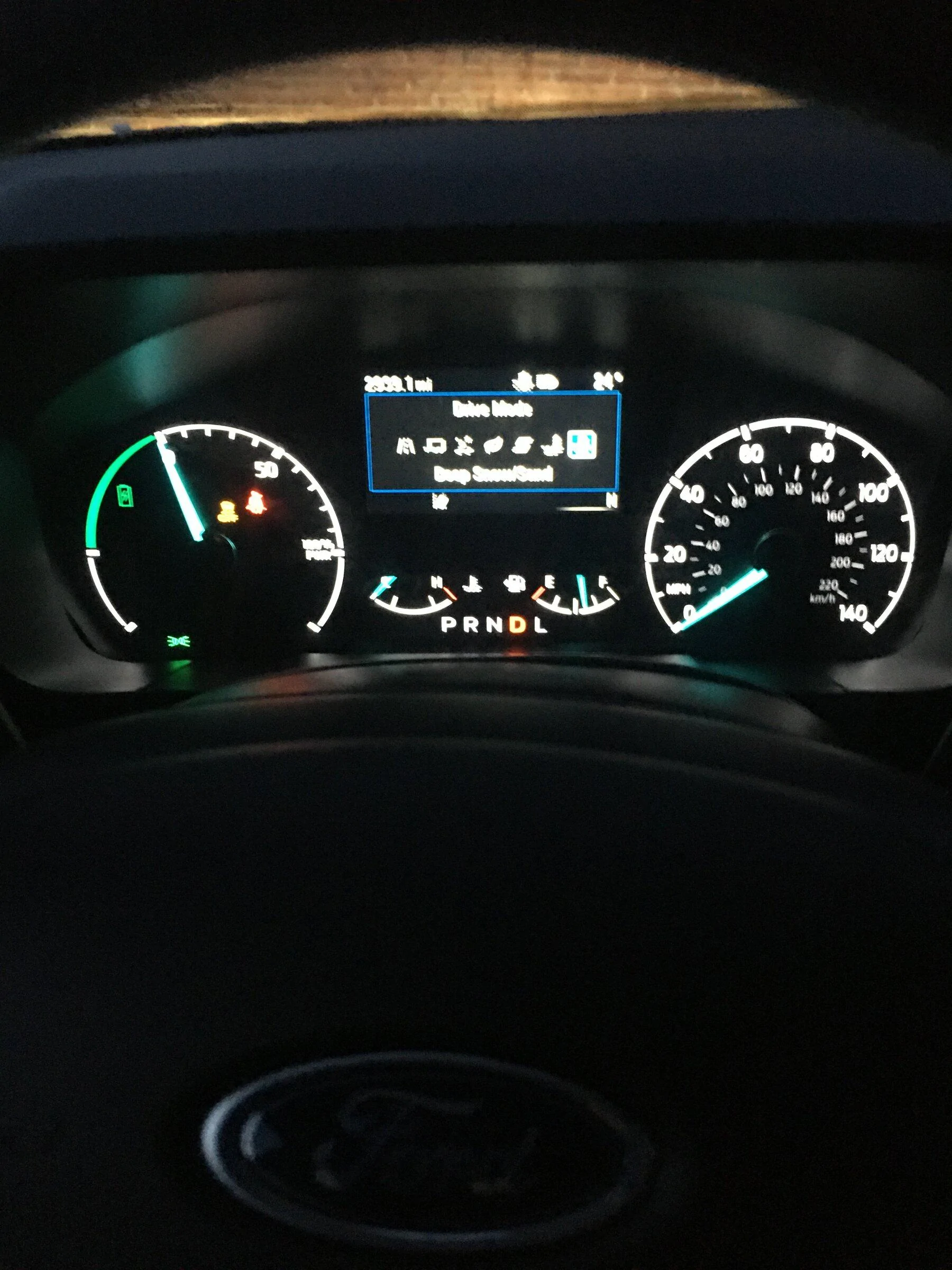

When you get a chance to drive with the modes on let us know if they actually work and it is not just on in the ABS and cluster.
OK, went out and found some ruts and deep snow. Both modes disable traction control and pure ev. Deep snow/sand allows for major wheelspin. The little green downhill truck icon came on in rut/mud mode going downhill in ruts but it seemed about the same level of “engine” braking as eco mode. Does this sound like what happens in the ecoboost awd?
It is supposed to disable traction control in both those modes. That green truck icon I think has to do with hybrids charging system. Another test is to use the FX4 modes on a regular road. It should cause some vibration in the wheels.
If you have the equivalent of the intelligent AWD menu in the cluster. You should be able to monitor the power to the wheels that way in the cluster. It should be under the display option.
Did you check to see if the system is throwing any DTC codes afterwards. Sometimes when you change these settings it will throw at 1 time code in the PSCM module that needs to be cleared afterwards.
