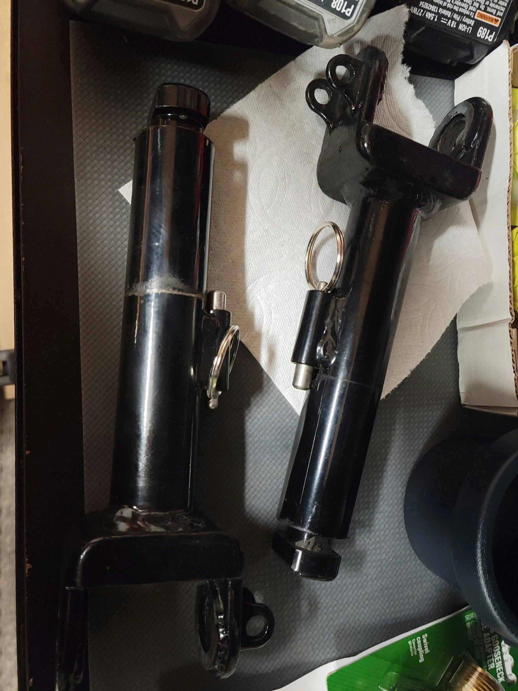

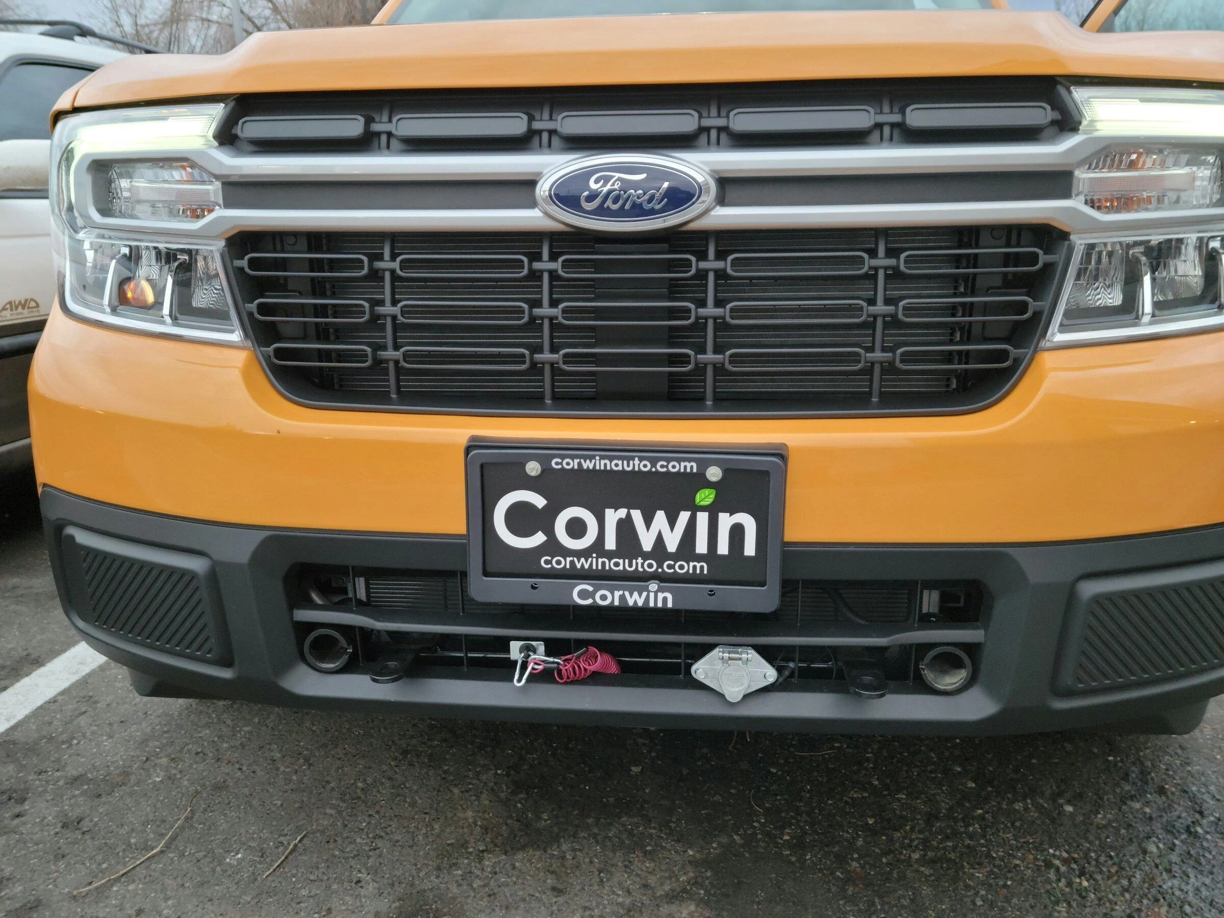

They took 5 days for mine yours may not. I decided not to use because I couldn't really see a way of getting through everything like my jeep. Just to let you know NSA does not have the correct clevis for the Elite and Roadmaster. The clevis they sent me for the roadmaster does not fit any of Roadmaster parts. They had to adapt there part to fit my clevis. Order the aluminum 3/4 inch clevis for Roadmaster from NSA.

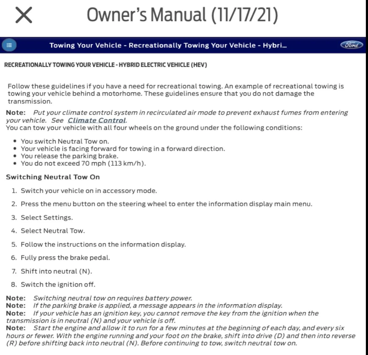

Ford clearly states in the notes of their doc that the customer must follow the procedure for putting the Hybrid into towed neutral. To me, that sounds exactly what other flat tow & TOAD vehicle owners must do.
I plan on flat towing the Hybrid behind our RV. No dolly.
I was trying to understand this. HOW do you put it into "Towed" neutral? Doesnt this also apply to car washes that pull your car through them?

A few feet in a car wash like any other car, just putting it in neutral will suffice. Thousands of miles is different, luckily the Maverick hybrid has a tow neutral setting that disengages the FWD from the eCVT transmission. The only requirement is that the engine be run every six hours or less, foot on brake in drive, then reverse, then neutral before placing back in tow neutral.

That is to charge the battery because the accessories are on unless you have a trickle charger installed that will take care of that. Roadmaster I stalls that when doing base plate and light hook up.

Sorry misquoted the accessories are not on but the lights are so you need to charge battery.

Your email doesn't work so hear are photos the middle photo is the part that was modified by adding 2 spacers to inside to take up slack to fit over NSA clevis. Middle photo part fits into upper photo.
