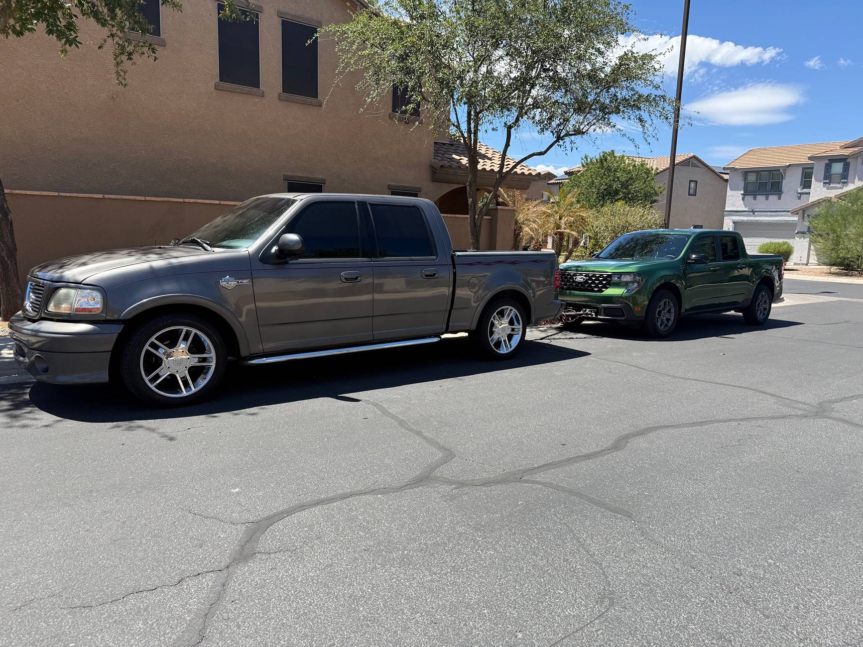

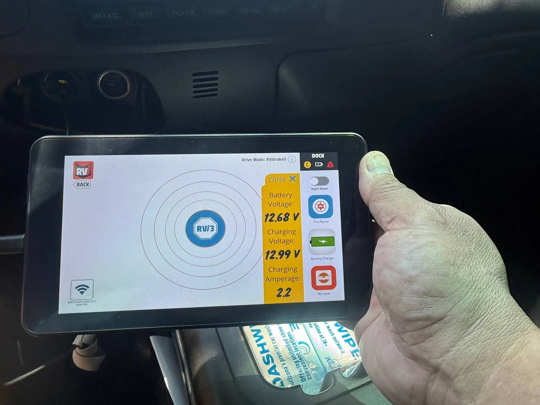

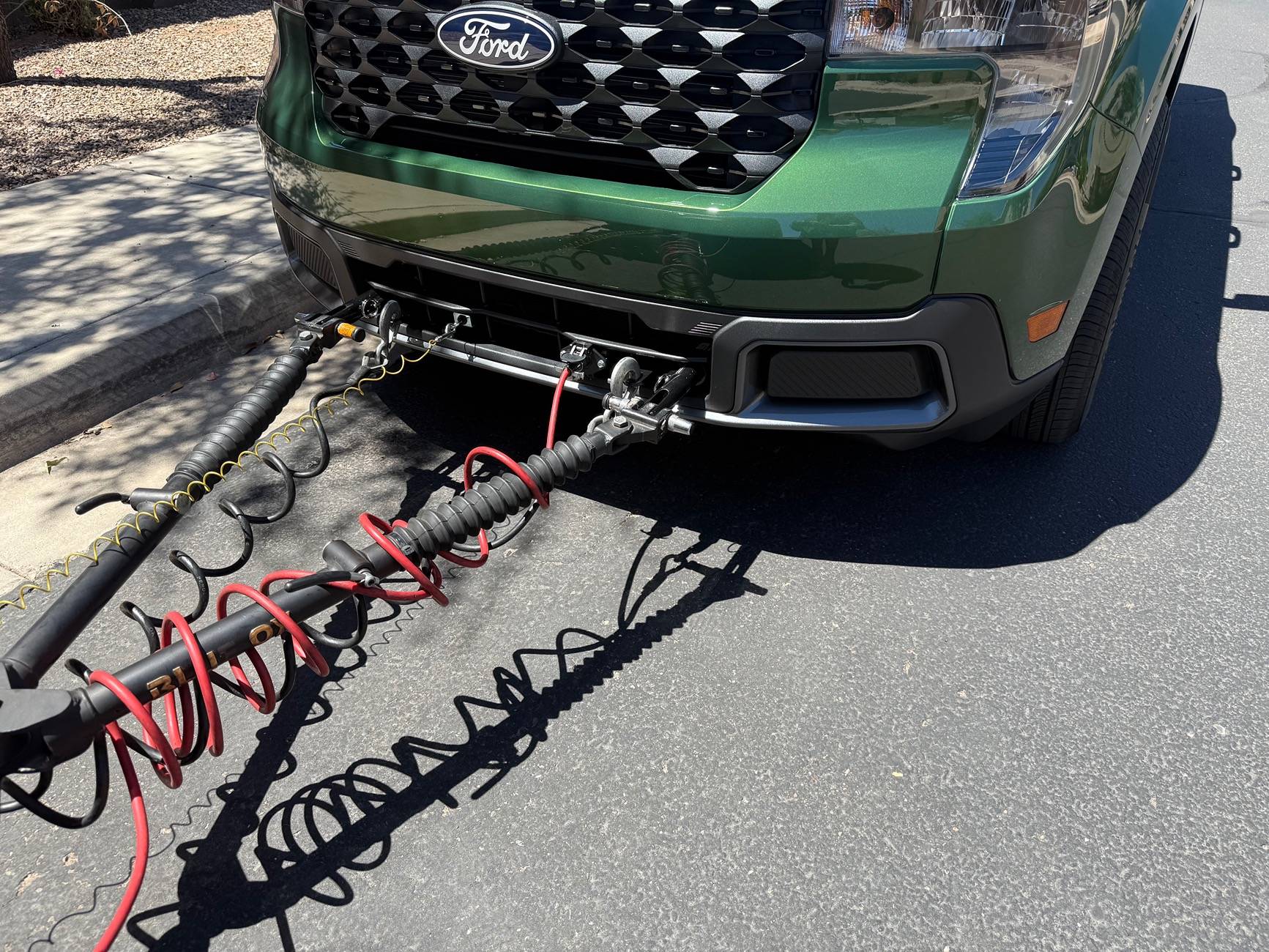

Test tow today, all is well. For those using the RVI brake 3 for your auxiliary brake make sure your settings are set for active I tested with pressure set to 5psi and 10psi, I left it at 10psi. Charging was working as normal

Looks great Vince happy trails 👍

I have my RVIbrake 3 obviously set to "Active" mode and sensitivity to 10psi. 10psi has negligible effect and 5psi zero. Leaving mine at 10 since I'm sure it will apply toad brakes hard enough in a 'panic' stop, which is most important.
