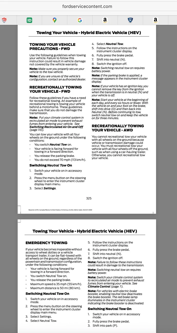

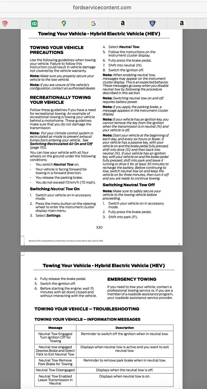

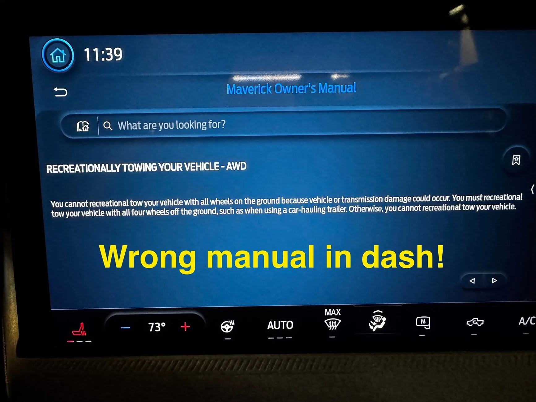

By now you've probably seen this. My in-dash manual in the 2025 AWD Hybrid XLT we bought a couple of weeks ago is for a 2024, and when I log into my account on Ford.com I find 3 manuals associated with my VIN - 1 pdf and 2 HTML. These 2 pages came from one of those HTMLs... so the correct manual finally.

Robert,
See here for the HTML version of the 2025 Maverick owners manual that I'm referencing, which I would think is the most current version:
Towing Your Vehicle - Hybrid Electric Vehicle (HEV) - Recreationally Towing Your Vehicle
The last item is the 15 minute wait.
I do see that it does not match what the PDF version (printed version 2) you posted states, so there's a discrepancy between the HTML version and the printed version on Ford's site.
ETA - in small print, the PDF version appears to have an October 2024 date stamp on it:
" Maverick (CFE) Canada/Mexico/United States of America, enUSA, Edition date: 202410, DOM "​

The manual you are quoting is the first edition that was in error. Go to Ford dot com and get the second d version, that verifies the 2025 AWD is flat-towable.

Yes, I went through serious trauma when my dash screen popped up with a warning that I could not "Neutral Tow." A trip back to my dealer and a great conversation with the sales manager walking me through a YouTube video he'd found showing us how to do the settings. Probably by someone here! LOL
Funny, though, that even the sales manager had not been able to find the right owners manual with the page of instructions for Neutral Tow setup... but I have since found it among 3 owners manuals tied to my 2025's VIN on my Ford website login.
