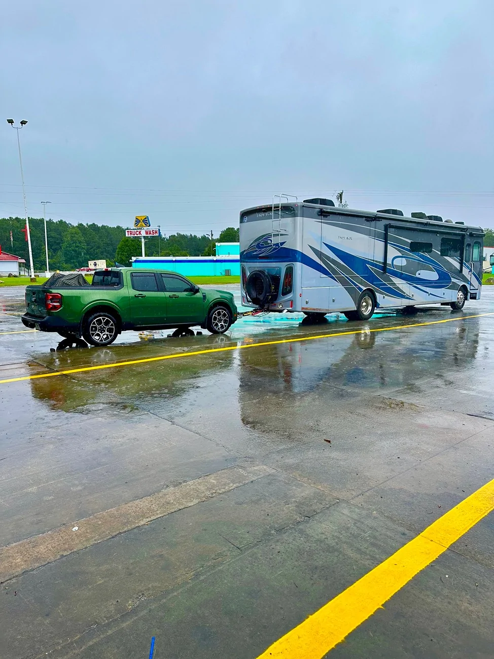

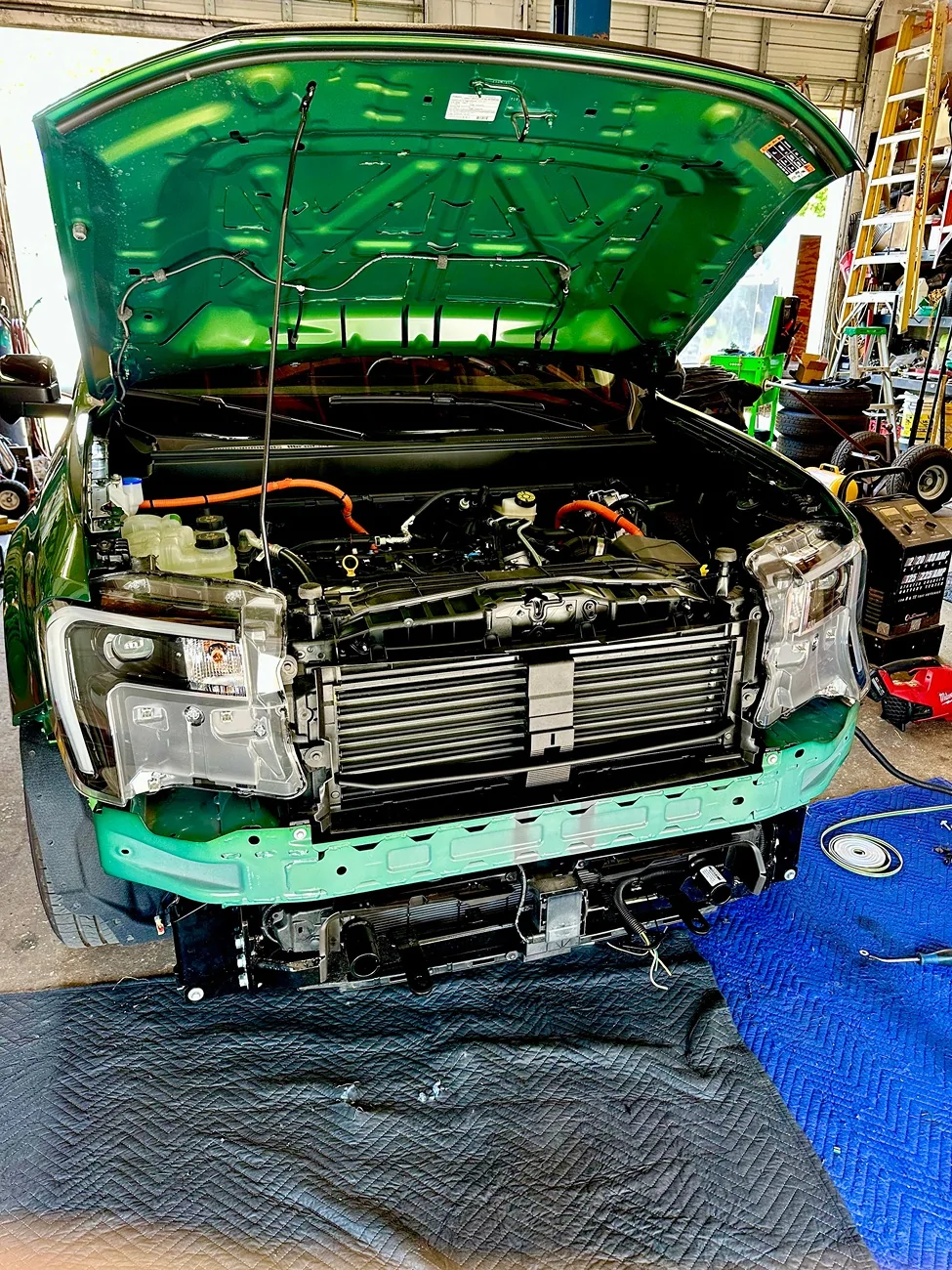

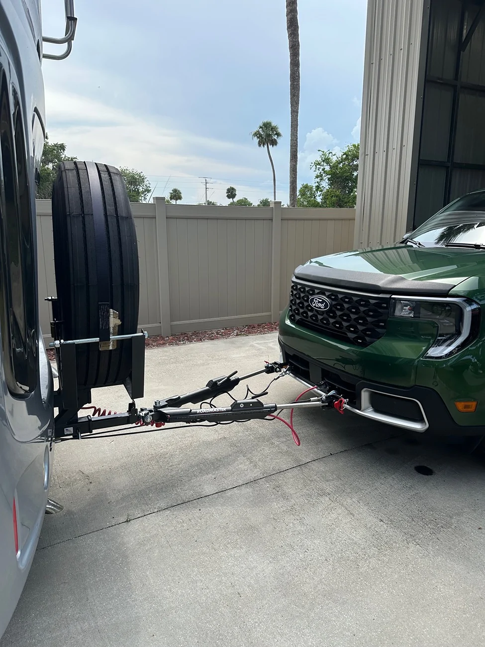

I have a 2025 Maverick AWD Hybrid that I’ve flat towed four wheels down nearly 7,000 mile without any issues I use a RoadMaster Base Plate and a RoadMaster NightHawk Towbar it’s been a great experience

I have a 2025 Maverick AWD Hybrid I have flat towed it four wheels down behind my motorhome almost 7,000 miles so far with no issues - it probably the best toad I’ve owned and I’ve had more than a few
