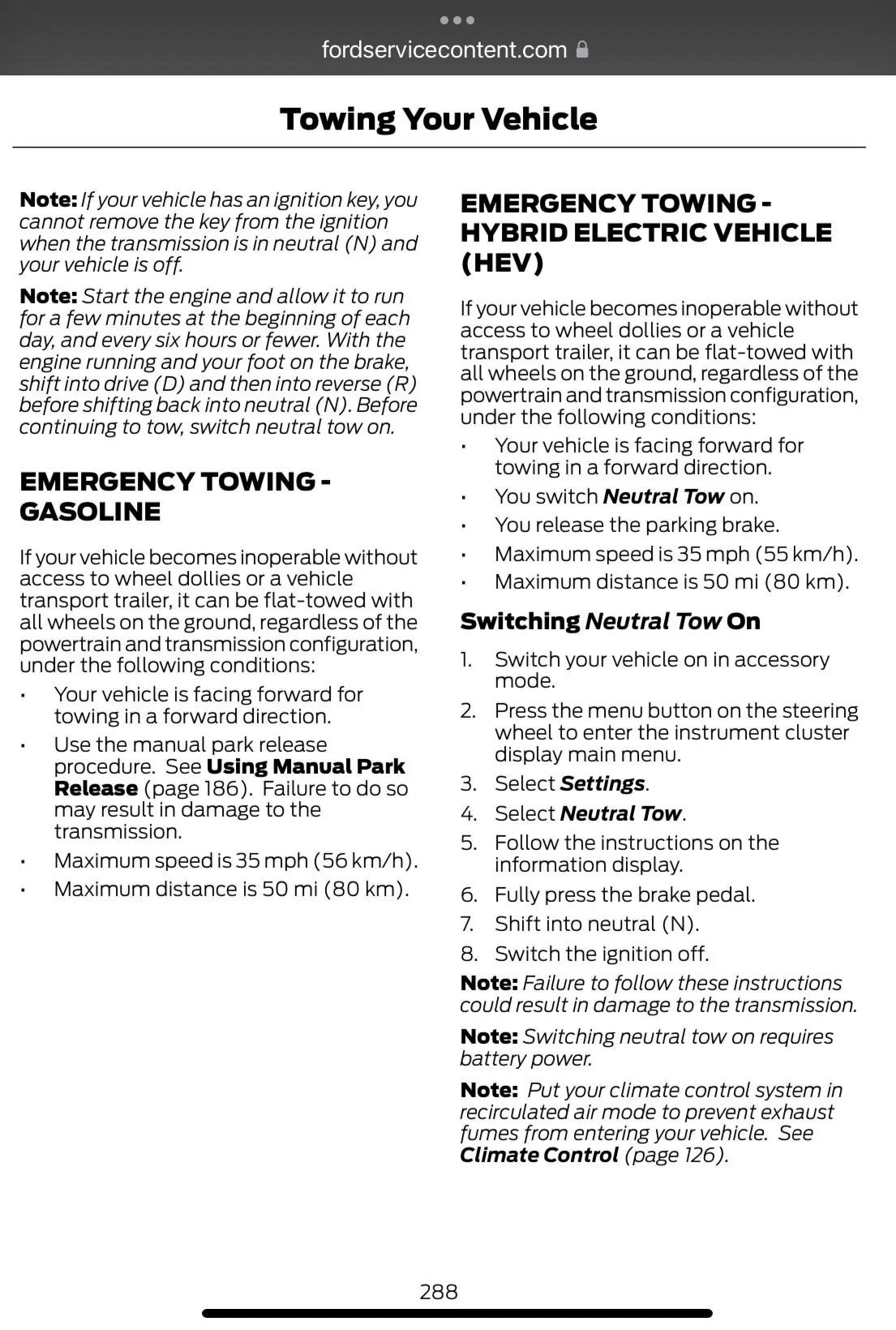

In the manual it definitely gives the ok to flat tow the hybrid up to 70mph with no time constraints however it also gives directions for ‘emergency flat towing’ with what seems to be the same procedure, and it is severely limited. What am I missing?
Probably the emergency flat towing is for the EB engine.

No.
Post edited, check owners manual for complete instructions.

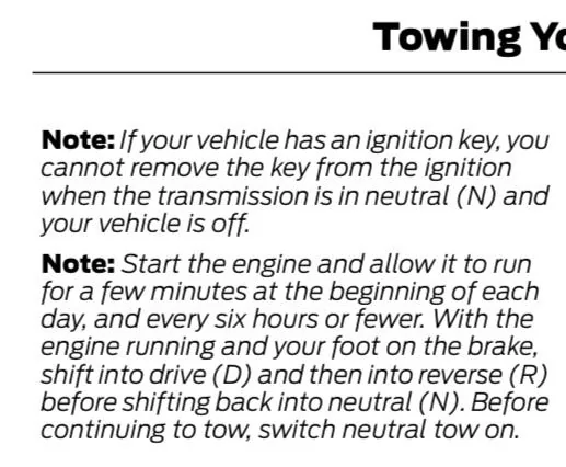

You are missing the complete instructions of how to recreational tow instructions on pg 288 that deals with time constraints of six hours and how to cycle through the gears, see
below. I suggest you delete your comment so no one damages their hybrid by following them.
perhaps it may have to do with the lack of a flat towing baseplate being installed, so a safety concern. Flat towing an EB engine is on the same page, note no neutral tow option.

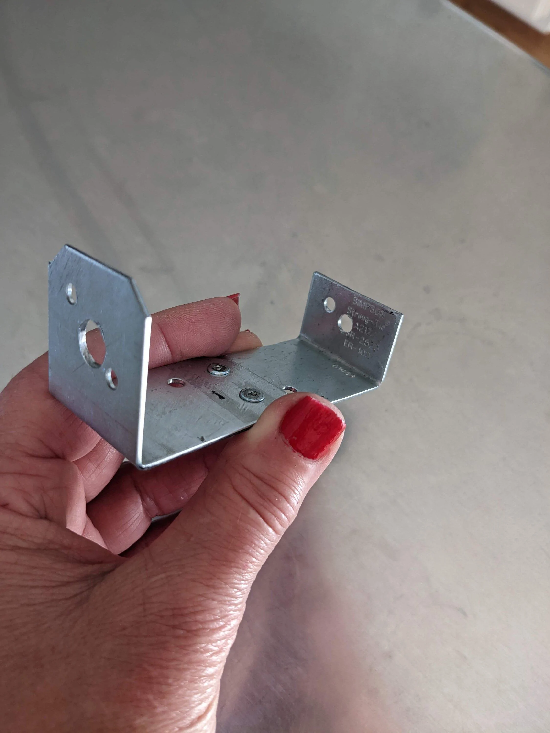

@BDennis,
I wasn't able to find a ready made solution to attaching the cable so I made this out of 2 Strongtite A21Z reinforcing angles found at Home depot. I cut the one end and drilled both to make the right size holes and riveted them together. I also painted it black. I'll attach it to the little tab near the center of the base plate with a bolt and nylock nut. It will rest on the top of the base plate and stick out to the front of the grill opening. This is where the Ready Brake cable connector will be attached.
Maybe you or @Chicago Mike can help with where to attach the Ready Stop red ratchet box. I still haven't got that one figured out.

That is a simple and elegant solution as I can see that vertical predrilled upright tab dead center on the baseplate. No rivet gun here but I could take something slightly thicker, bend it in a vise to achieve the same affect. The other option is to do what you did but use two bolts and nuts as long as they cleared the 1.5” section of the baseplate. I like that you made it long enough to give the cable more room to curve forward.
I’ll post a pic where my ReadyBrake breakaway red box is installed.
